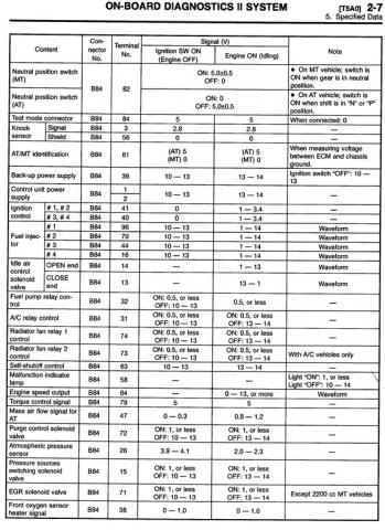

wtdash Posted October 9, 2012 Share Posted October 9, 2012 ECU's are the same for manual and auto 'til '99 or '00, I believe. I know my '98 Forester's was. There is AT/MT tranmssion ID pin, which tells the ECU if a TCU/TCM is connected....but no wiring changes are needed when doing the swap. See attached. Link to comment Share on other sites More sharing options...
