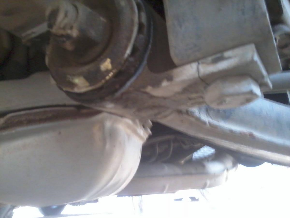

ryot1 Posted August 20, 2013 Author Share Posted August 20, 2013 What do you mean breaking? Squirting all the juice out? Yours are probably liquid filled for less vibrations. Those break all the time. Just get some off a 04-07 STI. You shouldnt have a problem with those. no they sheer off right after the bolt to the subframe and right before the o where the rubber piece and nut go to hold it to the a arm ....basically that flat piece that the bolt gos thru keeps sheering off on both sides ...its happend three times ... Link to comment Share on other sites More sharing options...

ryot1 Posted August 30, 2013 Author Share Posted August 30, 2013 see the crack well its completly sheered off right there on both sides basically that keeps happening any solutions? Link to comment Share on other sites More sharing options...
JacksonRally Posted September 2, 2013 Share Posted September 2, 2013 Very strange. We've never had one break, even on the rally car where we break wheels, struts and lower control arms. I would try running the factory bolt through there. You will obviously need the proper nut too. The factory bolt is a flange head to disperse the clamping force more evenly on the large slotted hole. Or you can retain whatever bolt it is you are using and run a large diameter and thick washer. My guess is that the mating surface of that bolt is barely larger than the slotted hole, so it is trying to work its way into the hole and the only option it has is to open the hole. This will result in it cracking at the weakest point. Try it and see what happens. Link to comment Share on other sites More sharing options...
ryot1 Posted September 2, 2013 Author Share Posted September 2, 2013 Very strange. We've never had one break, even on the rally car where we break wheels, struts and lower control arms. I would try running the factory bolt through there. You will obviously need the proper nut too. The factory bolt is a flange head to disperse the clamping force more evenly on the large slotted hole. Or you can retain whatever bolt it is you are using and run a large diameter and thick washer. My guess is that the mating surface of that bolt is barely larger than the slotted hole, so it is trying to work its way into the hole and the only option it has is to open the hole. This will result in it cracking at the weakest point. Try it and see what happens. thanks i will try ...like i said this is the third one and it hasent happend to any one else yet ...soo im stumped too Link to comment Share on other sites More sharing options...
bratman18 Posted September 2, 2013 Share Posted September 2, 2013 Or even just try a large surfaced washer to disperse the load better. Link to comment Share on other sites More sharing options...
ryot1 Posted September 3, 2013 Author Share Posted September 3, 2013 thanks you guys ill try and let you know what happens.... Link to comment Share on other sites More sharing options...
