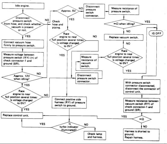

TOsborn Posted October 24, 2012 Author Share Posted October 24, 2012 Well, checked out a service manual, and found this flowchart (which I figured I'd post here in case it can also help anyone else). Where is the manifold pressure switch on located on a ea82 intake? Link to comment Share on other sites More sharing options...
naru Posted October 24, 2012 Share Posted October 24, 2012 Pretty sure it is remotely located at the RH shock tower. Link to comment Share on other sites More sharing options...
Gloyale Posted October 24, 2012 Share Posted October 24, 2012 Likely the vac line to it is disconnected. so the switch never trips.... "fixed value" It's on the passenger side strut tower. Link to comment Share on other sites More sharing options...
