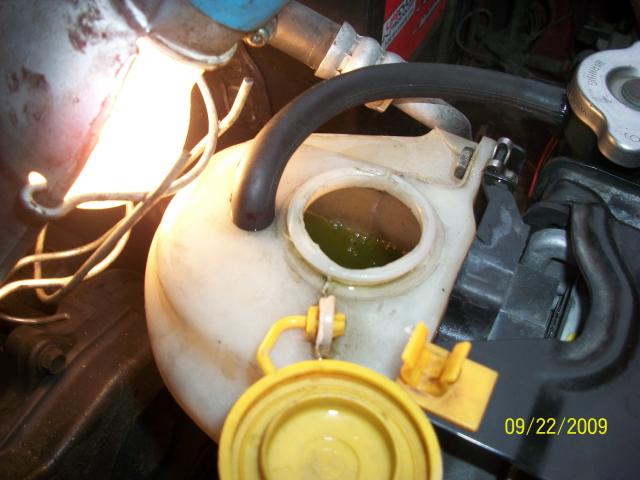

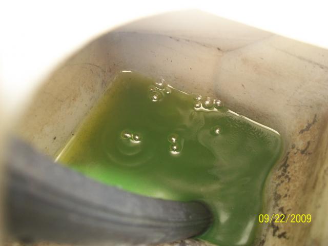

darsdoug Posted December 16, 2012 Share Posted December 16, 2012 Heater/defroster is only blowing cold air until I drop it down into a lower gear and get the RPM's up above 3500 or higher. I get normal hot air coming through the duct's then. I stopped and popped the hood while in park at an idle and looked in the coolant tank and low and behold I see air bubbles coming up at about the same rate as a goldfish aquarium. Quote Link to comment Share on other sites More sharing options...
lmdew Posted December 16, 2012 Share Posted December 16, 2012 Sounds like headgaskets. Let it cool, Jack the front as high as you can or put it on a hill. Fill the radiator and overflow bottle. Start the car and burp the coolant by squeezing the upper radiator hose until the bubbles stop coming out and then put the radiator cap back on. Now if you blow coolant out of the overflow bottle you most likely have a HG leaking. You can check it with a chemical tester as well. NAPA has them if you want to do it yourself. Quote Link to comment Share on other sites More sharing options...
Rooster2 Posted December 16, 2012 Share Posted December 16, 2012 +1 on head gasket trouble. I had the same trouble last Fall. Once my temp gauge shot up to hot, I pulled off the street, shut off the motor, opened the hood to look for bubbles in the over flow tank. Sure enough it was bubbling like an aerator in an aquarium. The bubbles is/are exhaust gas blowing by the bad head gasket to enter the cooling system. The water pump can't pump an air bubble, so the heater/defroster reacts by blowing cold air. Don't let your motor over heat, or you will ruin the motor. Quote Link to comment Share on other sites More sharing options...
