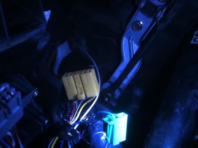

Fairtax4me Posted December 28, 2012 Author Share Posted December 28, 2012 (edited) Injectors have not been swapped. Though I suppose I could try my spare set, I don't think anything is wrong with the current ones. Looking at pictures of the SSM1 plug I remembered seeing a similar plug under the dash of my car. Sure enough there's a yellow 9 pin plug with 4 wires in the right places. I'm trying to figure out if the wires go to the right places on the ECU, but the I/O pinouts I can find for the ECU don't show anything about the SSM plug. Presslab thanks a ton for the links. I've been to tinkering with the idea for a long time to hook up a laptop in the car, but haven't found the right resources and info to do it. I'm looking forward to getting this put together now. Edited December 28, 2012 by Fairtax4me Link to comment Share on other sites More sharing options...
