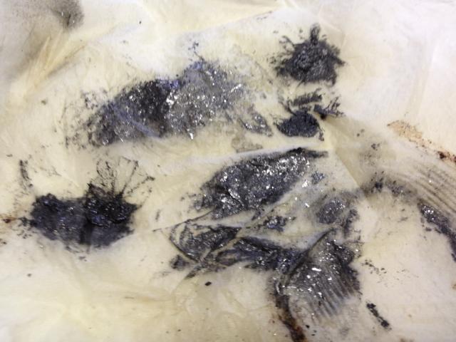

CNY_Dave Posted January 5, 2013 Author Share Posted January 5, 2013 I've changed out the front fluid for lucas with 50% lucas additive, no change in the noise. Took the crud off the magnet, the flakes here are incredibly thin and might just be tiny particles held together because they are magnetized, no solid pieces at all. Link to comment Share on other sites More sharing options...
1 Lucky Texan Posted January 6, 2013 Share Posted January 6, 2013 I've changed out the front fluid for lucas with 50% lucas additive, no change in the noise. Took the crud off the magnet, the flakes here are incredibly thin and might just be tiny particles held together because they are magnetized, no solid pieces at all. assuming the total mass in that pic is 1/4 - 1/2 teaspoon or so, it fairly well matches the stuff I've wiped off the diff magnets on my cars. FWIW Link to comment Share on other sites More sharing options...
