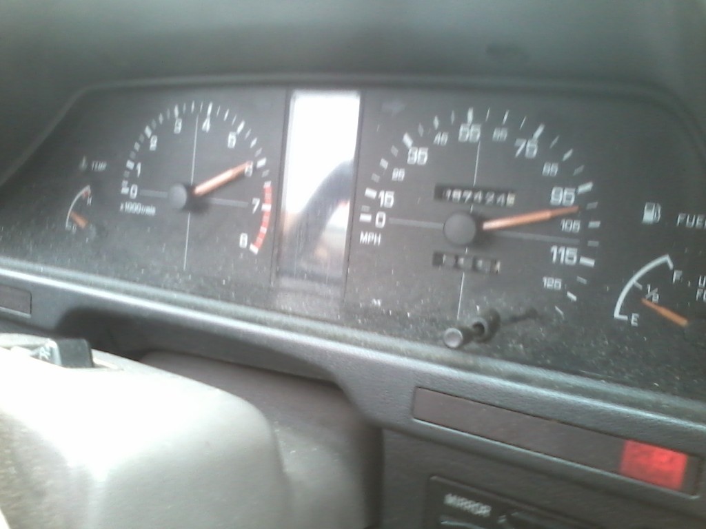

MR_Loyale Posted February 14, 2013 Share Posted February 14, 2013 These cars don't scoff at running high RPMS for extended periods of time at all. Only thing I can say is keep up with your timing belt replacements. If anything is going to go from running high rpms for awhile, it's one of your timing belts if they haven't been replaced and are old and worn. Though, to re-assure you, our Loyale was driven regularly on the highway for over an hour commute DAILY for 2 years. 65 mph is a comfortable speed (you'll be just under 4k at 65). As I said in my first post here, click my screen-name and you'll see a picture of the Loyale breaking 100 mph But really, you don't need to worry about driving 65 mph on the highway. You can even cruise at 70 for awhile if you wanted to. It's nothing to worry about. I remember when we first got the Loyale, I had the same reservations about bringing it up to speed you did haha The ONLY thing that isn't good about the engine running so fast at those relatively low speeds is gas mileage, but even that doesn't really get too bad. I remember when we took the Loyale to Canada (10 hour drive. That's 10 hours of 4,000 rpms by the way) we got on average 24 mpg. I must not be doing it right. I clicked your screen name and couldn't find the picture of the 100 mph Loyale. You peaked my interest with a 100mph Loyale, but I cannot find it. 1 Link to comment Share on other sites More sharing options...

l75eya Posted March 3, 2013 Share Posted March 3, 2013 I must not be doing it right. I clicked your screen name and couldn't find the picture of the 100 mph Loyale. You peaked my interest with a 100mph Loyale, but I cannot find it. Ah, because of the forum change. Here ya go. Link to comment Share on other sites More sharing options...
l75eya Posted March 3, 2013 Share Posted March 3, 2013 Tofutti...A general Guess here......15mph down to 1st I think is about 4500? It"s been years since I"VE Drove A Auto Just to Gutless for me-Sorry! If I remember correctly hold {Stand On} gas Pedal down til it shifts-55-6000 is good for 25-30mph and a short movie Haha, I've tried flooring it as I shift into 1st to see if that works, but there's still a gut wrenching lurch when it engages, so I no longer ever shift into first gear with the loyale unless I'm practically stationary. And about 15mph @ 4500 in first, I know the 5 speed has different gear ratios, but I've hit 40 in 1st gear with the GL. It was screaming at about 6,500 rpms or so, but it did it. I learned first-hand what everybody means about the intakes on these engines. There is just not enough air going to the engine at and above about 5800 rpms. From 3.5k and up it pulls swell, but at soon as it passes that 5, it's just making a lot of noise but not really gaining any more speed noticeably. Link to comment Share on other sites More sharing options...
MR_Loyale Posted March 3, 2013 Share Posted March 3, 2013 Ah, because of the forum change. Here ya go. COOL! I love it! I see you too have the check engine light. Let me guess, 34 EGR Solenoid?? Link to comment Share on other sites More sharing options...
l75eya Posted March 3, 2013 Share Posted March 3, 2013 Ding Ding! lol bratman has a solenoid for me though, of unknown condition. Hope it works! Link to comment Share on other sites More sharing options...
