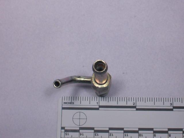

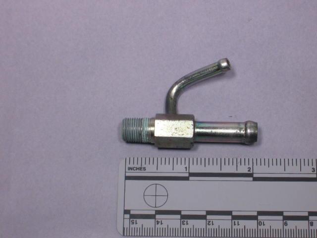

Something like this? I can't remember what this is off of. I think it was a feedback carb. The fitting attaches directly to the carb.
The Hitachi that was on my EA 82 had two fittings on the carb. Upper one was for the return line and had a restriction orifice pressed into it. The orifice diameter is 0,7mm. The fitting below the return was supply and was unrestricted.
Different carbs had separate ways to deal with back pressure and getting the excess fuel back to tank if that was required.

  On 4/6/2013 at 7:13 AM, silverback said:
Yep, that's it!!! One "arm" goes to the fuel filter, the other I have plugged, and the bottom of the "y" goes to the tank I think. I'll have to get a fresh look at it when I get over there... but either way the car is running and played around with the tuning yesterday. I've gotta get a spark plug and wire, one of the wires was arcing straight to the exterior of the plug. I forget what the phenomenon is called (if it even has a name). I thought the stumble was it STILL running lean but after tuning it and driving it, I knew right then and there I was getting plenty of fuel. So I just stood there and listened to it run, and followed the sound to the #3 cylinder and sure enough that's what was causing the miss. With the hitachi it was running brutally lean, almost certainly because of the ultra grey used for intake gaskets causing a giant vacuum leak. I'm sure it wasn't quite in time either. Hopefully this is all straightened out... the only thing it needs is a working choke. This one is wore plumb out!!!
