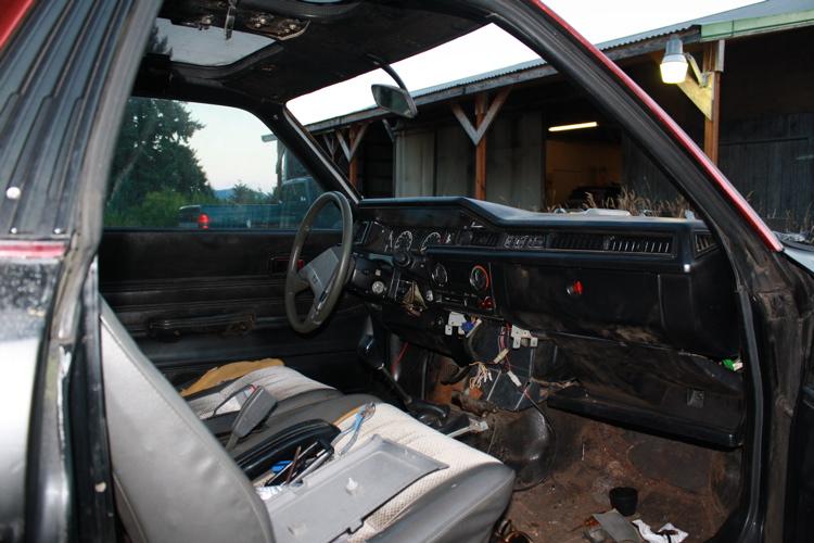

bendecker Posted June 5, 2013 Share Posted June 5, 2013 (edited) While it's out... what condition is your dash in? Mine has one of the old coverlay caps on it, so it looks pretty good, but there is one crack right at the windshield that has developed. I've always been intrigued by the idea of pulling the dash and fiberglassing over it. There's a pretty cool thread on a BMW board about dash repair. Unfortunately, the great pics that used to be on it have been pulled. The guy used a two part kit of SEM flexible plastic repair (part no. 39927) and the results were really good (again, they pulled the stinking pictures -- sigh...) http://www.bmw2002faq.com/articles.html/_/technical-articles/body-and-interior/dash-repair-r21 Here's another one where the guy used upholstery vinyl, contact cement, and heated it up to get around all the corners: Edited June 5, 2013 by bendecker Link to comment Share on other sites More sharing options...
Godsmulligan Posted June 6, 2013 Author Share Posted June 6, 2013 Nice, mine only had 2, 1/2 inch cracks. fixed those today with some plastic epoxy. I wouldn't recommend it the way I did it, but the dash is getting painted so it will only be noticeable to me. Link to comment Share on other sites More sharing options...

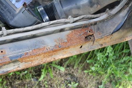

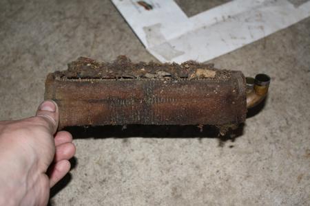

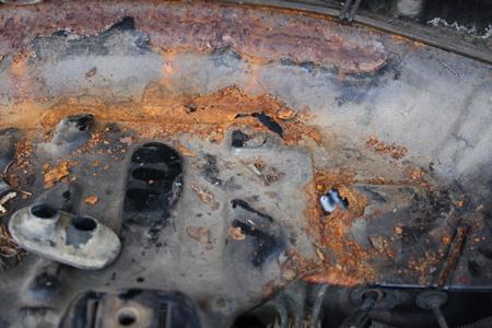

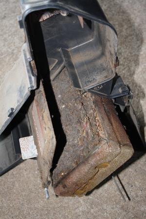

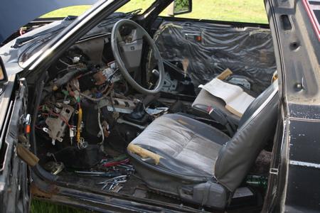

Godsmulligan Posted June 7, 2013 Author Share Posted June 7, 2013 (edited) Found nuts in the heater vent, not allowing the vent to open. That would explain why the heater wouldn't get warm. Oh, and this... more cancer to contend with hope to start putting it back together next week. Got almost everything cleaned and painted, just waiting for a new heater core and led dash lights. Edited June 7, 2013 by Godsmulligan Link to comment Share on other sites More sharing options...

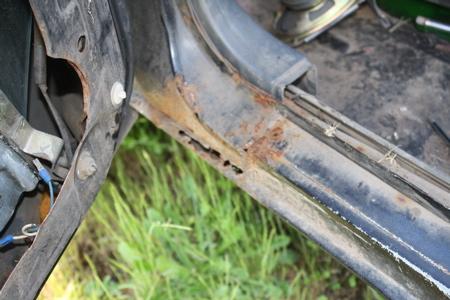

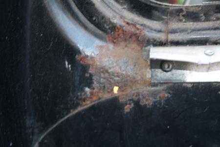

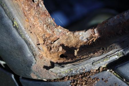

Godsmulligan Posted June 21, 2013 Author Share Posted June 21, 2013 (edited) I got some painting done this week, new heater core in, dash in and some misc. Next week is all about getting the inside put back together and getting the glass in. I need to get the tarp off this thing and back on the road, so I can go camping. Oh and I took care of 3 of the 5 rust problems pictured above... Edited June 21, 2013 by Godsmulligan Link to comment Share on other sites More sharing options...

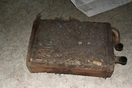

O.C.D. Posted June 21, 2013 Share Posted June 21, 2013 I was gonna say, that last set of pictures made me sad as that is a lot of structural rust. But, as you have said, "3 have been fixed". What did you end up buying for the core? Was it an OEM, aftermarket or used? Link to comment Share on other sites More sharing options...
Godsmulligan Posted June 22, 2013 Author Share Posted June 22, 2013 (edited) OEM 1 of 2 left in existence, I was told. $70 As far as rust goes, you should see the underside of the running boards. The wire wheel ate it's way through the metal as soon as I applied it. Edited June 22, 2013 by Godsmulligan Link to comment Share on other sites More sharing options...

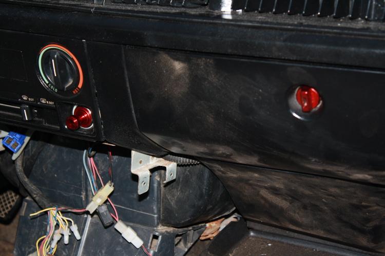

Godsmulligan Posted July 9, 2013 Author Share Posted July 9, 2013 Been a while since I've had time to work on the brat, but I've managed to get the heater back together along with all the vents. Spent the whole day painting today. Tomorrow I put it back together. I was going to take my door locks in today and get them re-keyed, because they took different keys, but when I went to leave I couldn't find my keys for the brat (cheaper to get one re-keyed to match the other). I did find my old GL Wagon key from back in the day. I thought it would be cool to get the locks keyed to match the old Subaru. I put the key in the lock, just to make sure it would fit. It did. Not only that, it turned. I tried the other lock. It worked on that one too. I now believe that my old Subaru key is the master key to all existing Subarus. 3 Link to comment Share on other sites More sharing options...

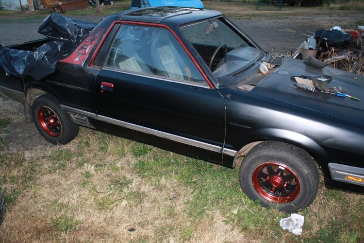

Godsmulligan Posted August 1, 2013 Author Share Posted August 1, 2013 Here are some quick pics. The car is really dusty. I'll get it all cleaned up when I finish. Link to comment Share on other sites More sharing options...
BratRod Posted August 1, 2013 Share Posted August 1, 2013 Mercy... that is dusty. Initially, I was scared by the title, but it's turning out pretty well. I like how you painted over the chrome. You may have inspired me to do that. How well did the dash turn out? It looks really good from the picture. Link to comment Share on other sites More sharing options...
Godsmulligan Posted August 1, 2013 Author Share Posted August 1, 2013 The dash turned out well. It's satin black same as the car. Used plasticote. It seemed to cover better than the vinyl paint. I did have a problem with the door panels remaining sticky as a reaction to the paint. Not sure If I accidentally painted them with regular Krylon. Underneath the dust it looks brand new. Link to comment Share on other sites More sharing options...

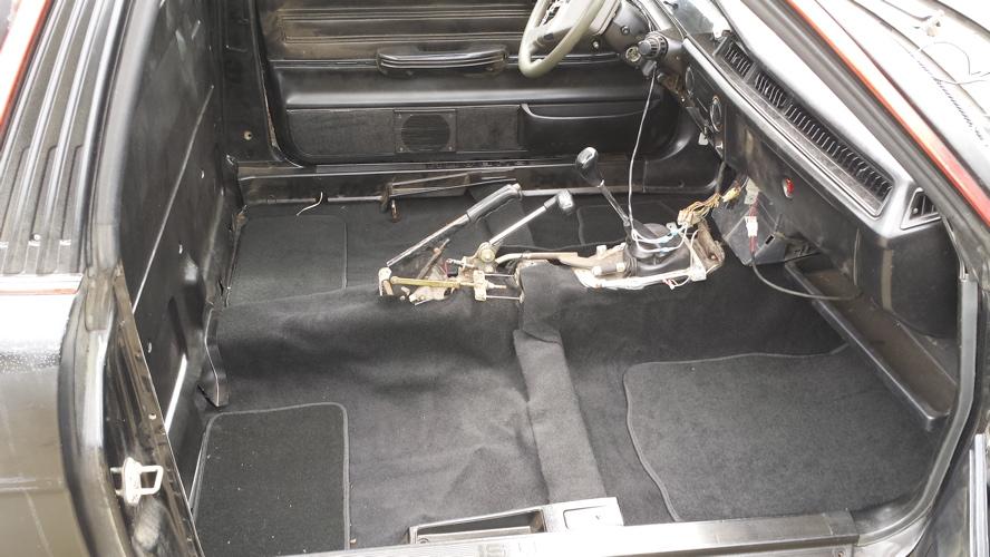

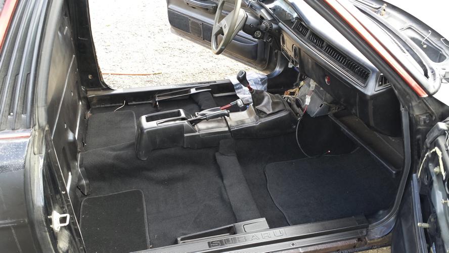

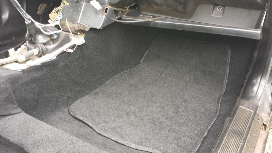

Godsmulligan Posted August 12, 2013 Author Share Posted August 12, 2013 (edited) Got the carpet in today, really pulls it together. Also installed the mp3 mod for the stereo http://www.ultimatesubaru.org/forum/topic/123124-any-interest-oem-ea-radio-ponderings/ Edited August 13, 2013 by Godsmulligan Link to comment Share on other sites More sharing options...

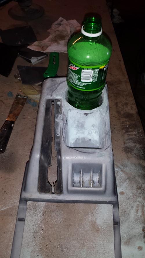

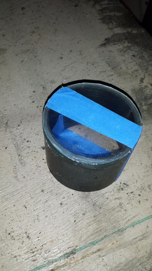

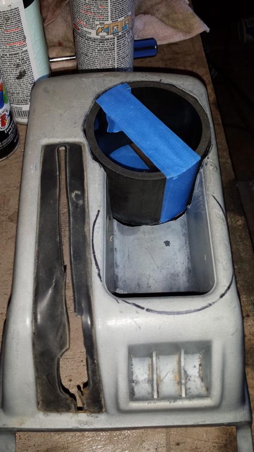

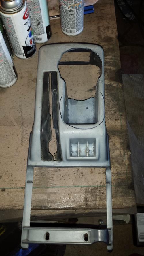

Godsmulligan Posted August 20, 2013 Author Share Posted August 20, 2013 (edited) Thanks, Mykeys Toy That Anodized red is turning out to be real junk. Not only does it flake off but it fades real qiuck. I'm hoping it's just the VHT and this other brand, I'm using now, will work better. I did get the seats, and windows back in no pictures of those yet, but i did swing by the junk yard for some parts today, including a new console to mod. That's plexiglass I glued on top I can't live without a cup holder. I was going to do 2 but decided not too. After working on it I think 2 would be easier to sand smooth. Edited August 20, 2013 by Godsmulligan Link to comment Share on other sites More sharing options...
O.C.D. Posted August 20, 2013 Share Posted August 20, 2013 3" PVC to the rescue!! Nice job molding that in. Link to comment Share on other sites More sharing options...

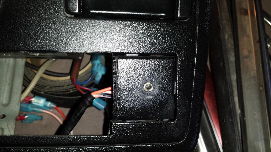

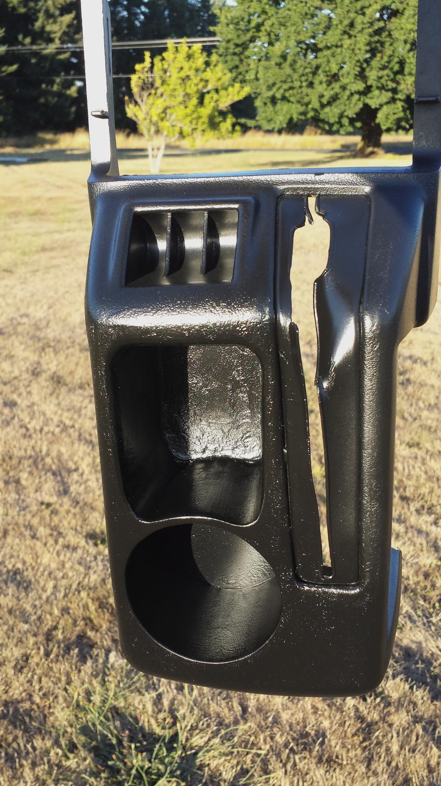

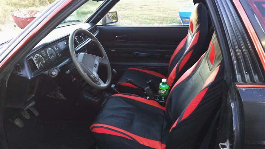

Godsmulligan Posted August 21, 2013 Author Share Posted August 21, 2013 (edited) Thanks O.C.D. Here's a couple photos of it finished I stippled the paint job then sanded it with 400 and repainted to give it that vinyl look here it is in the cab with the seats back in with seat covers from Walmart. They will do until I get actual racing seats. Other than that I pulled out a dent in the back today, got the window trim back in, painted the window cranks and finished and installed the adapter plate for the cubby under the stereo. Now I'm tired. Edited August 21, 2013 by Godsmulligan 1 Link to comment Share on other sites More sharing options...
