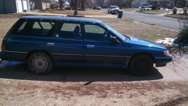

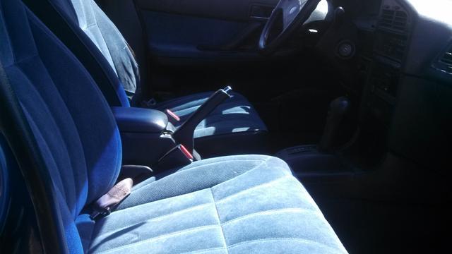

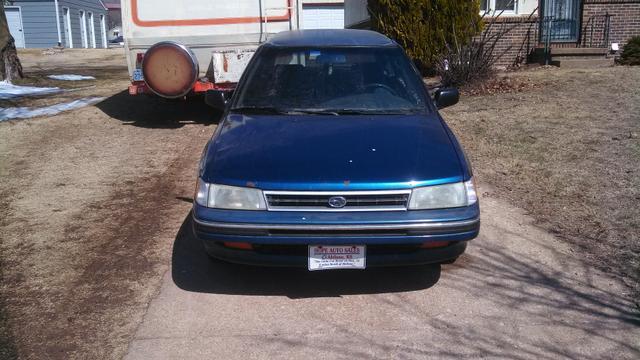

Wanting to learn more about a 91 Legacy wagon for sale nearby.    Car has 282,000 miles on the clock...Owner insists it runs great...fresh service done.   850 dollars to own.
What are the weak spots I need to look for on this car?   Engines solid or will I need to look for particulars with that amount of miles?  Has auto transmission....are those solid trannys or what?
Blue with some sun fading on roof, hood etc.....no major rust some spots where the paint has flaked off completely ...not a garage queen by any means but I don't need such a car...just a daily driver and lake mobile.
