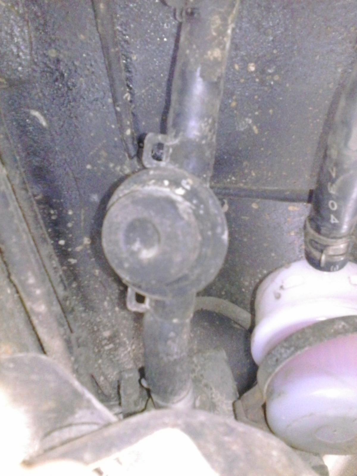

Lacyjs9 Posted May 4, 2013 Author Share Posted May 4, 2013 whats this Link to comment Share on other sites More sharing options...
TallonX Posted May 4, 2013 Share Posted May 4, 2013 That is a fuel pulse diaphragm, compensates for the pulses from the fuel pump. Link to comment Share on other sites More sharing options...
