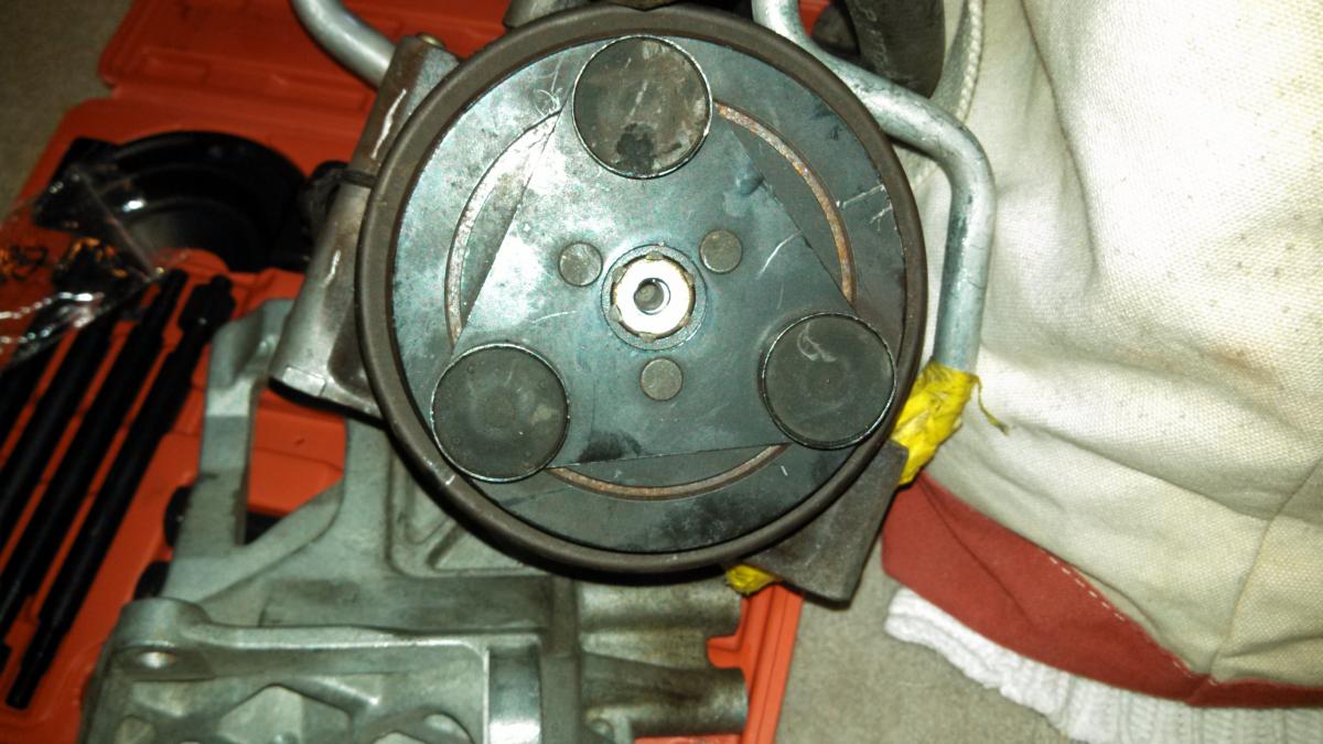

charm Posted June 2, 2013 Author Share Posted June 2, 2013 See the attached photo to see what I'm dealing with. It's very different then what the guy with the '06 Legacy was dealing with. I don't have any extra bolts to undo or snap rings that I can find. I bought a gear puller from Harbor Freight but I think it may just be bending the pulley. I am very open to suggestions on how to pull this apart. The issues are clearly mechanical, and getting worse day by day (today it started to make a whistling sound...that can't be good). With a new job coming up that requires a long drive, I'm getting close to spending the $1200- the shop wants for the repair. As you can imagine, that's the last thing I want to do. Link to comment Share on other sites More sharing options...
idosubaru Posted June 3, 2013 Share Posted June 3, 2013 that recessed center part looks like it could be an allen wrench, but it's not? does it have anything in there that looks like a fastener of some type? worst case you have a shop evacuate the refrigerant, install a used part, and charge it yourself. if you're super anal have a shop pull a vaccuum, but it's not at all necessary. annoying but that's worth saving $1,000 to most. or find a shop that will install a used compressor for you and just let them do it. 1 hour labor - $100 charge - $200? way better than $1,200 Link to comment Share on other sites More sharing options...
1 Lucky Texan Posted June 3, 2013 Share Posted June 3, 2013 I saw a youtube video where someone had to cut a slot in a weird fastener to use a large screwdriver to remove that center fastener. I guess some are assembled with unusual fasteners for some reason. Looks almost like a plastic piece will come out and maybe some Torx bit would work but????.... Link to comment Share on other sites More sharing options...
charm Posted June 3, 2013 Author Share Posted June 3, 2013 It's not an allen key. It looks like it's been pressed and the black steel has been pinched on the shiny steel. I tried searching for that video, I came up empty. Link to comment Share on other sites More sharing options...
1 Lucky Texan Posted June 3, 2013 Share Posted June 3, 2013 I tried searching for that video, I came up empty.it wasn't great, it was a GM or Nissan I think. I just mentioned it because the guy had to create a way to remove the bolt. Is the inside of that hole threaded? There are videos showing a puller that screws into a hole similar to that one in your pic. I dunno, hope you find an approach that works. Link to comment Share on other sites More sharing options...
