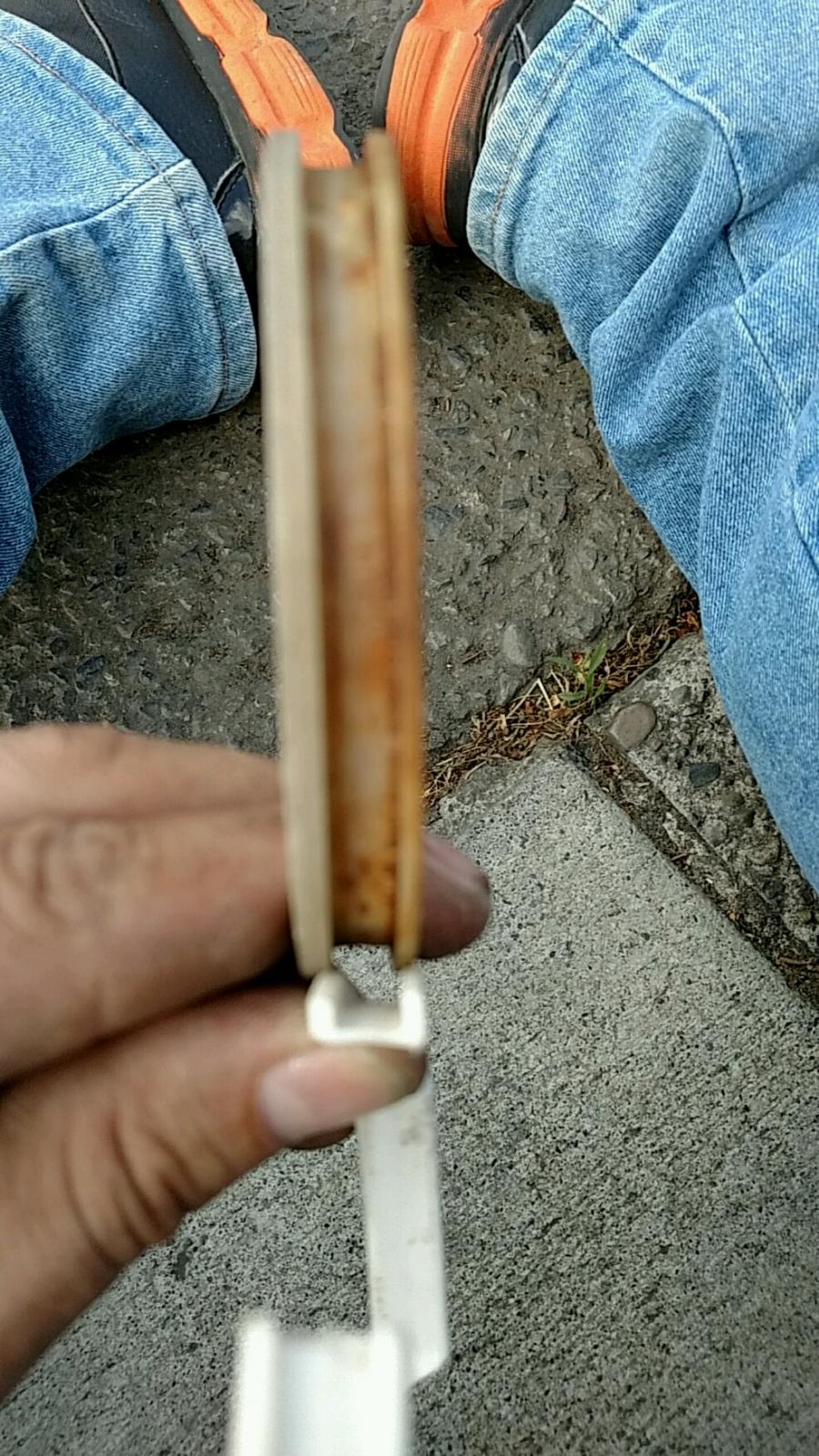

Checkerboard Comet Posted May 17, 2018 Share Posted May 17, 2018 (edited) I ordered 723146020, and they don't work. If you look at the pic, you will see my original one is a tad wider. The new one is smaller, ugh. Yes, it makes a difference. Edited May 17, 2018 by Checkerboard Comet Link to comment Share on other sites More sharing options...
DaveT Posted May 17, 2018 Share Posted May 17, 2018 I can try to locate the ones I have tonight. I could also print those now. Link to comment Share on other sites More sharing options...
Checkerboard Comet Posted May 18, 2018 Share Posted May 18, 2018 New printed ones would be great, the original ones are now really brittle from weather exposure anyway. Link to comment Share on other sites More sharing options...
