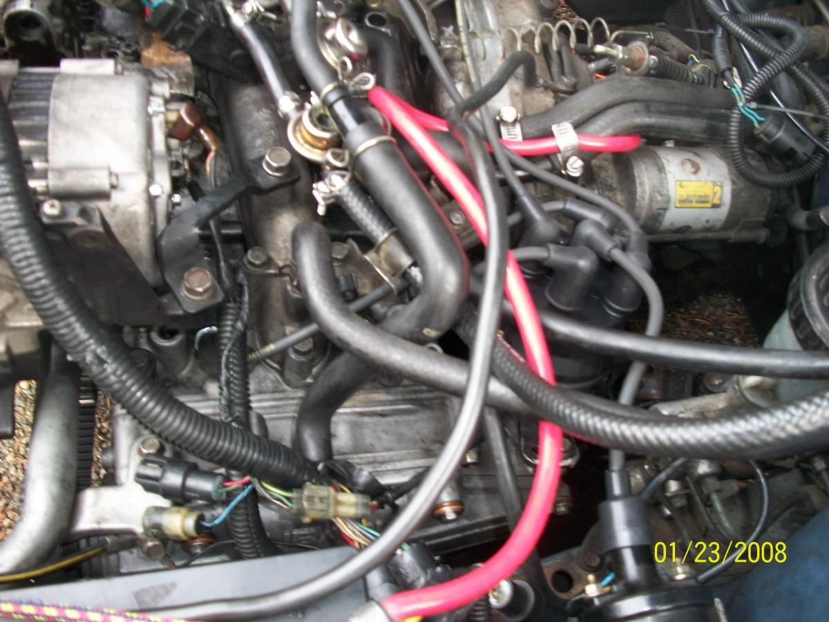

darsdoug Posted October 22, 2016 Author Share Posted October 22, 2016 Another afternoon lost in the vast corridors of thought. I had to take a step back and review my work by memory today but it appears to be paying off. Firing order 1324 and rotor turns counterclockwise. Cylinders 1 & 2 located front to back on passenger side and 3 & 4 are front to back on drivers side. Did I overlook being certain #1 was at TDC of it's compression stroke the last time I installed the distributor? even though I had the "0" lined up at the flywheel? (yes! that was one blunder I fixed today) Also, could the steel sheet metal screw I'd substituted to secure the rotor to the distributor shaft have been another mistake? (The original brass screw had been misplaced during my chaotic work, har har) At least it will start and run now but #2 cylinder is still a dead horse when I remove a plug wire. I even switched spark plugs and got the same result. Another poster told me a vacuum leak can in fact kill one cylinder. hmmm? Isn't the TBI "ea82" a single runner intake manifold? Link to comment Share on other sites More sharing options...
DaveT Posted October 22, 2016 Share Posted October 22, 2016 The air passage from the TB to the head is one round tube. The head splits the airflow between the 2 valves. I could see a vacuum leak throwing off 2 cylinders on one side more than the other 2. Link to comment Share on other sites More sharing options...
TomRhere Posted October 22, 2016 Share Posted October 22, 2016 (edited) You are calling the cylinders by the wrong number. As you look at the engine from the front, #3----#4 #1----#2 ---CP--- Firing order is 1-3-2-4 going CCW. Going by your picture, plug wires appear correct on the cap however. I have found it best,(for me), to have engine sitting at 20*BTDC (SPFI) (*8 for carbed) on #1 compression stroke, and drop disty in with rotor pointing at #1 tower on the cap. Puts the adjustment slots just about center for the bolts. And yes, a vacuum leak will mess with these engines some fierce if it is on the intake runner(s). Take a good look at #1 & #3 side intake runner, there is a vacuum port on it that feeds the Purge & EGR solenoids along with the heater controls. Very easy to knock it off one of the fittings, or even break fitting off one of the solenoids. Guilty as charged on that one myself. That engine ran like poo at idle. Edited October 22, 2016 by TomRhere Link to comment Share on other sites More sharing options...
darsdoug Posted October 22, 2016 Author Share Posted October 22, 2016 (edited) You are calling the cylinders by the wrong number. As you look at the engine from the front, #3----#4 #1----#2 ---CP--- Firing order is 1-3-2-4 going CCW. Going by your picture, plug wires appear correct on the cap however. I have found it best,(for me), to have engine sitting at 20*BTDC (SPFI) (*8 for carbed) on #1 compression stroke, and drop disty in with rotor pointing at #1 tower on the cap. Puts the adjustment slots just about center for the bolts. And yes, a vacuum leak will mess with these engines some fierce if it is on the intake runner(s). Take a good look at #1 & #3 side intake runner, there is a vacuum port on it that feeds the Purge & EGR solenoids along with the heater controls. Very easy to knock it off one of the fittings, or even break fitting off one of the solenoids. Guilty as charged on that one myself. That engine ran like poo at idle. Edited October 22, 2016 by darsdoug Link to comment Share on other sites More sharing options...
darsdoug Posted October 22, 2016 Author Share Posted October 22, 2016 (edited) You are calling the cylinders by the wrong number. As you look at the engine from the front, #3----#4 #1----#2 ---CP--- Firing order is 1-3-2-4 going CCW. Going by your picture, plug wires appear correct on the cap however. I have found it best,(for me), to have engine sitting at 20*BTDC (SPFI) (*8 for carbed) on #1 compression stroke, and drop disty in with rotor pointing at #1 tower on the cap. Puts the adjustment slots just about center for the bolts. And yes, a vacuum leak will mess with these engines some fierce if it is on the intake runner(s). Take a good look at #1 & #3 side intake runner, there is a vacuum port on it that feeds the Purge & EGR solenoids along with the heater controls. Very easy to knock it off one of the fittings, or even break fitting off one of the solenoids. Guilty as charged on that one myself. That engine ran like poo at idle. All this time and I just had the cylinders mixed up? (oh my god) Thanks Tom. Edited October 23, 2016 by darsdoug Link to comment Share on other sites More sharing options...
darsdoug Posted October 23, 2016 Author Share Posted October 23, 2016 (edited) You helped me out bigtime Tom. "Thanks again". Now I just need to determine why it's delivering such a rich fuel mixture and sometimes bucking under load at part throttle. There does seem to be a sweet spot at half throttle. I'll figure it out sooner or later. With help from the experienced people here anyhow. The rotor screw fell out this morning when I was sitting in traffic waiting at a stoplight. Edited October 23, 2016 by darsdoug 1 Link to comment Share on other sites More sharing options...
