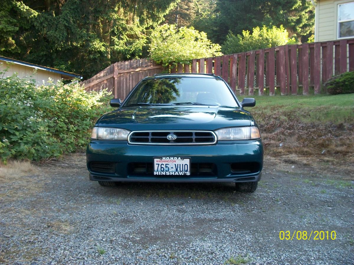

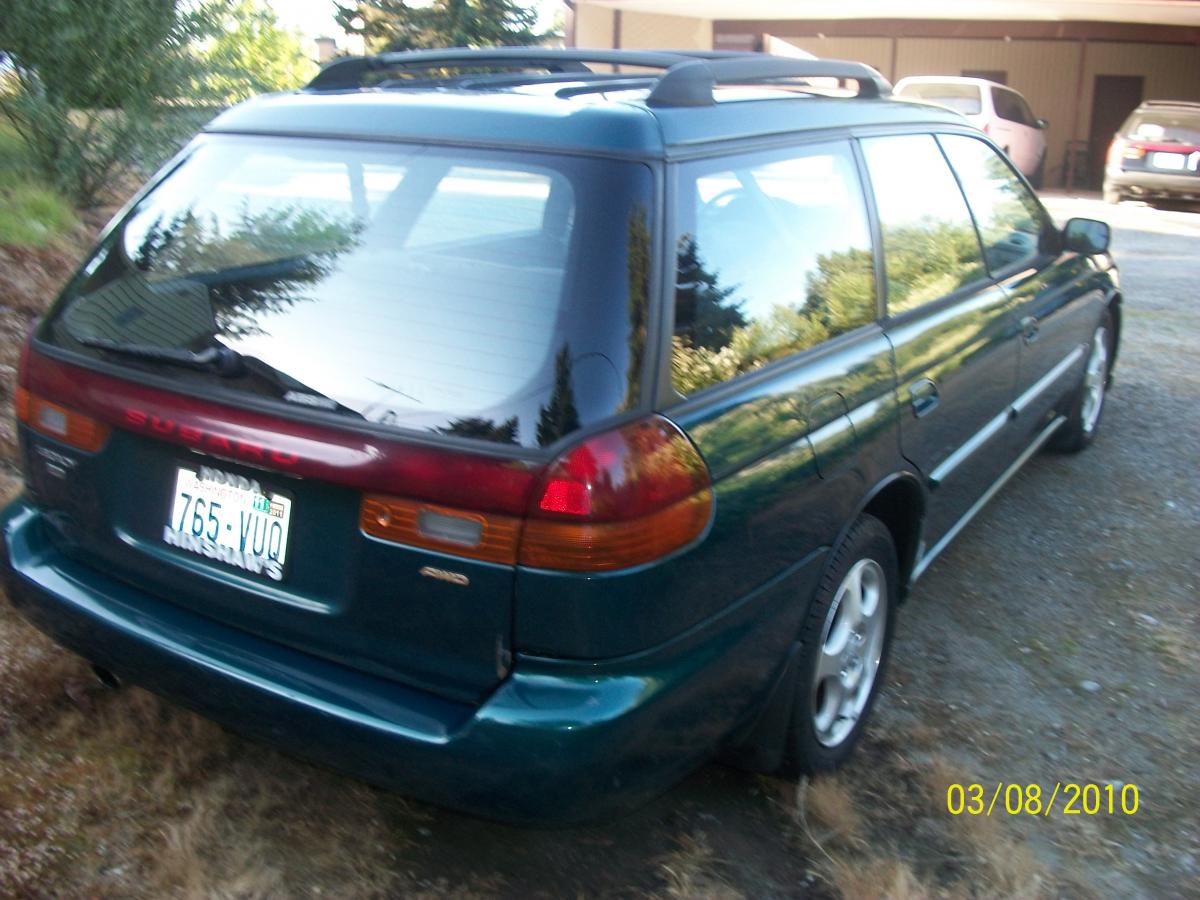

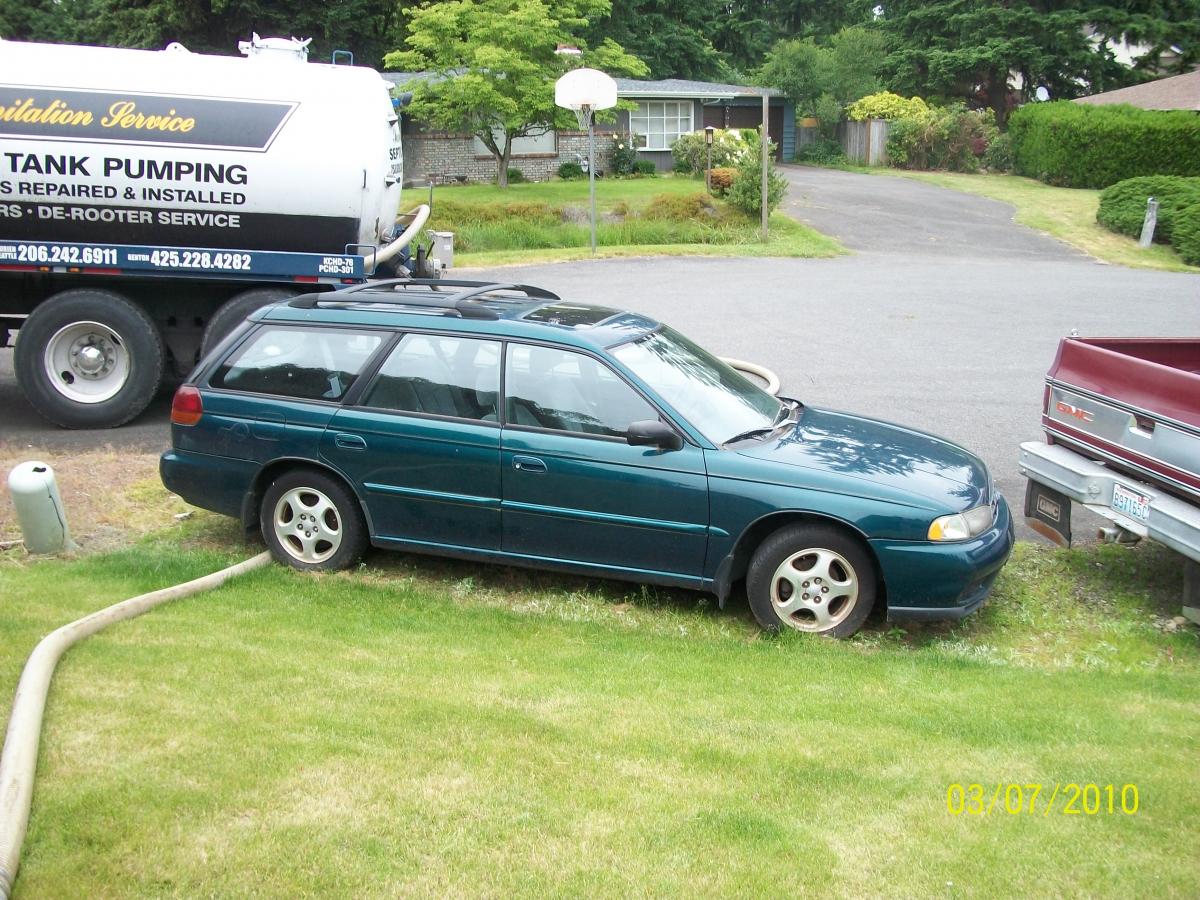

darsdoug Posted June 8, 2013 Share Posted June 8, 2013 It's a 1999 "L" with manf. date of 10/98 so it's the interference engine. It has a knock I haven't figured out yet and has been parked for a couple years, but for two hundred bucks cash I thought it was worth it. And with an odometer that says only 38 thousand miles!!! I figured I better get it. It starts and drives and stops too. Washington's 3 day trip permit almost cost as much as I paid for the car. Actually just thirty dollars for that. Even with the knock I still feel like a kid on Christmas morning. Its a good feeling. Link to comment Share on other sites More sharing options...

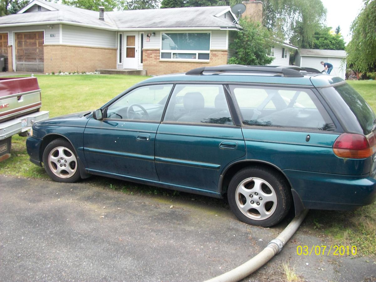

Rooster2 Posted June 9, 2013 Share Posted June 9, 2013 Had to laugh to see your car parked next to a "honey dipper" truck. Should you ever advertise on the internet in the future to sell the car, I wouldn't use that photo. Nice looking car, is the interior as nice as the exterior?? Link to comment Share on other sites More sharing options...

darsdoug Posted June 12, 2013 Author Share Posted June 12, 2013 Had to laugh to see your car parked next to a "honey dipper" truck. Should you ever advertise on the internet in the future to sell the car, I wouldn't use that photo. Nice looking car, is the interior as nice as the exterior?? Yes the interior is all there and has a nice sounding Pioneer am/fm cd player that works just fine. Link to comment Share on other sites More sharing options...

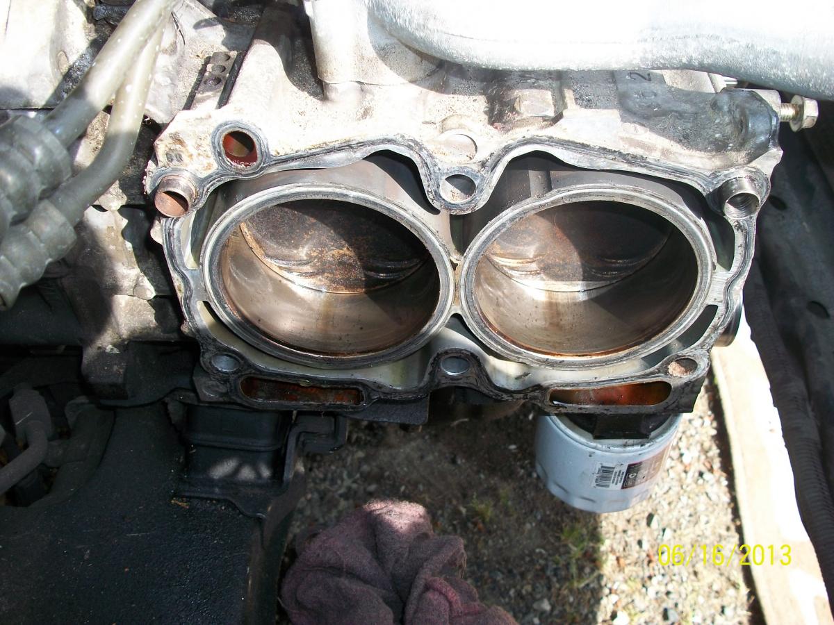

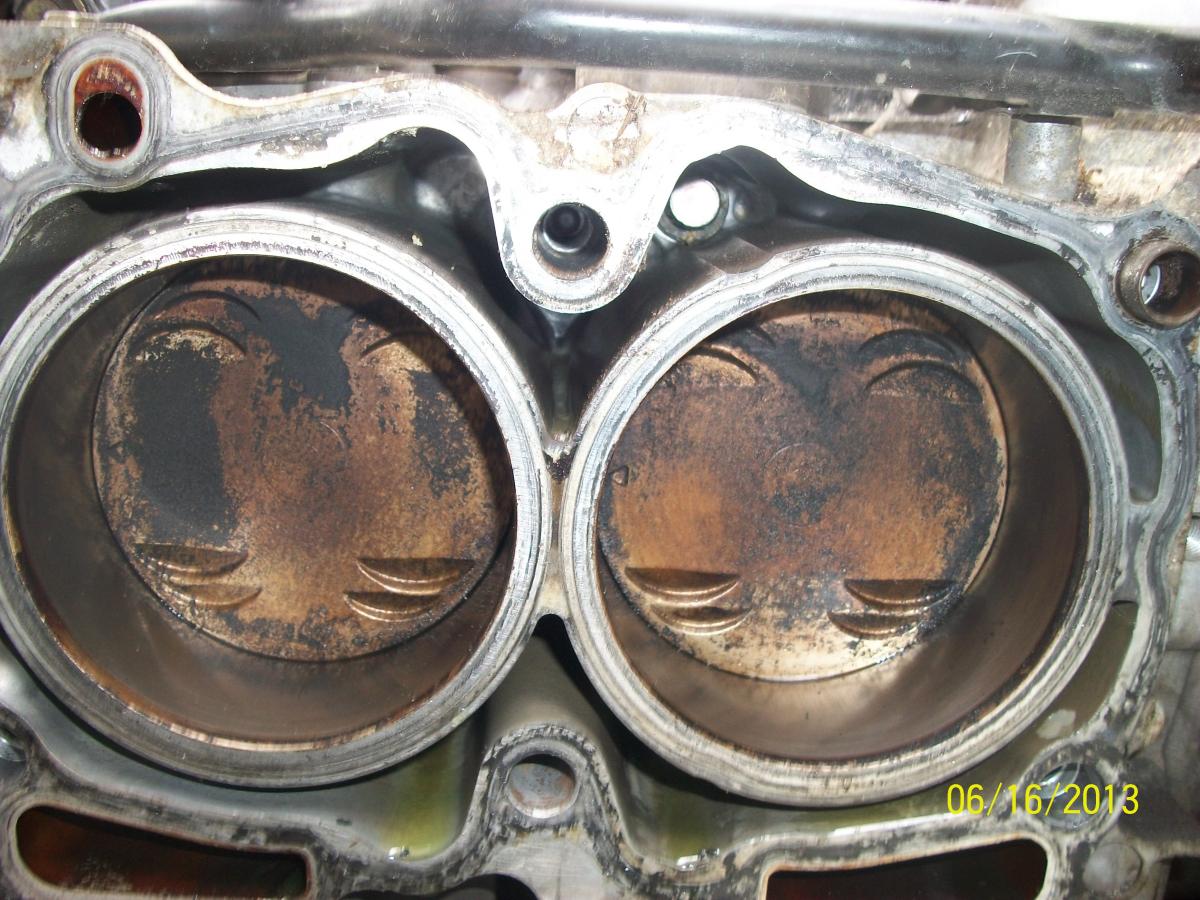

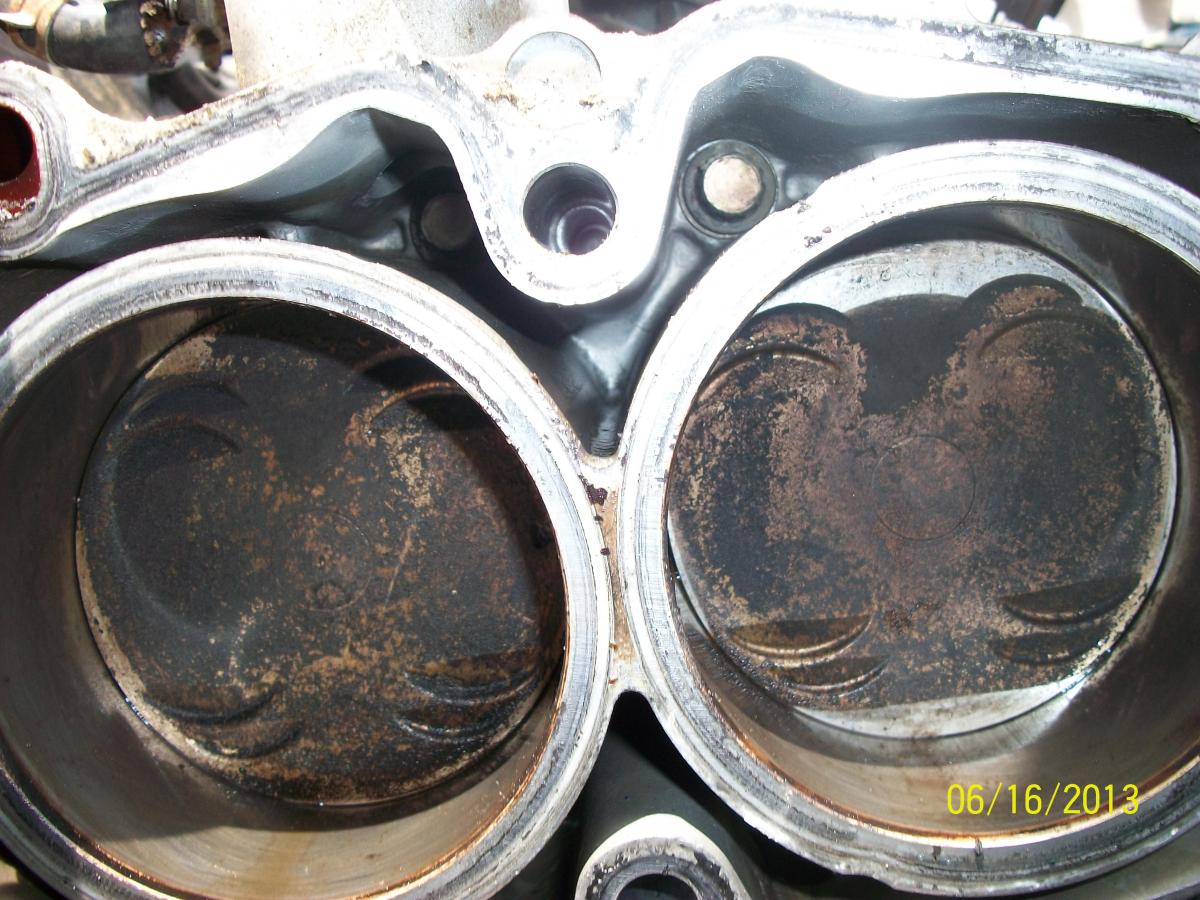

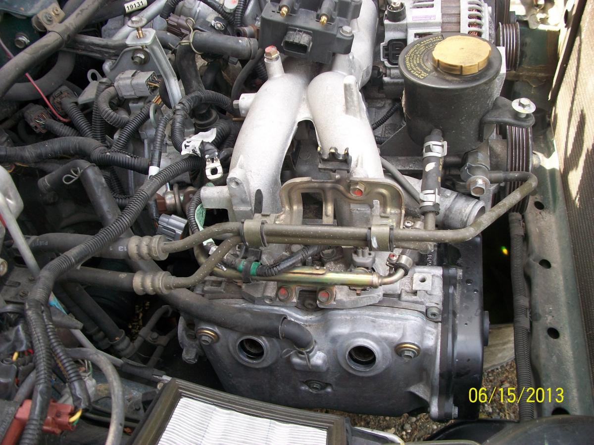

darsdoug Posted June 16, 2013 Author Share Posted June 16, 2013 I removed the passenger side head today and pushed down on #1 piston with my fingers. It went "clop" and slid down a quarter inch in its bore. I don't need to be a certified tech to know what that is. oh well. I'll be hunting for a shortblock shortly. Either that or lug it to a machine shop. Link to comment Share on other sites More sharing options...
darsdoug Posted June 16, 2013 Author Share Posted June 16, 2013 (edited) Here it is. Edited June 16, 2013 by darsdoug Link to comment Share on other sites More sharing options...
darsdoug Posted June 16, 2013 Author Share Posted June 16, 2013 Hmm? Link to comment Share on other sites More sharing options...
