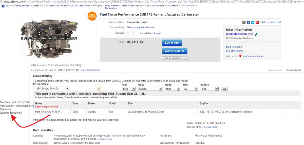

Bratmobile Posted June 26, 2013 Share Posted June 26, 2013 Mechanic recently looked at my Brat & recommended a Carburetor rebuild or replacement.The attached image from an ebay page shows a re manufactured carburetor that is saying it will fit an 86 Brat GL. Can anyone confirm this? Thanks in advance~ Bratmobile Quote Link to comment Share on other sites More sharing options...
turbosubarubrat Posted June 26, 2013 Share Posted June 26, 2013 yep thats the right one. if your going to spend that much go with a weber 32/36 and get the adaptor plate or just buy it in the kit. a lot of people say its well worth it because you get to get rid of a ton of the emission stuff so you gain power. Quote Link to comment Share on other sites More sharing options...
naru Posted June 26, 2013 Share Posted June 26, 2013 Mechanic recently looked at my Brat & recommended a Carburetor rebuild or replacement.The attached image from an ebay page shows a re manufactured carburetor that is saying it will fit an 86 Brat GL. Can anyone confirm this? Thanks in advance~ Bratmobile Pretty sure that is the WRONG one. I would not trust that listing at all.It does not even give the carb #. Listing also claims it fits fuel injected models! Complete BS,of course. SUB 176 is a Hitachi DCZ-328-xx rebuilt by National Carburetors. AFAIK,DCZ-328s are for EA-82 engines(won`t fit your EA-81) I believe the correct one would be a DCP-306-xx where the x`s represent different versions corresponding to auto/manual Califonia/Federal and year. There is no power to be gained by removing the "emission stuff'. No top end power gain from a weber conversion either.Mid range throttle response is better though. Why does your mechanic want to replace the carb? Often,this is a cop-out because they don`t know what else to say. Just saying. Like your paint job. Quote Link to comment Share on other sites More sharing options...
