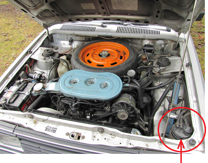

Bratmobile Posted July 8, 2013 Share Posted July 8, 2013 I've had a bunch of vacuum leaks recently fixed, and was wondering ( maybe a stupid question) what's the part I've got circled in the photo? Link to comment Share on other sites More sharing options...
TIMBERTIGER Posted July 8, 2013 Share Posted July 8, 2013 Charcoal canister. Has something to do with emissions. Junked all mine and deleted emissions. Link to comment Share on other sites More sharing options...

pressingonward Posted July 9, 2013 Share Posted July 9, 2013 The charcoal canister is essentially the vent for your gas tank. It absorbs gas vapors when the gas inside the tank expands (like on a hot day) and stores them. When you drive your car a vacuum line sucks the fuel vapor out of the charcoal and into the engine where it is burned. There is NO reason to remove the charcoal canister. It does not hurt your engine's performance in any way, and it captures raw fuel that would otherwise escape into the atmosphere. 2 Link to comment Share on other sites More sharing options...
Tsuru Posted July 9, 2013 Share Posted July 9, 2013 they can get old however and lose efficiency, becoming just a canister that has some old charcoal in it.. Absorption rates decline over the years to the point of uselessness, Yes, it is supposed to help keep fuel vapors out of the atmosphere, (when fairly new) and yes, it actually can (very marginally) help with (ever so slightly) increasing the mixture (useful during cold starts) but after a few years they are just pieces of equipment that no longer really work "as advertised". hence the environmental slam. Otherwise I concur, They aren't in any way a drag on the engine, and if it came with it, why not use it. I'm not a fan of deleting emissions items, but am appalled at the prices for replacing said items. Canisters are not cheap, starting at around $50 and going up from there for a plastic box with charcoal in it! and neither are cats. $65 and up to hundreds. granted, you only have to do it once, and compared with what we are all used to doing here, the labor is a non issue. My suggestion is that if you are going through the trouble to keep it, Why not replace it with a good fresh one? unless you just want it there for looks. or to smuggle things in... yup... heehee, timothy Link to comment Share on other sites More sharing options...

Gloyale Posted July 10, 2013 Share Posted July 10, 2013 When your tank vapor locks because you don't have a vent..... Or the vent line spews liquid gas on a hot day from expansion...... You will understand why it was there, and why you should leave it there. Link to comment Share on other sites More sharing options...

Gloyale Posted July 11, 2013 Share Posted July 11, 2013 Been driving it that way for 10 years with no problems. it would have to expand a ridiculous amount to push liquid fuel clear out of the line in the engine compartment. It expands almost 1.5% for every 10 degrees temp rise You probably don't drive with a full tank much. Fill up to the top on a HOT day and it WILL spew liquid. But I am probably wrong, and FUJI and all other car makers put the evap canisters in there for no reason at all, to increase production cost, and we are all stupid for having them in our cars and should all rip them out willy nilly because we don't know what they do. Link to comment Share on other sites More sharing options...
ferox Posted July 11, 2013 Share Posted July 11, 2013 Been driving it that way for 10 years with no problems. it would have to expand a ridiculous amount to push liquid fuel clear out of the line in the engine compartment. It has happened to me. When I Webered my wifes '84 in the summer I initially left the vent hose unconnected, with a full tank it started dumping a lot of gas out of the hose in the heat of the day. So much gas poured out and evaporated on my driveway, that I thought I got hit by a siphon-thief. I refilled and had the hood open when it started doing it again, so I figured it out pretty quickly, but I was surprised at how much gas pumped out. The elevation of the hose was greater than the elevation of the tank, so it didn't prime it just expanded. 1 Link to comment Share on other sites More sharing options...

Tsuru Posted July 12, 2013 Share Posted July 12, 2013 The canister is never supposed to even see raw fuel. It's designated purpose it to trap the VAPORS vented off the tank. If there is raw fuel in the canister because of expansion then the tank was overfilled, OR there is something wonky with the line being able to pick up fuel instead of just worrying about the vapors. Link to comment Share on other sites More sharing options...
Gloyale Posted July 12, 2013 Share Posted July 12, 2013 The charcoal canister will see raw fuel sometimes in normal setup. Just not supposed to be much, and it will ussually only happen on a hot day with a full tank. Will only happen if the tank is FULL up to the filler neck. Gasoline is stored in tanks in the ground.....it is much cooler underground than outside in the sun on a hot day. When you pump it into your tank it expands. Link to comment Share on other sites More sharing options...
