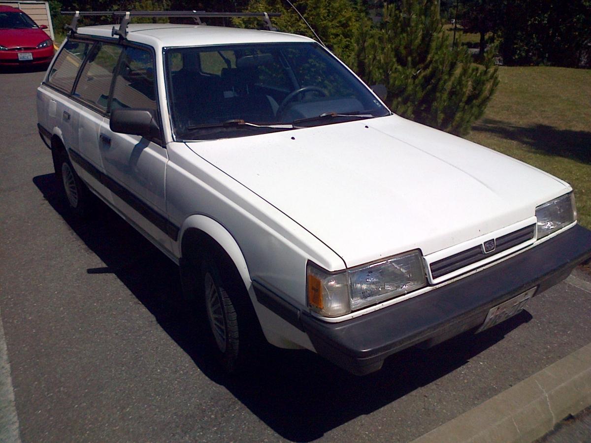

Helios 1 Posted July 16, 2013 Share Posted July 16, 2013 (edited) Greetings to all here in the Ultimate Subaru Message Boards, I recently purchased a Subaru wagon and am having various issues with which I hope some of you can help address. To begin, I purchased the wagon off of Craigs List in the Skagit area of WA. It was originally advertised for $500 and the ad was verbatim:"Its white got the roof rack won't go over 40 mph 4x4 push button stuck on..have title in hand and it runs but i will tow for maybe alittle extra..call me up...not a daily driver project for mechanic...probally a quick fix and flip..."Here's the link: http://skagit.craigslist.org/cto/3871124465.htmlAfter asking about the 4WD issue and what else is wrong with the car, I managed to talk the seller down to $400 vice the original $500 price tag. I shelled out an extra $50 for him to tow it to my place and that was about 2 weeks ago. To clarify, it's a 1992 Subaru Loyale Wagon 5-Speed SPFI 4x4 non-turbo (VIN 5). Considering the condition of the body, interior and engine from what I could tell, the car's a decent enough deal. The car starts, runs, drives, and stops, but not as well as it should.Before I get too much into the issues and what's been done thus far, please keep in mind I don't have much automotive experience. It wasn't until last year when I purchased my 1st Dodge Ramcharger that I started tinkering. Since then I've worked on another Ramcharger, an '87 CRX, and a '90 Civic. I can manage air filters, fuel filters, spark plugs, spark plug wires, distributor caps/rotors, ignition coils, bulbs, headlights, lift supports (hatches), fluid checks/changes, and things of that nature. Basic stuff. I also try to utilize the proper terminology so that I know what I'm referring to when at an auto part store or when getting insight from my mechanic buddies.So, on to the laundry list...- Engine backfiring,- 4x4 won't disengage- Loss of power- Grinding/"whirring" noise in front tires when slowing down- Stalling- Worn bearings/brake rotors?When I first got the car, I started it up and tried reversing. The car stalled out in the clutch-to-accelerator transition. I started it back up, cranked the RPMs to 3k and pulled back into the parking spot it was in. So far I've replaced the spark plugs, plug wires, distributor cap/rotor, and fuel filter as well as giving the car some love with a wipe down and bath. As of last night, my mechanic buddy took out the rear driveline after realizing the lever for the 4x4 (underneath the car) wouldn't budge. I think my transfer case is screwed up, but I don't know for certain. My buddy told me we'd need a lift or floor jack to get the car up high enough to diagnose it better. After he took out the rear driveline, I took the car around the block and it did in fact drive as if it was in FWD vice 4WD. However, there's an odd "whirring"/grinding noise coming from the front tires. It doesn't happen when I apply the brakes, but instead when I coast and am slowing down-thus why I thought it to be bad bearings. Also, the car backfires, has loss of power (RPMs surge, but acceleration is slow), it hates hills with a passion and will stall out easily on inclines.I personally think I either need a new fuel filter and/or intake manifold gasket, wheel bearings, timing redone, and a general tune up, especially with the SPFI.Again, I never claimed to know what in the wide world of sports I'm talking about when it comes to automotive, but I do follow the repair/owner's manuals step by step and to a "t". Any advice is greatly appreciated. More pics will come soon.Andrew Edited July 16, 2013 by Helios 1 Link to comment Share on other sites More sharing options...
