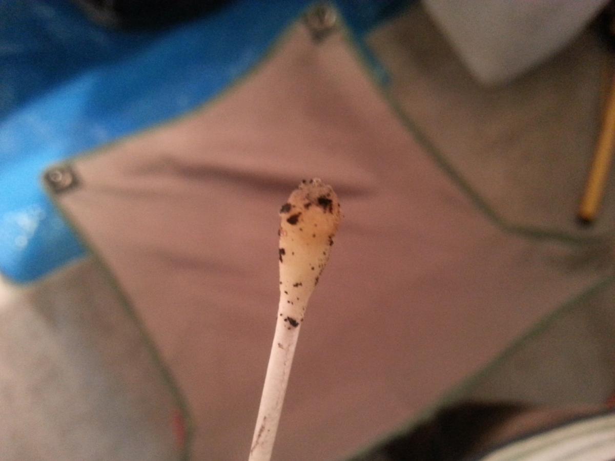

bluebonnet81 Posted July 29, 2013 Author Share Posted July 29, 2013 I had to pay the guy to get my car back so it is in my garage now. The engine is definitely seized. I swabbed the inside of one of the cylinders and found a bunch of gunk and particles (see photo). Anybody know what this crap is? Link to comment Share on other sites More sharing options...

man on the moon Posted July 29, 2013 Share Posted July 29, 2013 Seized as in it won't turn, even by hand? Hard to tell from the pic what the crud is, can you describe it?As long as it's seized I'll egg you on to pull it apart and figure out why. This makes absolutely no sense unless it threw a rod and the rod jammed the whole thing up somehow. That and/or it ate a valve and THAT somehow jammed her up.Or he didn't add oil until after the fact...but...any good mechanic could hear the sound of a motor sans oil...speaking of oil, does it smell like fuel as reported by third parties? I'd also suggest dropping the oil and using a magnet to see if any debris is in it. Ditto with the oil filter. Eyeballs and a magnet.Even if you don't split the block, at least pull the oil pan off and see if anything is amiss up in the innards. Link to comment Share on other sites More sharing options...
ivans imports Posted July 29, 2013 Share Posted July 29, 2013 Is it posibble the car was sugared in the tank mabee before you bought it ? that whould do it make shure you drain out the feul and check it have seen this wreak engine after engine before sugar in tank was found. Just a thought. Any signs of overheating ? melted parts low coolant stinky coolant or oil mabee airlocked and overheated it Link to comment Share on other sites More sharing options...
