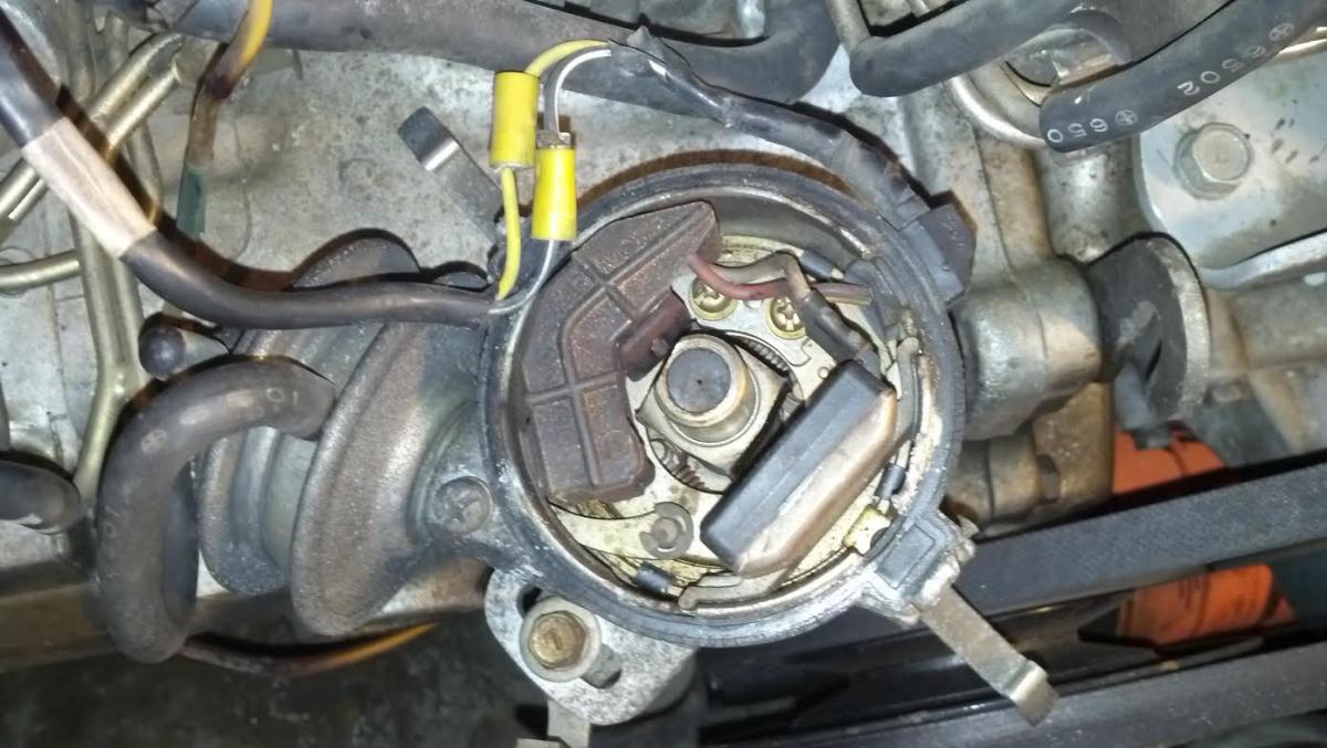

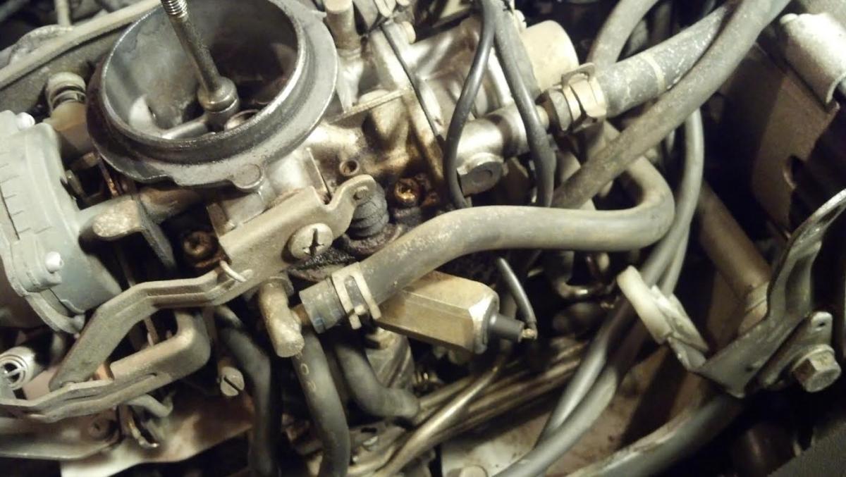

TIMBERTIGER Posted December 22, 2013 Author Share Posted December 22, 2013 Well I've finally got a chance to begin taking her apart. I started to remove the distributor and noticed there are a few options when it comes to purchasing a new one. I've attached a picture. Is this the right one for my 86 BRAT? I'm assuming it's not the original judging by the splice. Ive also attached a picture of a damaged wire on the carb. Could this contribute to my fuel pump issue? Thanks! Link to comment Share on other sites More sharing options...
Captin Hook Posted December 22, 2013 Share Posted December 22, 2013 Looks to be the wrong disy, and maybe. The disy should only have one vac port, I'll snap a picture of my tomorrow for ya. 1 Link to comment Share on other sites More sharing options...

TIMBERTIGER Posted December 26, 2013 Author Share Posted December 26, 2013 Ok so I swapped the distributor with the other type and the tach jump and noise seems to have disappeared for now. The car was still missing and dying under load so I temp installed an aftermarket fuel pump. So far, she seems to be running great. The old fuel pump must have been weak and conveniently failed the same time as the distributor. I have the fuel pump wired to a switch right now so I still haven't checked to see if the "no power to fuel pump" problem is resolved with the new disty. Link to comment Share on other sites More sharing options...
Captin Hook Posted December 28, 2013 Share Posted December 28, 2013 Here's the parts break down I'll still get some pictures of my disy when I get off work tonight. This is for an 84 ea81 brat Link to comment Share on other sites More sharing options...

pksjeep Posted January 6, 2014 Share Posted January 6, 2014 Going back to the picture of the carb. I believe the wire goes to an antidiesel device. If the wire grounds it will stall the car. If this is the problemtry to start the car and wiggle the wire it should affect the way the carruns. Paul Link to comment Share on other sites More sharing options...

ivans imports Posted February 28, 2014 Share Posted February 28, 2014 Find a hitachi dis for it Nippon ones not so good also have you checked the fuel pump timer ? and the screen in the carb on the neddle and seat was a problem on those carbed cars screen pluged up and bypassed carb = no fuel Link to comment Share on other sites More sharing options...
