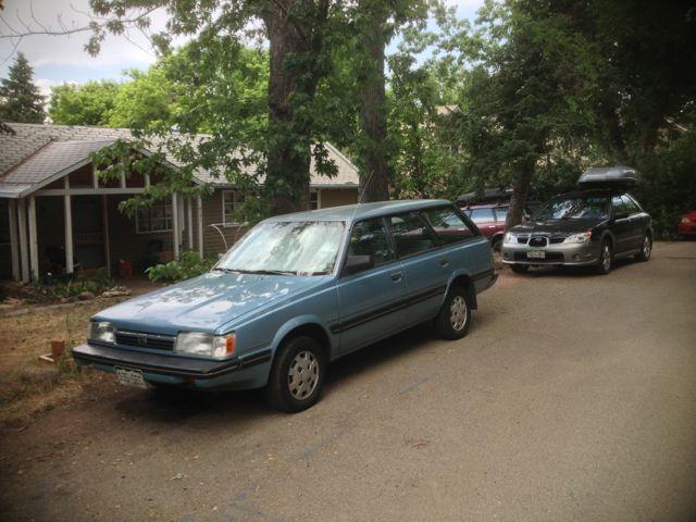

snofool Posted August 5, 2013 Share Posted August 5, 2013 (edited) Here is my project 89 gl 90 legacy 2.2 ej Legacy lsi front seats boss 2in lift XT6 suspention and hubs Impreza Suspention Outback wheels Edited December 29, 2014 by snofool Link to comment Share on other sites More sharing options...
