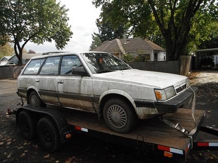

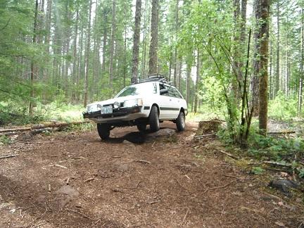

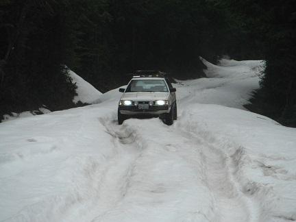

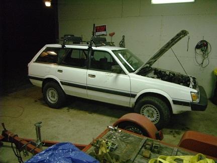

92loyale59 Posted August 8, 2013 Share Posted August 8, 2013 so i got this car about the end of last summer. it had about 125000 miles on it. this is how i bought it . blown HG and everything so i took engine out and resealed the whole thing got a new oil pump water pump timing belts resurfaced heads and replaced almost everthig else including the lifters but after adding a lift bigger tires and a whole winter of redlining i blew the headgasket. . . again. here are some pictures of my car before i blew it Link to comment Share on other sites More sharing options...

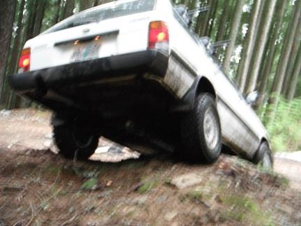

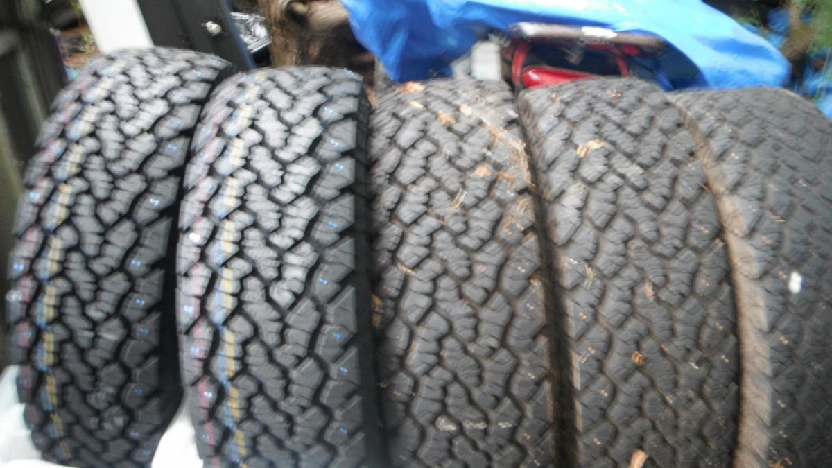

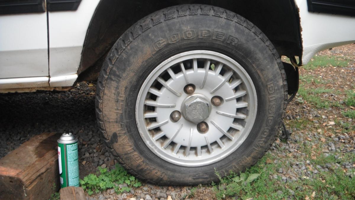

92loyale59 Posted August 8, 2013 Author Share Posted August 8, 2013 i have my desanation cooper tires on i this picture not my generals Link to comment Share on other sites More sharing options...

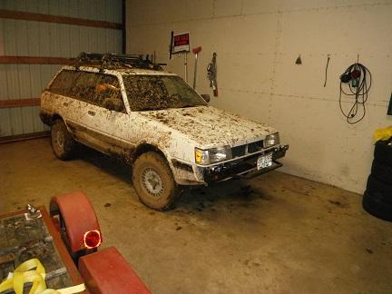

MR_Loyale Posted August 15, 2013 Share Posted August 15, 2013 Looks like your front grill is missing. Link to comment Share on other sites More sharing options...
92loyale59 Posted August 15, 2013 Author Share Posted August 15, 2013 i assume i blew the head gaskets multipule times because i have huge tires on the car and i would drive it very hard hah. but yeah the picuters where my grill is gone is because i was painting it black and just left it off untill i installed the KC spot lights. also i was pulling the engine that night installing that bumper i made and the piaa fogs so i just left the grill off a week or so. to make sure panit cured fully Link to comment Share on other sites More sharing options...

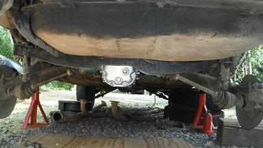

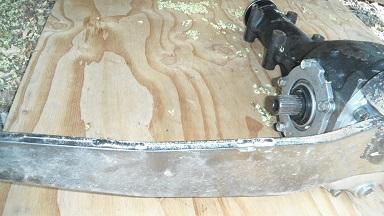

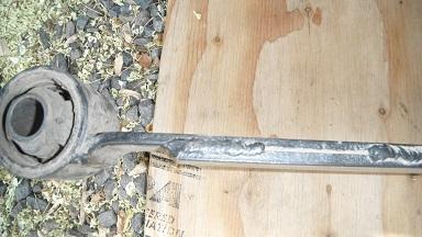

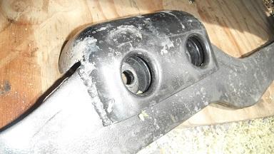

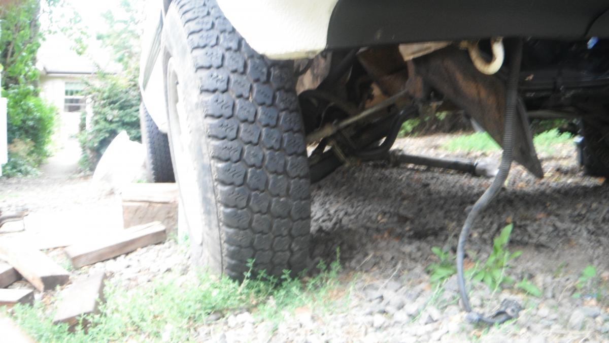

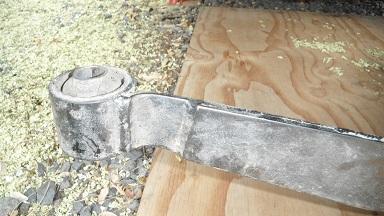

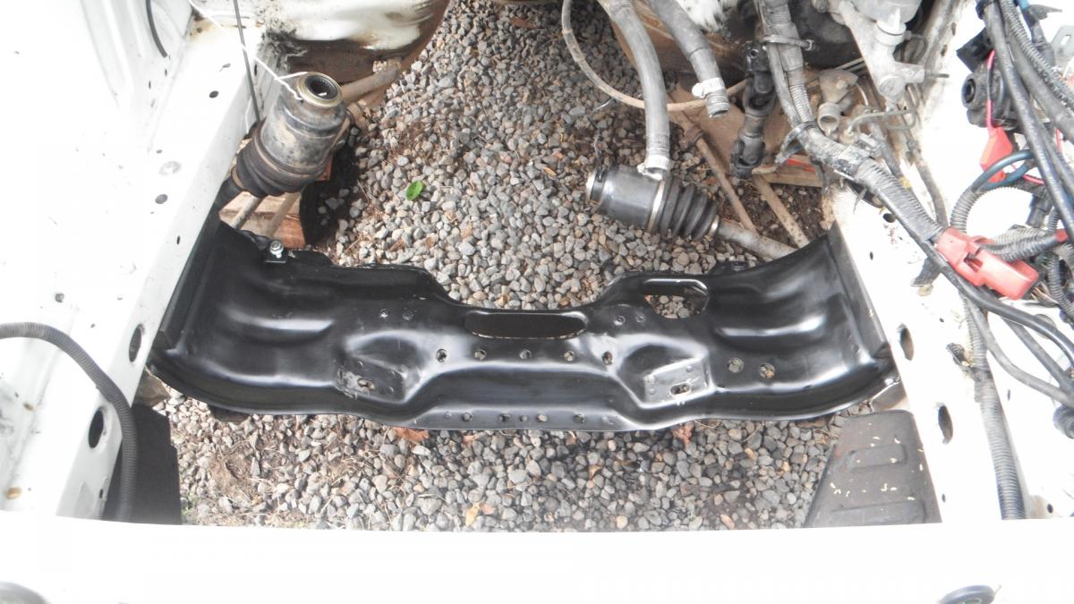

92loyale59 Posted August 23, 2013 Author Share Posted August 23, 2013 so i got my lsd swap done and installed it in my car. now i just need to find the axle pins i took out of the right rear axle... sucks working on a gravle driveway on a hill ......Thought i would also take a picture of the reinforced mustach bar i made. i took two and cut the ends off one welded them together. drilled some holes in the center all the way down it and welded those parts together also. actually managed to get the piece of metal that wraps over the bolts and top of the diff back on . painted and installed Link to comment Share on other sites More sharing options...
92loyale59 Posted August 23, 2013 Author Share Posted August 23, 2013 reason for the beefed up bar was i twisted mine i think from trying to slide around in 4wd on the pavment just after it rained . Link to comment Share on other sites More sharing options...

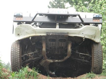

caspice Posted August 24, 2013 Share Posted August 24, 2013 What size lift? What size tyres? Did you covert/drill the hubs or running 14" pugs? Did you biy or build the front bumper? Link to comment Share on other sites More sharing options...

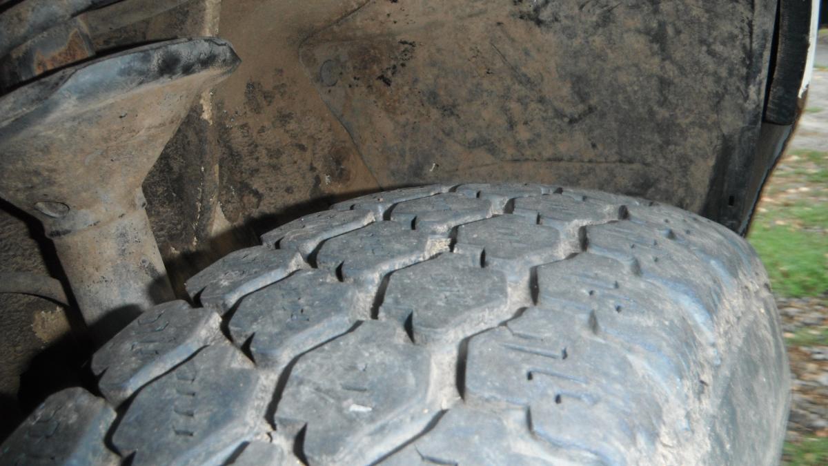

92loyale59 Posted August 24, 2013 Author Share Posted August 24, 2013 On 8/24/2013 at 12:36 PM, caspice said: What size lift? What size tyres? Did you covert/drill the hubs or running 14" pugs? Did you biy or build the front bumper? custom home made 2 inch lift. i spaced my engine x member and my tranny x member and the radius rod bracket down 1.5 inches so my axles are only a half inch off stock angle on it right now are 195 75 r14 but in the winter i run 27 x 8.5 r14 general grabbers . i have two full sets of pugs so thats what i havee been running but i just picked up a set of toyota 6 lug rims and going to be drilling them out and filling in extra holes and re painting. and i built the front bumper and got all the lights off craigslist for under 200 bucks. all were new in box Link to comment Share on other sites More sharing options...

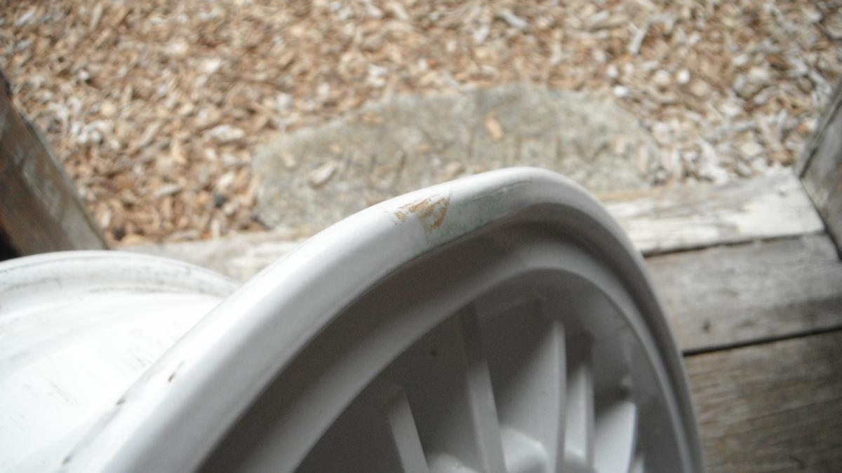

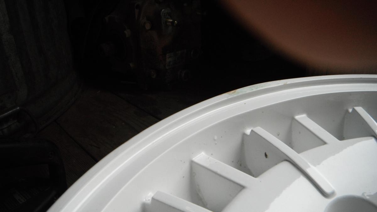

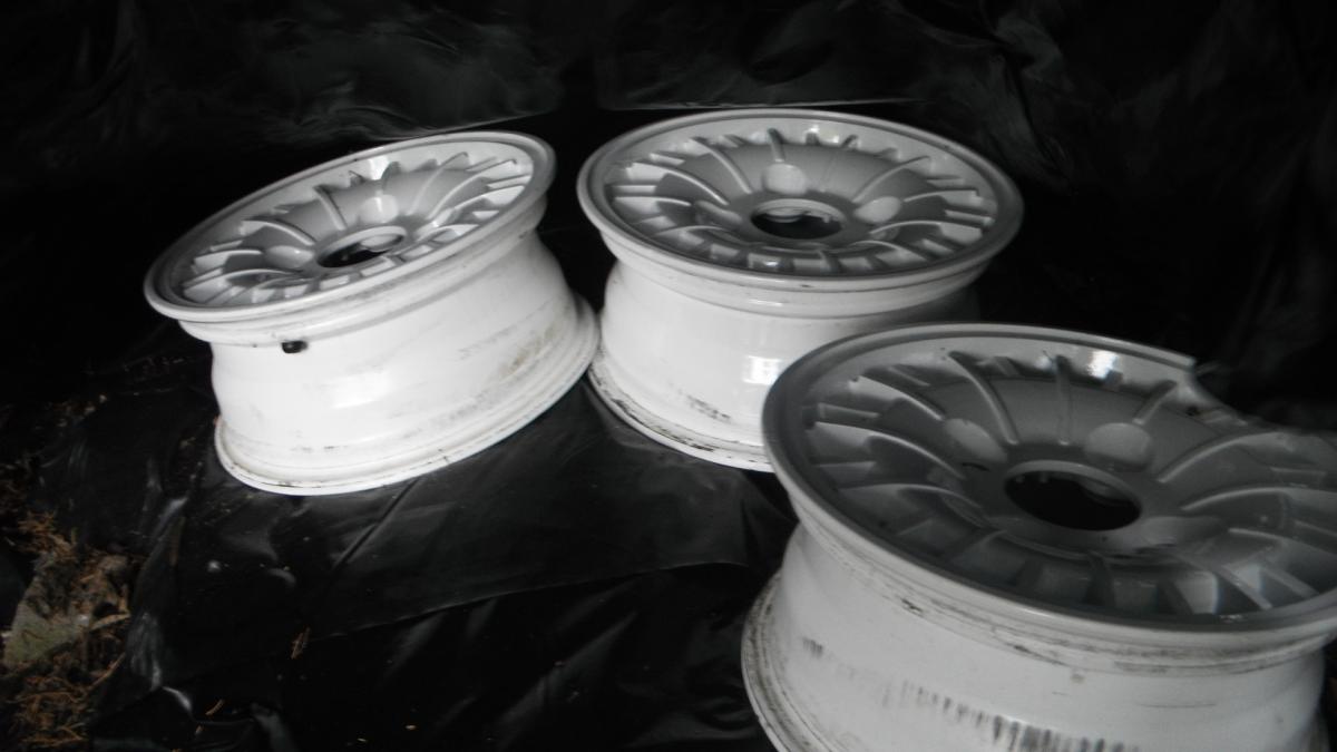

92loyale59 Posted September 15, 2013 Author Share Posted September 15, 2013 so i am hoping some one will be able to help me out here. i bought afull set of white powder coated peugoet 14 inch rims and one of themwere a bit bent on the out side edge . i have these pictures but im notsure how easily it can be seen . im basically wondering if i am able tobend the edge back flat some how . or how much it will even affect thetire holding air?. thanks for the input i already tired hammering it back with a block of wood and it didnt do much but mess up the paint Link to comment Share on other sites More sharing options...
92loyale59 Posted September 15, 2013 Author Share Posted September 15, 2013 summer wheels and tires and this is my winter tire and wheel set up i also have a extra general grabber with about 70% tread for a matching spare Link to comment Share on other sites More sharing options...

92loyale59 Posted September 16, 2013 Author Share Posted September 16, 2013 On 9/15/2013 at 7:30 PM, 92loyale59 said: so i am hoping some one will be able to help me out here. i bought a full set of white powder coated peugoet 14 inch rims and one of them were a bit bent on the out side edge . i have these pictures but im not sure how easily it can be seen . im basically wondering if i am able to bend the edge back flat some how . or how much it will even affect the tire holding air?. thanks for the input i already tired hammering it back with a block of wood and it didnt do much but mess up the paint DSCF5243.JPG DSCF5244.JPG DSCF5245.JPG Still wondering. Any feedback ? Link to comment Share on other sites More sharing options...

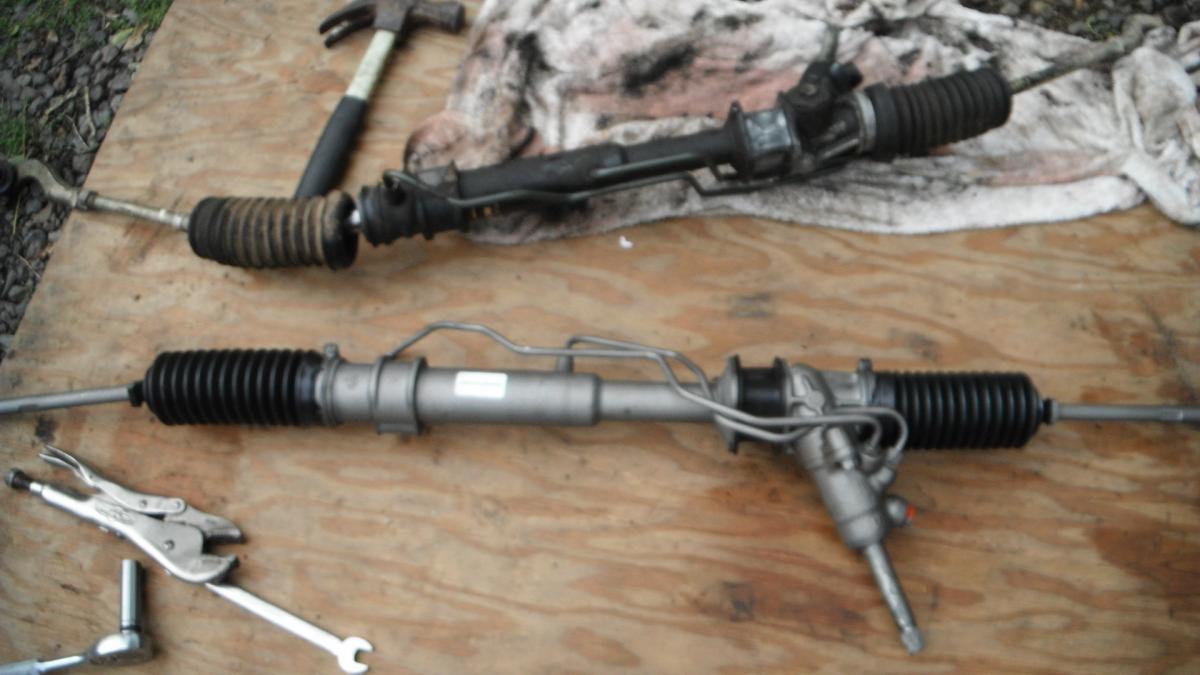

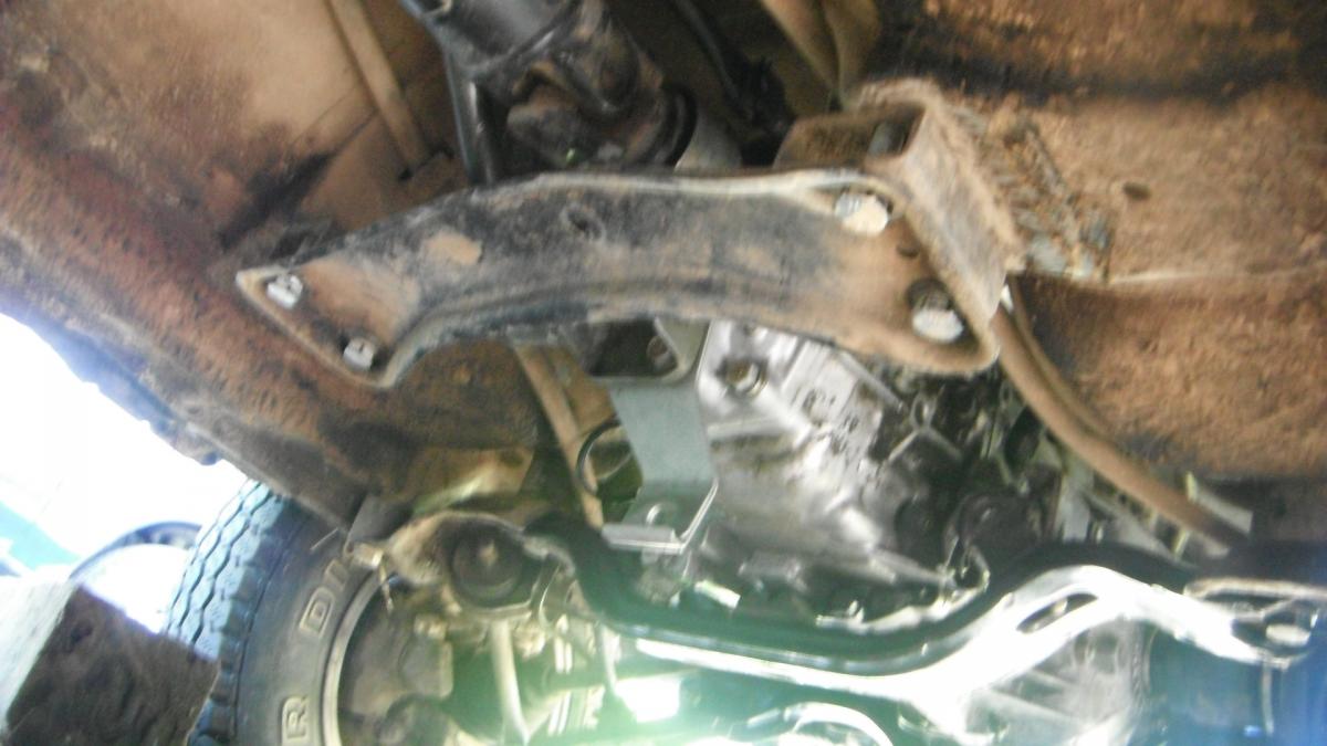

92loyale59 Posted October 3, 2013 Author Share Posted October 3, 2013 so i have been busy working and the time off i get its raining so notmuch has got done . today i replaced the steering rack and got thetranny under the car and ready to be installed .i got the steering rack from discount imports and it is re manufactured . it says koyo on it and so did the stock one . Link to comment Share on other sites More sharing options...

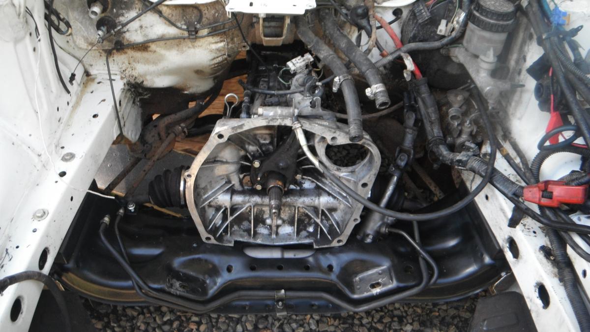

92loyale59 Posted October 5, 2013 Author Share Posted October 5, 2013 so today ended up being nicer than i thought it would be so i had a friend come over and help me install the tranny. I also hooked up the linkage and the driveline. Im pretty excited to find out how the D/R tranny will drive compared to the S/R Link to comment Share on other sites More sharing options...

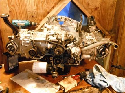

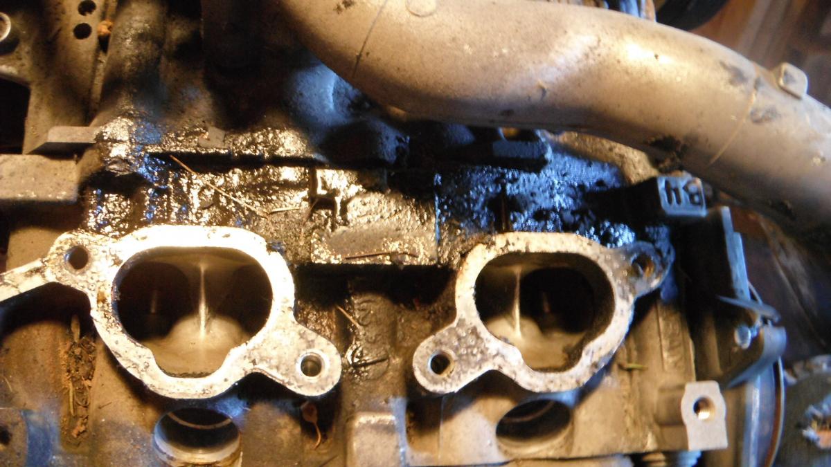

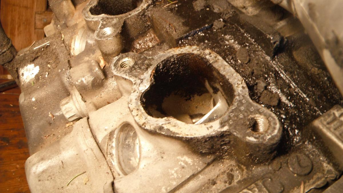

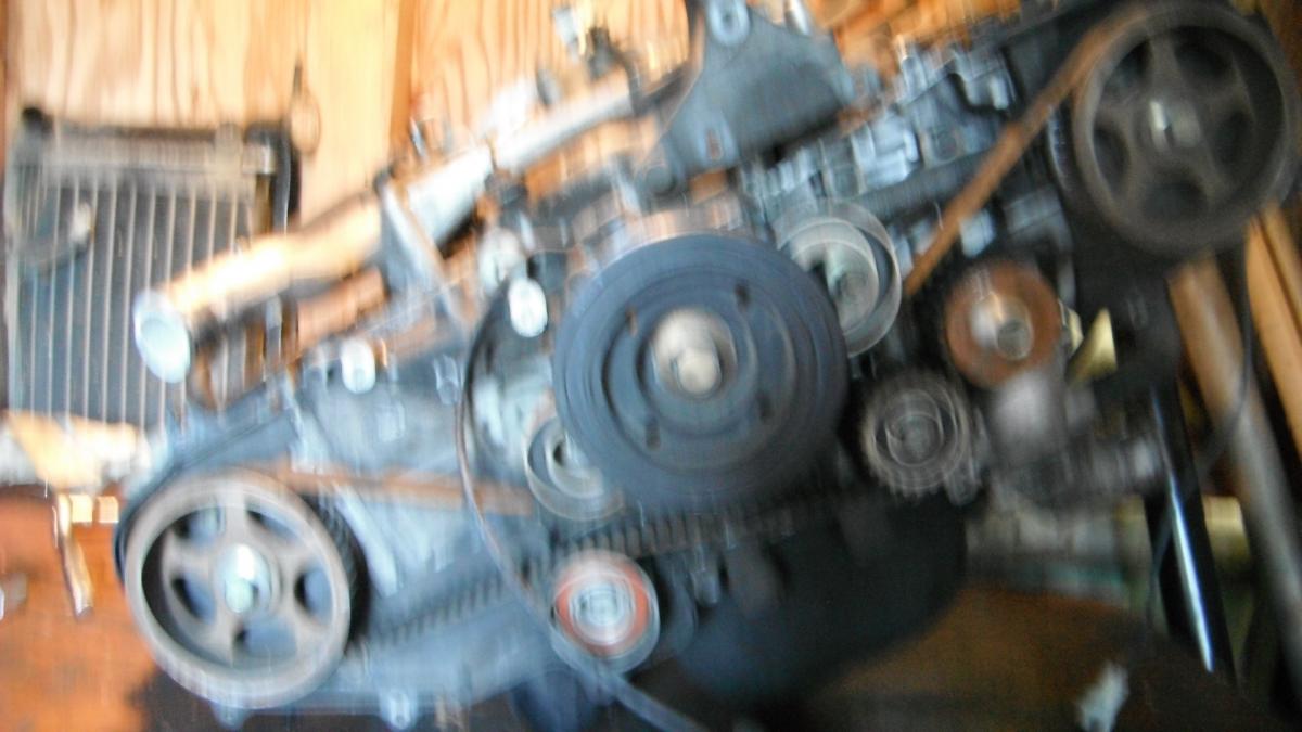

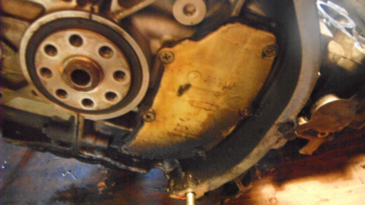

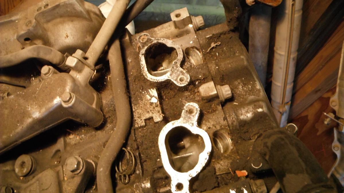

92loyale59 Posted October 5, 2013 Author Share Posted October 5, 2013 Here are some photos of my car with the D/R tranny installed I began to disassemble my engine today . when i got the intakemanifold off i noticed a lot of what looks like oil that leaked into theintake ports and on to the valves on all four intake ports. Does anybody knowif that will cause a problem ? was it just bad intake manifold gaskets? do ijust need to clean it up or can that cause a problem ? here are some pictures of the engine also i was wondering if this looks like it has a blown head gasket . my guess is yes is this a problem or just needs to be re sealed? Thanks a lot in advance for any help i am not to familiar with ej series engines . Link to comment Share on other sites More sharing options...
