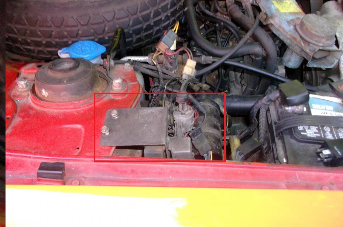

Bratmobile Posted August 10, 2013 Share Posted August 10, 2013 Ok~ended up doing trial and error on the Blower Motor relay location in an 86 Brat. I removed every relay behind the fuse box in the Brat one at a time to see what was affected.Results: found the relay for the headlights , (2 relays for that) the turn signals, the seatbelt warning lights, the intermittant wipers. And found no other relays there. So I went back under the hood & looked back where I started. I had one good/new square type relay that I switched out for the 3 available one at a time.The photos show what ended up being the relay for the blower motor~ it's a regular square type, actually pretty easy to find at a parts store. The fan works at all speeds now.First time in over two months~ I'm so happy!! Link to comment Share on other sites More sharing options...

Bratmobile Posted August 10, 2013 Author Share Posted August 10, 2013 Started putting the dash back together and double checked the fan midway~Worked for about 3 seconds then off again!! :banghead:I'm guessing some type of short to make the new relay work and then cut out. I'll keep you posted. Link to comment Share on other sites More sharing options...
Loyale 2.7 Turbo Posted August 11, 2013 Share Posted August 11, 2013 Maybe the "New" Relay isn't good? I've seen many New Cheapo Relays that comes bad out from their Boxes. I Suggest you to Try with a Bosch... But also Be Sure that Power gets to the Relay all the Time when Key is in "On" Position. There "could" be some kind of Power Cutoff while A/C (and thus the engine) isn't Running, Depending on the A/C wirings. Kind Regards. Link to comment Share on other sites More sharing options...
Gloyale Posted August 11, 2013 Share Posted August 11, 2013 (edited) That's not the blower relay. It just isn't. It can't be? Brat's without A/C don't even have those relays there. And honestly, those don't look like Factory FHI relays...more like an aftermarket or at least a Dealer installed A/C kit. Looking closely at the pic I can see A/C high side pline is wrong type to be factory either. Those relays are part of the A/C kit. Now those relays are tied to the blower circuit, so perhaps a backfeed provided power. Edited August 11, 2013 by Gloyale Link to comment Share on other sites More sharing options...

Gloyale Posted August 11, 2013 Share Posted August 11, 2013 Let's start over. Do you have 12v on the GW wire at the fan with key on? Yes---it's not the relay anyhow. problem would be on the ground side....check the switches and resistor pack. No-----Provide 12v to the GW wire at the fan. Now turn on the blower with the switch, does it work? if yes the Switch and resistor pack are good. You could then simply add a relay to provide power the GW wire. Or find the relay.....it's definately in the instrument panel wireing....shown in the FSM with 4 wires, square connector, most likely a round relay, but definately a square connector. Link to comment Share on other sites More sharing options...

Gloyale Posted August 12, 2013 Share Posted August 12, 2013 (edited) Found it. There is no relay. There is a jumper setup at the relay connector. I guess when you add A/C, you take over the stock blower circuit, and reroute it through the relay (supplied 12v+ by the glass fuse). But in the stock form, with no A/C there is just a jumper from the Blue/black wire to the Green/white wire in the relay bundle. The FSM always shows the full A/C setup....I've not found any references to the jumper setup. Probably mentioned in the install literature for the A/C system.....which I don't have those books. Anyhow....I'm uploading the pics now. the pics of the setup in both my 84 wagon, and in my 86 Brat....both with no A/C. You're aftermarket a/C setup may not have removed the jumper and replaced with a relay this way. Maybe your jumper is disconnected. Or if there is another issue on the Blue/black supply circuit.........just pop a relay in and use the glass fuse circuit. Edited August 12, 2013 by Gloyale 1 Link to comment Share on other sites More sharing options...
Gloyale Posted August 12, 2013 Share Posted August 12, 2013 Here it is in my Brat Here in my 84 Wagon And here's what it would look like with the Subaru dealer installed setup. W/relay Link to comment Share on other sites More sharing options...
