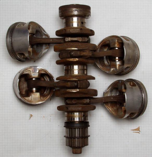

WoodsWagon Posted August 26, 2013 Share Posted August 26, 2013 Take a look at those connecting rods. I drove it for a couple weeks like that after the 4k rpm hydrolock incident. Sure, it was down on power, and yes it made some pretty bad noises with the pistons hitting the bottom of the cylinder bores, but it still ran and drove. I didn't spare it any either because I knew it was done and had an EJ22 to replace it. It would only rev to mid 6's instead of low 8's. That same engine held a lifted wagon on 30" mud tires at 90+ mph for an hour straight. It couldn't quite break 100, but holding it WOT for that whole time didn't blow it. I've put some other EA82's through their paces and I've never had one blow. They all were gutless through. I can't tell you how many times that EA powered out on climbs in the woods that the EJ just ripped up later. The fun to drive factor of the car went up 50% I'd say with the engine swap. I could pass people if I wanted! I could be doing highway speed by the time I hit the end of the onramp! So that's the downside of the EA82's. I wouldn't bother rebuilding one. I saw a rebuilt shortblock in the junkyard recently. It had a metal plate glued to the pan: mains 0 rods 0 cylinders 0, so it didn't take any machine work to "rebuild" it. There's so many used ones out there in perfectly serviceable condition that just need gaskets that it doesn't make sense to pay a shop to go through one that's truly gone bad. Link to comment Share on other sites More sharing options...
ivans imports Posted August 26, 2013 Share Posted August 26, 2013 The last race engine had 3 bent rods and two smashed pistons did 2 passes like that bent rods dont seem to slow them down mutch Link to comment Share on other sites More sharing options...
