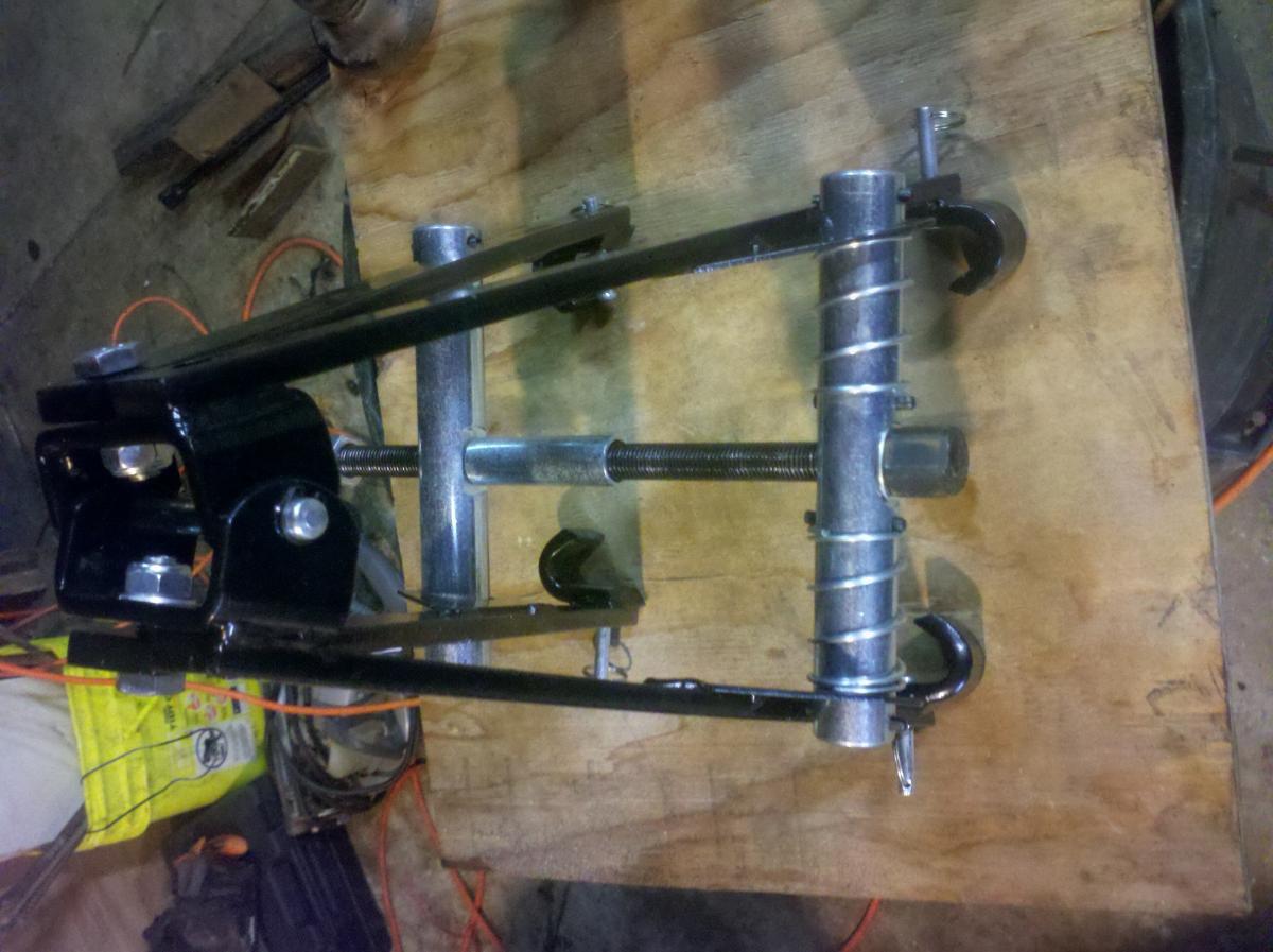

apintonut Posted August 22, 2013 Author Share Posted August 22, 2013 i bout accord rear springs and temo/topaz front springs (the front springs look like they will not work so well) look to big FORD ESCORT(1985 - 1989) FORD TEMPO(1985 - 1994) MERCURY LYNX(1985 - 1987) MERCURY TOPAZ(1985 - 1994) then i couldnt find my spring compressors so i went and got a new one (what a pos) it was the only one they had Link to comment Share on other sites More sharing options...

apintonut Posted August 22, 2013 Author Share Posted August 22, 2013 they are WAY to stiff could have just welded it solid going to cut a coil and try again Link to comment Share on other sites More sharing options...

Loyale 2.7 Turbo Posted August 23, 2013 Share Posted August 23, 2013 they are WAY to stiff ... I am one of those who have used Tempo Coil Springs on EA82 Subarus, and as far as I Know the V6 Tempos with Auto Trans + A/C uses a Coil Spring which is way too stiff, some USMB members have cutted one and a half turns out of those in order to let them work; I used the ones from a 4 Cyl, engined Tempo with manual trans, also the ones I used where from a Junk Yard, so they were not too stiff, I used them Without cutting anything. The Part Numbers of those two different Tempo's Coil Springs are given in This Writeup: ~► http://www.ultimatesubaru.org/forum/topic/106807-improved-shock-absorbers-and-spring-coils-on-loyales/ I Guess that you obtained the Stiffer ones. Kind Regards. Link to comment Share on other sites More sharing options...
apintonut Posted August 23, 2013 Author Share Posted August 23, 2013 (edited) nope 4cyl / 5 speed / junk yard / 50$ Edited August 23, 2013 by apintonut Link to comment Share on other sites More sharing options...

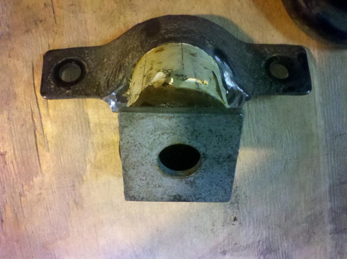

apintonut Posted August 27, 2013 Author Share Posted August 27, 2013 Has any one tryed this? Its a pice of 2" tubing said 1.84 id 2 od i was just standing in the garge looking at my painted parts and thought ide try it looks like it worked good and realy cheap but its probly been seen by every one els im just a noob Link to comment Share on other sites More sharing options...

Gloyale Posted September 13, 2013 Share Posted September 13, 2013 Has any one tryed this? Its a pice of 2" tubing said 1.84 id 2 od i was just standing in the garge looking at my painted parts and thought ide try it looks like it worked good and realy cheap but its probly been seen by every one els im just a noob Will make it sit up stiff and tall, but since you aren't making the strut longer you will be shortening the amount of travel. Link to comment Share on other sites More sharing options...
apintonut Posted September 13, 2013 Author Share Posted September 13, 2013 Will make it sit up stiff and tall, but since you aren't making the strut longer you will be shortening the amount of travel. Just thouught it was better than buying honda springs and these older cars can be droopy in the bum Link to comment Share on other sites More sharing options...
Gloyale Posted September 14, 2013 Share Posted September 14, 2013 Just thouught it was better than buying honda springs and these older cars can be droopy in the bum Teh spring would be so compressed once assembled, that there would be no travel left. The coils would be touching eachother. might as well put a solid bar in there. Similar in concept to this mod I've done, but much less extreme. I used the old spring perch from an old shock, flippped over underneath the perch of the new shock. Link to comment Share on other sites More sharing options...
apintonut Posted September 14, 2013 Author Share Posted September 14, 2013 Teh spring would be so compressed once assembled, that there would be no travel left. The coils would be touching eachother. might as well put a solid bar in there. Thats an idea good thinking if you have the parts there Similar in concept to this mod I've done, but much less extreme. I used the old spring perch from an old shock, flippped over underneath the perch of the new shock. Link to comment Share on other sites More sharing options...
