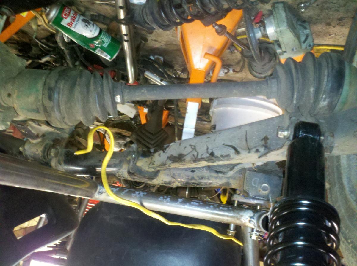

apintonut Posted May 11, 2014 Author Share Posted May 11, 2014 A bit more Link to comment Share on other sites More sharing options...

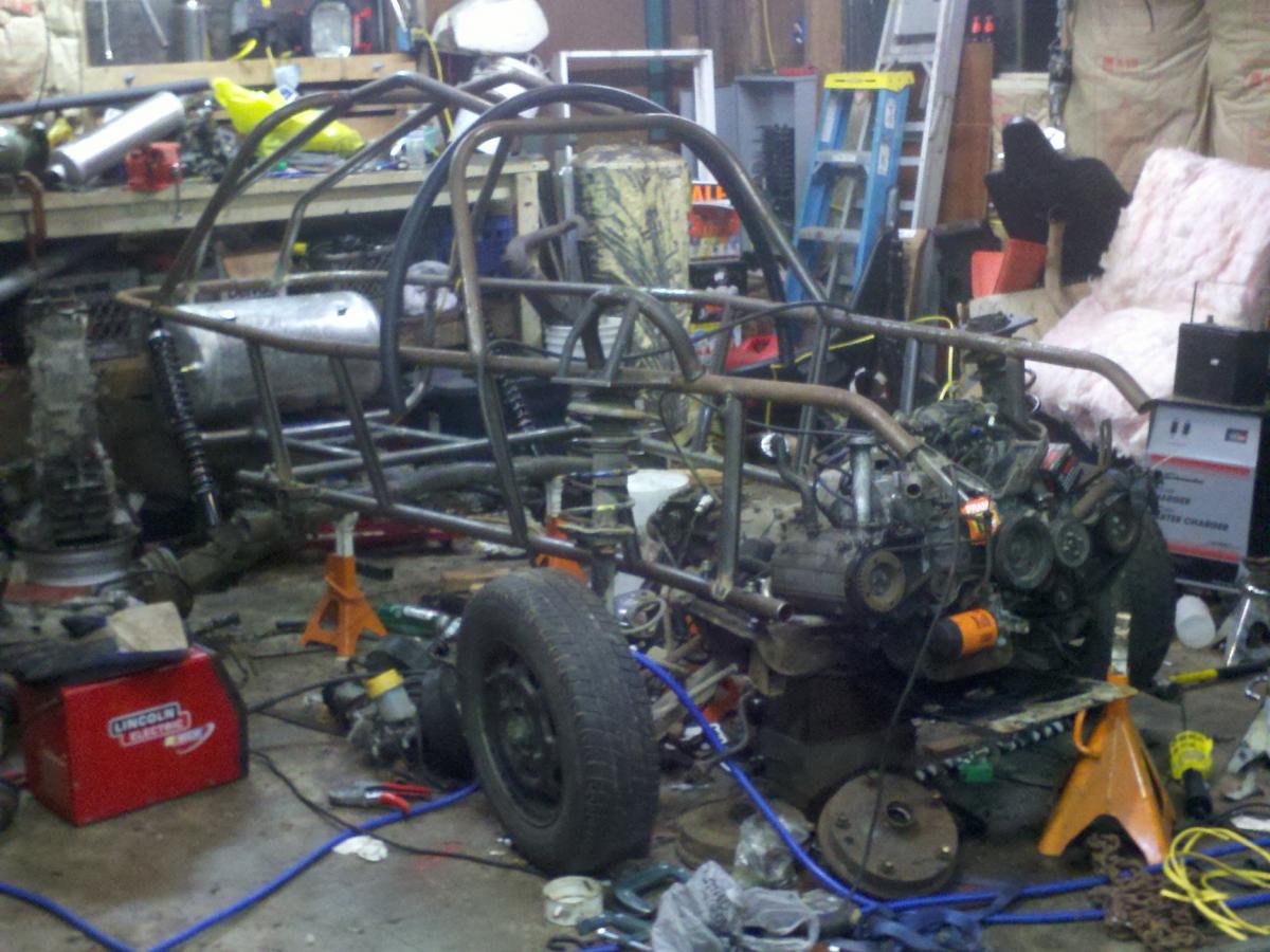

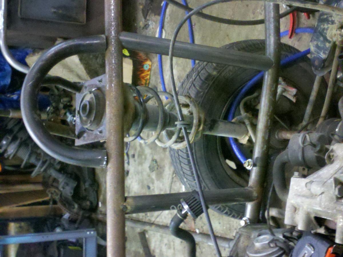

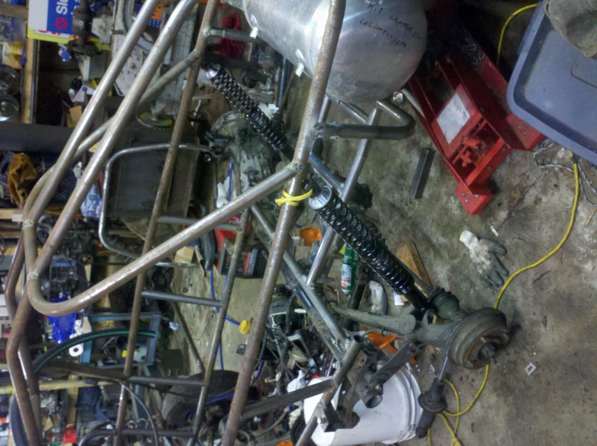

apintonut Posted May 11, 2014 Author Share Posted May 11, 2014 Dont know if i can run the rear shocks that far angled Link to comment Share on other sites More sharing options...

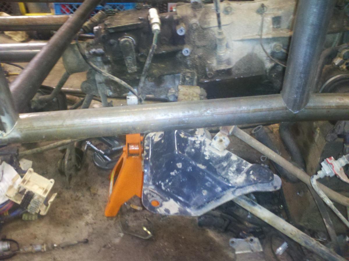

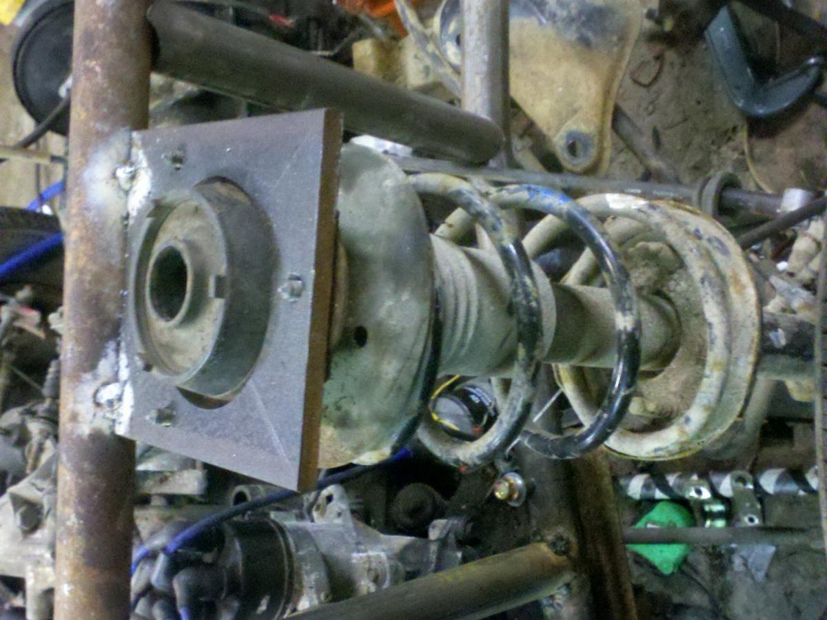

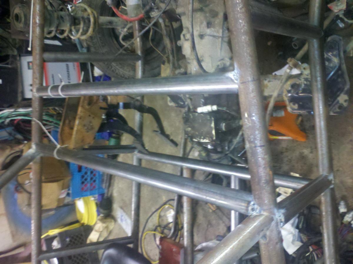

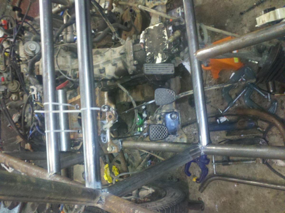

apintonut Posted May 13, 2014 Author Share Posted May 13, 2014 Frustrated with buuilding crosmember mout for the tanny played with some other stuff Link to comment Share on other sites More sharing options...

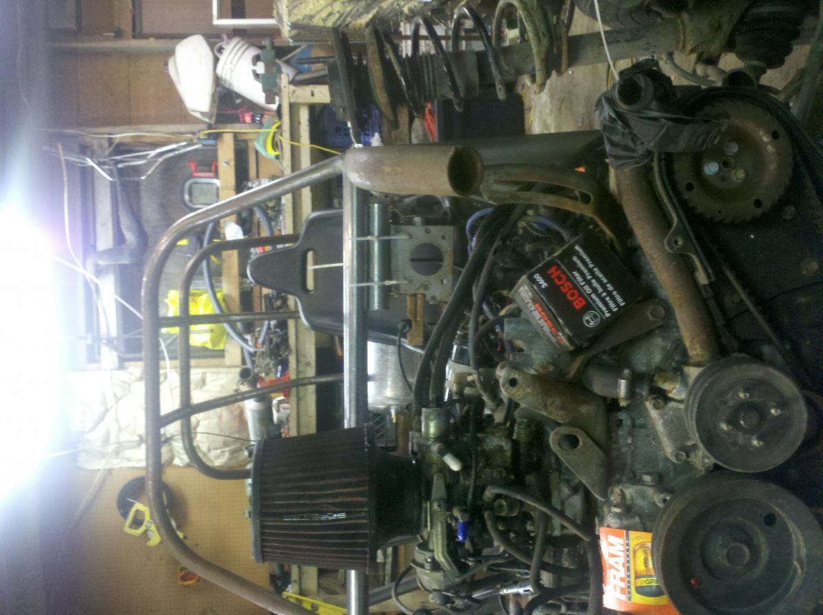

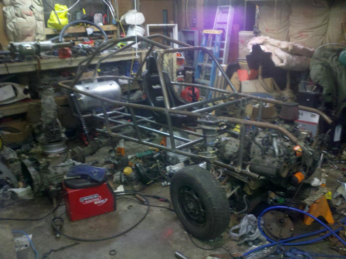

apintonut Posted May 13, 2014 Author Share Posted May 13, 2014 Some more pics Link to comment Share on other sites More sharing options...

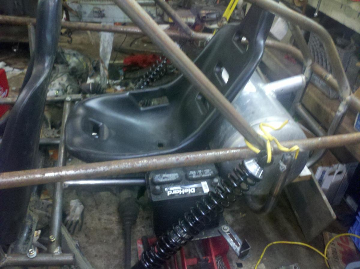

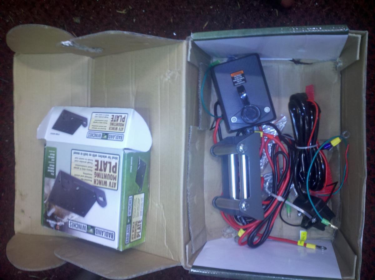

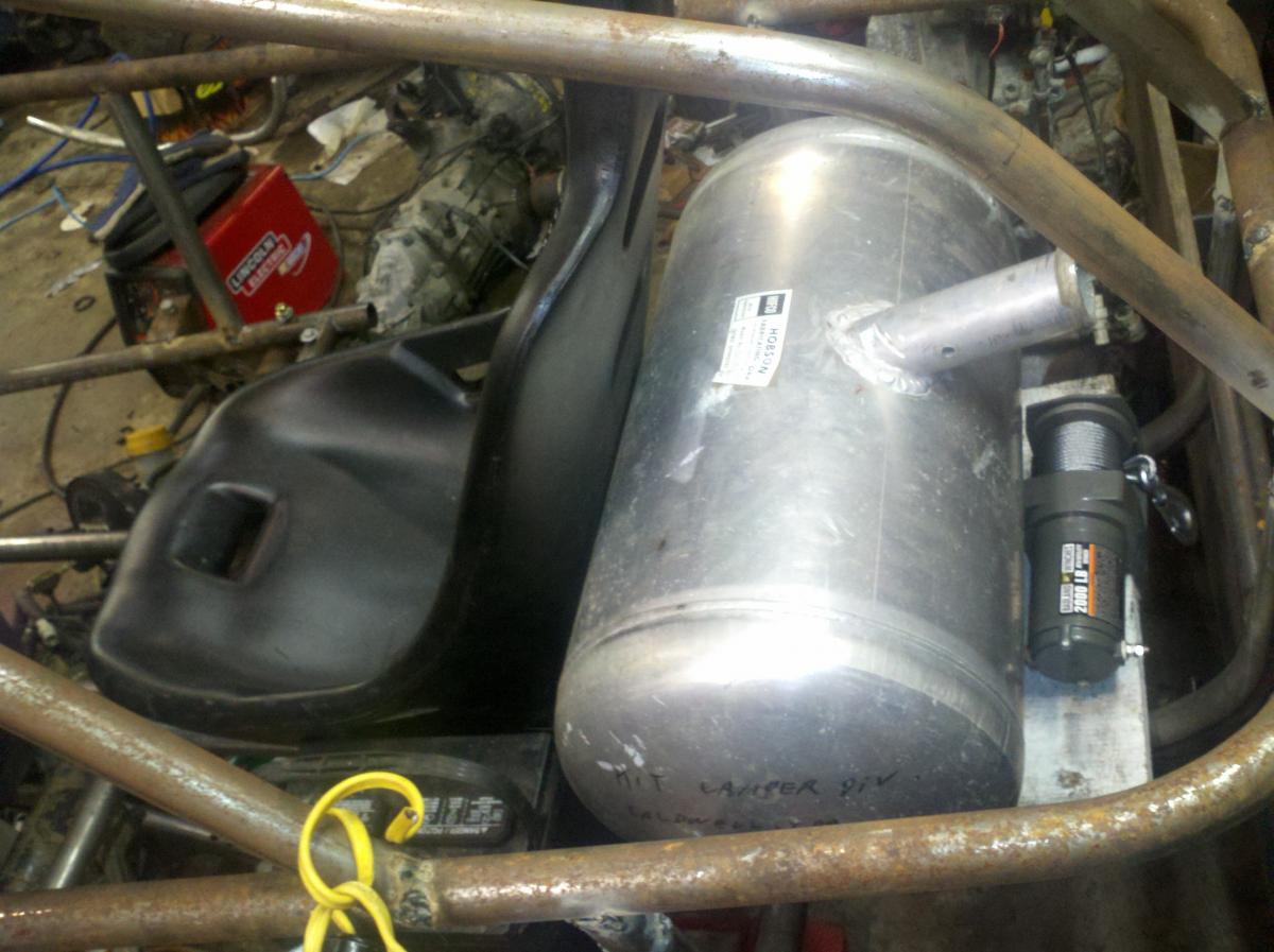

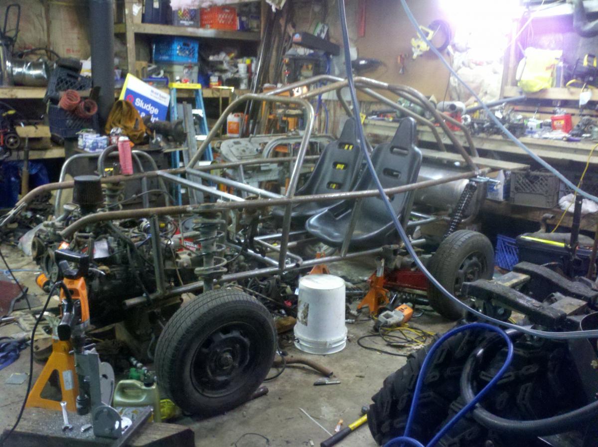

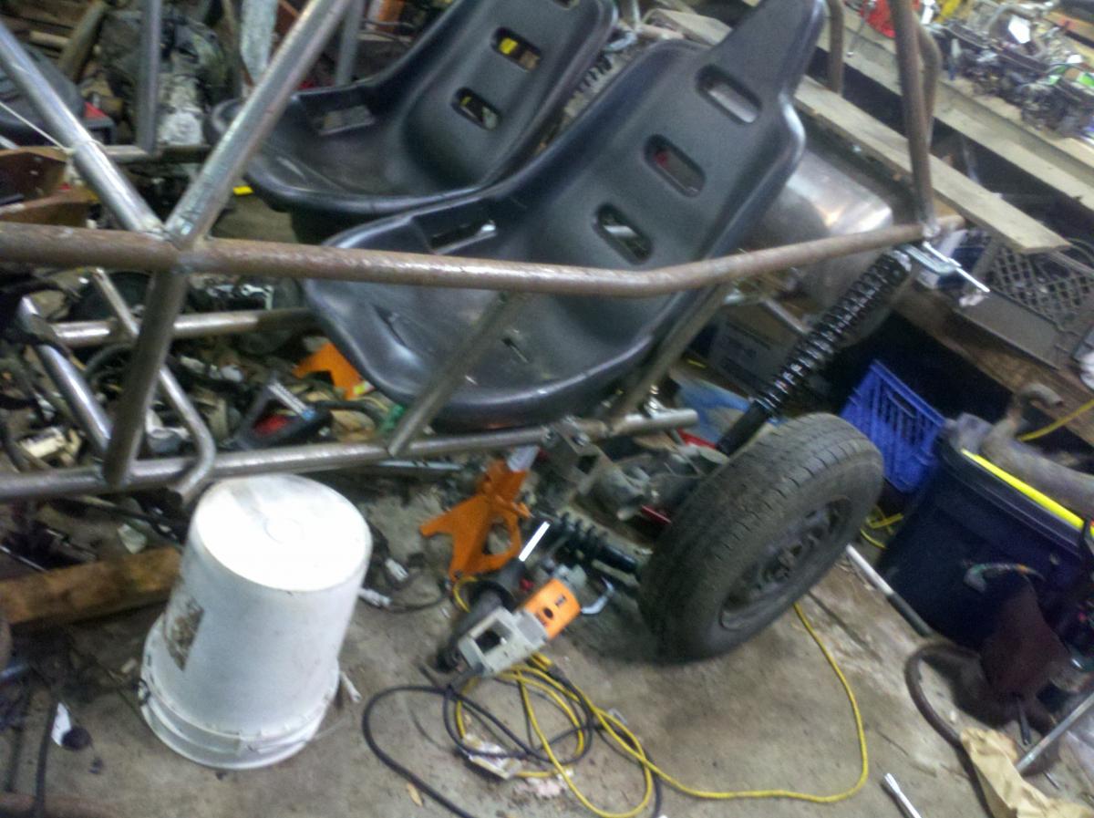

apintonut Posted May 13, 2014 Author Share Posted May 13, 2014 Tryinng to figur out placemennt and if i have room for the 20 gallon fuel tannk (was 15$ at the scrap yard ) winch 2x group 24 batterys and a back seat would like to find 4x subaru brat seats just need bare seat and 2 with just handles Link to comment Share on other sites More sharing options...

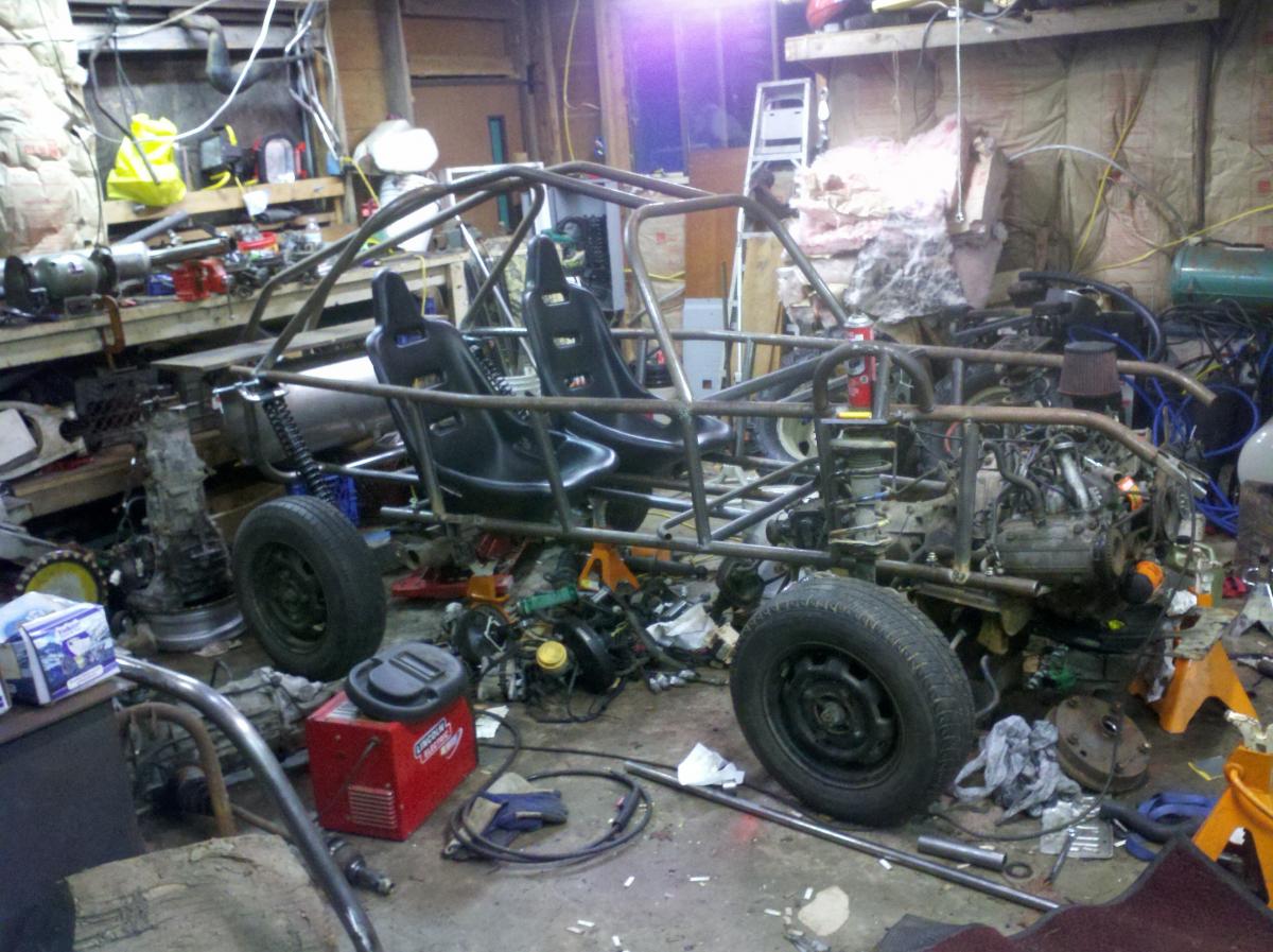

apintonut Posted May 20, 2014 Author Share Posted May 20, 2014 Sitting all on its own wheels and tires Link to comment Share on other sites More sharing options...
apintonut Posted May 20, 2014 Author Share Posted May 20, 2014 Think I need to move the shock forward about 4" as its a bit soft the way it sits and there is more room for travel once it has weight on it Link to comment Share on other sites More sharing options...
apintonut Posted May 20, 2014 Author Share Posted May 20, 2014 (edited) Any one have any thoughts? Edited May 20, 2014 by apintonut 1 Link to comment Share on other sites More sharing options...

Scott in Bellingham Posted June 21, 2014 Share Posted June 21, 2014 (edited) I like what your doing, looks like something I would build, want to help where I can, on the rear spring set it up more vertical then try it out once all the weight is on the car, those rear axles are limited on there travel, work within there travel and you will be ok, when do you plan to have it going? any events or outings your trying to make? Edited June 21, 2014 by Scott in Bellingham Link to comment Share on other sites More sharing options...

apintonut Posted June 22, 2015 Author Share Posted June 22, 2015 Note the shock angle is to sloped so it was to soft moved the up today and it may be to stiff now the CV are to much angle but I'm going to run with it for now and spend another 150$ on shocks if must or move them back at the last second if I must Link to comment Share on other sites More sharing options...
