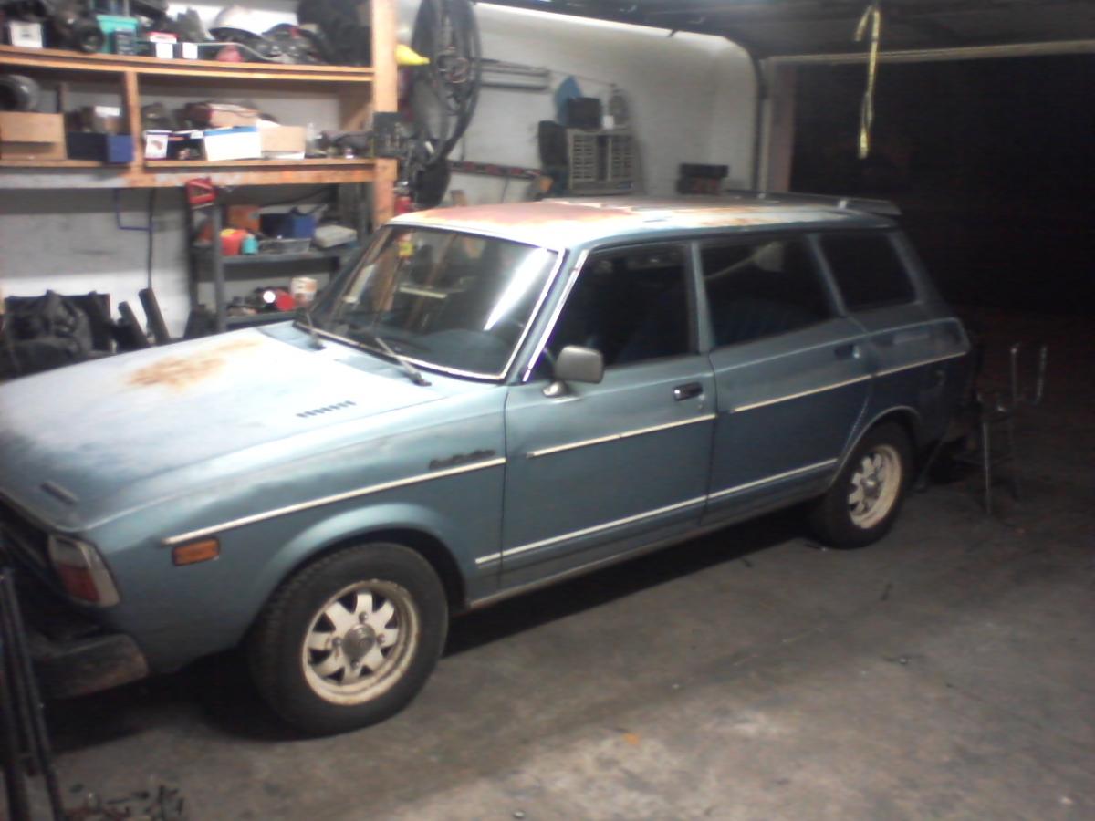

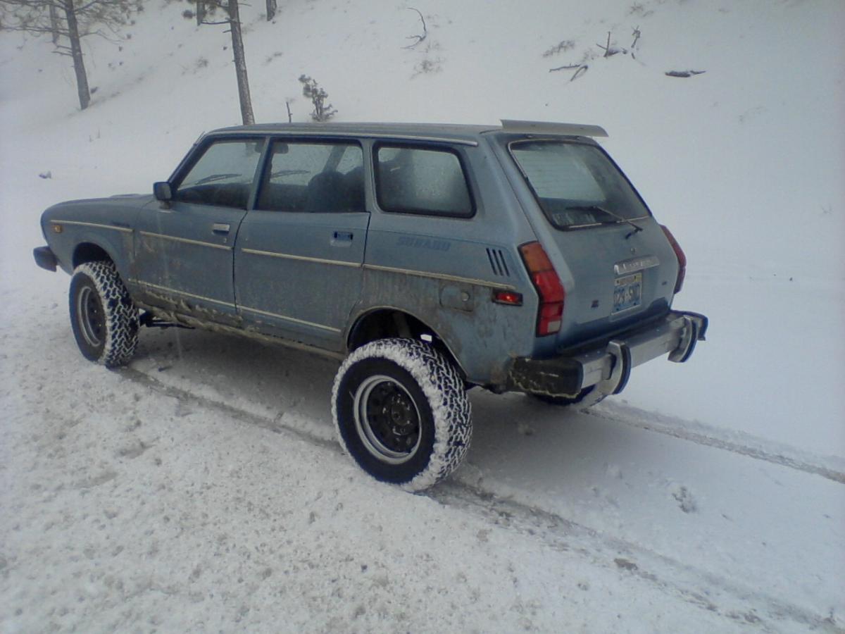

bertmann73 Posted August 22, 2013 Share Posted August 22, 2013 converted from 2wd ea71 to 4wd ea81 dual range 4wd Specs ea81 with ea71 .025 ITM pistons self ground cam self ported heads 84 brat rear differential assembly custom fitted for 5" lift weber carb with self ported intake Front clip modified to fit larger nissan truck radiator Oil cooling system fabricated from parts laying around relocated oil filter extended front struts and 4 inch undercarriage lift. 84 brat front axels and tie rods with self extended controlarms 4 Link to comment Share on other sites More sharing options...

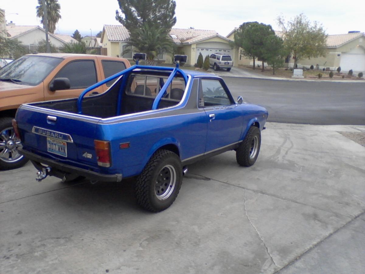

bertmann73 Posted August 23, 2013 Author Share Posted August 23, 2013 this was my first back in 09 i ran the ea 71 until i blew a head gasket. i tried to get the bolt out of the block to resurface it but some knucklehead put the blue lock-tite and i snapped 2 bolts trying to remove. i had a machine shop drill and helicoil but the threads never took tourque. I finally re-drilled and tapped a larger bolt then drilled and tapped the cut off bolt and it held tourque. after finishing the engine and having fu i blew the tranny. I replaced all with an ea81 dual range set up. I painted it with rattle can and lifted it 3" It is now sitting waiting for my son to turn 18 since ther are very little brats in the desert it gets alot of attention I was in arizona visiting an a good ol boy at a gas station said " Is at one dem der cars dat goes in da worter?" If you have any red neck in you you will understand that. Link to comment Share on other sites More sharing options...

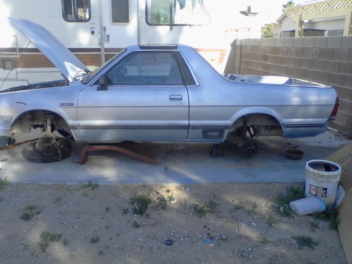

bertmann73 Posted August 23, 2013 Author Share Posted August 23, 2013 Any way , here are the rear end mods Donor car 84 brat Link to comment Share on other sites More sharing options...
bertmann73 Posted August 23, 2013 Author Share Posted August 23, 2013 rear end removed and washed. brackets fabricated from flat bar Link to comment Share on other sites More sharing options...

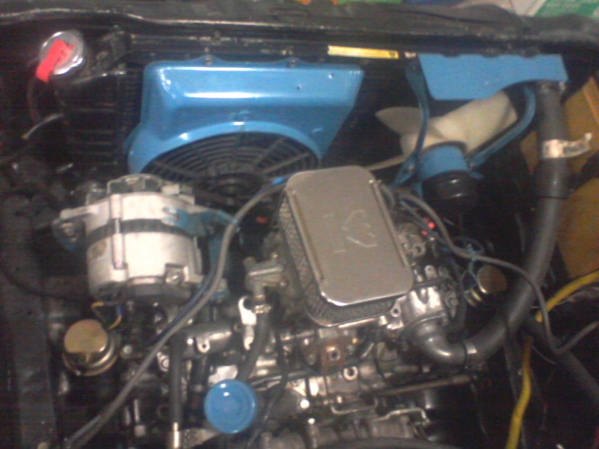

bertmann73 Posted August 23, 2013 Author Share Posted August 23, 2013 porting the intake is finding your favorite abrasive tool and removing whatever metal you can. In my case i used a 5" 5/15 bolt and rounded the head with my grinder. i then scored it with a cut-off blade to give it some sharp ridges. It worked fine to remove alot of material. I did this with the adaptor plate installed to ge na even flow from the weber sown to the ports. same with the heads. i did not get them polished as i do not have the funds but she does breath alot better and picks up the 26" tires just fine. The oil filter relocation is a result of me looking into kits and saying to myself - I can make that the cooler is off a wrecked suzuki 1100 crotch rocket. it has 1/2 inch lines and is relatively small yet has a large cooling capacity. i took an old ea81 oil pump and hacked off the mount ring before the pump. then i tapped it aninserted fittings, made a bracket and mounted it to the frame. on another oil pump i tookan A/c nut that fit the filter threads and welded a fitting to it. then tapped and fitted the outer ring hole. Basically my lines run from the pump to a sttelite oil filter, cooler then back to the pump. the cooler allows for a thinner oil such as a 5-30 synthetic blend as thicker oil creates alot of oil pressure and power loss 1 Link to comment Share on other sites More sharing options...

bertmann73 Posted March 12, 2014 Author Share Posted March 12, 2014 for those who have not seen the posts in members rides here is an update on my wagon....had a rod bearing go on my way to arizona about 8 months ago so i cannibalized the brat to keep it going for a while. just got the rebuild finished and tuned. when i tore it down i found all the bearings good besides the rod bearing that gave out. either a bad bearing or a bad grind..i'm guessing bad grind. I found a virgin ea81 from a guy that has a connection in Utah. he brought it down and let me have it for 100 bones. he said he had it running and it smoked.......plugs were gas fouled and oil wreaked of old gas. my guess was carb problems. gas getting into the crank case and thinning out the oil = bad ring mis-diagnosis. I was right. i took the crank, rods and flywheel and incorporated them into my already built engine that broke down...just polished the crank journals and de-glazed the cylinders as the bearing had left its mark in two of them. this engine has some power and i need to hold back alot so i dont blow it up again. the donor engine is prestine and will be built as soon as i find a new set of pistons. i was running the engine out of my sons 78 brat and it was tired and beginning to tap out therefore i could not have gotten it done any sooner. i plan on marrying the crank shaft with the donor engine cuz the old engine has a bad rear engine bolt thread and i had to score the threads of an over-sized bolt and tap it in to avoid taking her apart to heli-coil the hole...held pretty good though. next step is paint..gonna do matte blue with flat black striping and decal matching the original white decals...love the subaru decals on the back quarter. anyway best wishes to all and thanks for always being here. Link to comment Share on other sites More sharing options...
