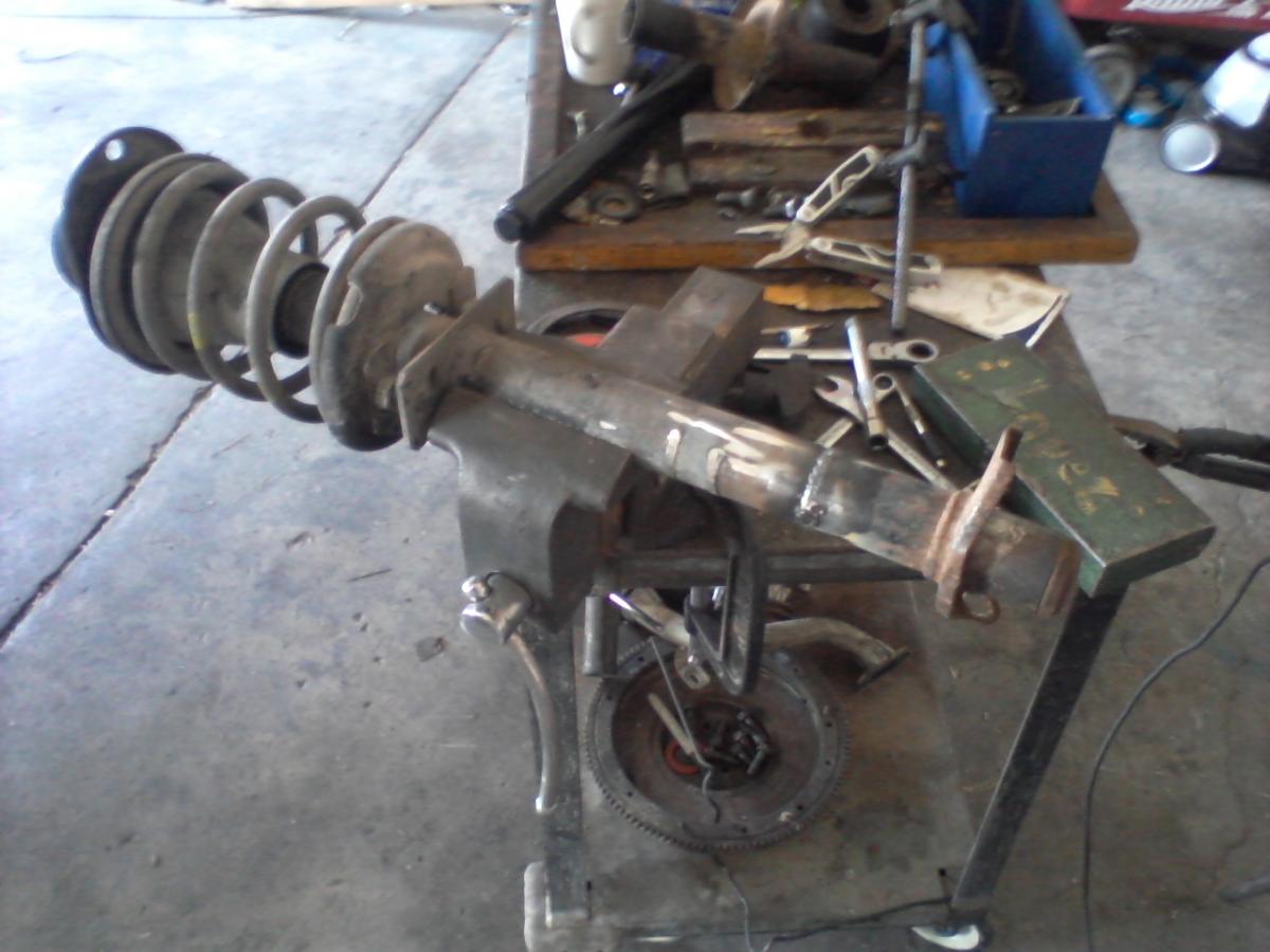

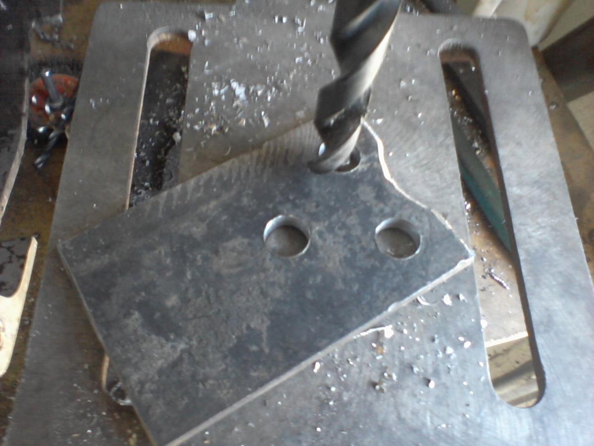

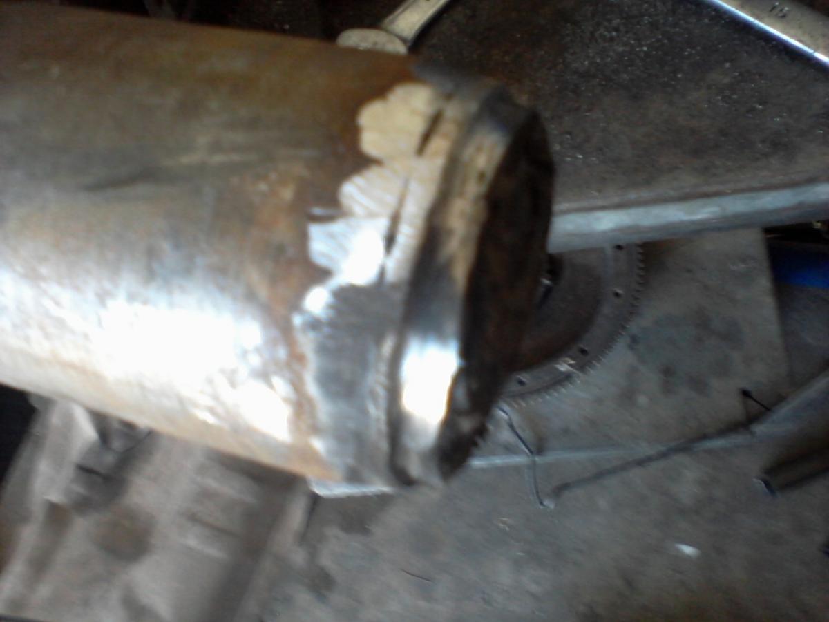

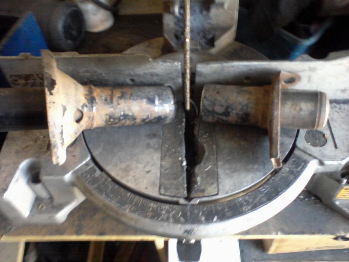

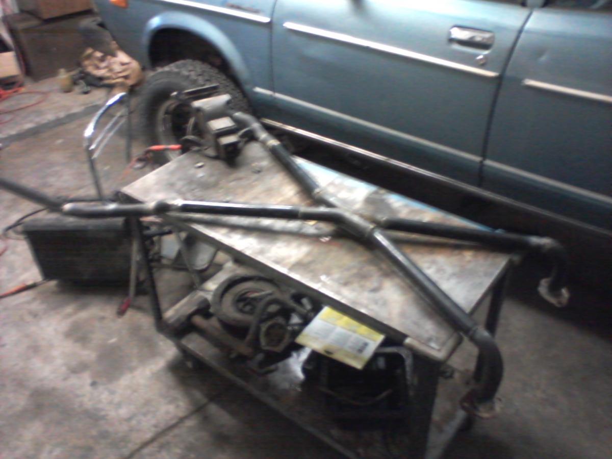

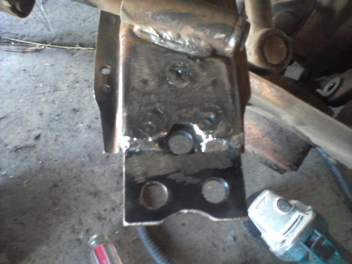

bertmann73 Posted August 24, 2013 Share Posted August 24, 2013 front end mods 5" of the stock strut casing butted to the 84 brat struts grinded a ridge to fit the bottom end cap three stage weld and grind to widen the control arm i cut, grinded and drilled 3/8 flat bar and welded to the end of the control arm. I used 84 axels and tie rod ends exhaust is made from an old hedder that i replaced on my 62 chev. used the elbows for the 2 hedders and welded together 2 more in the center for an x pipe. used a cherry bomb that i had and cut it in half then buuted the ends...not as loud as i thought it would be but sound sick. 1 Quote Link to comment Share on other sites More sharing options...

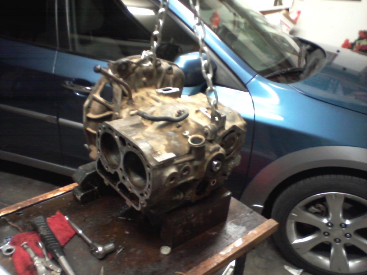

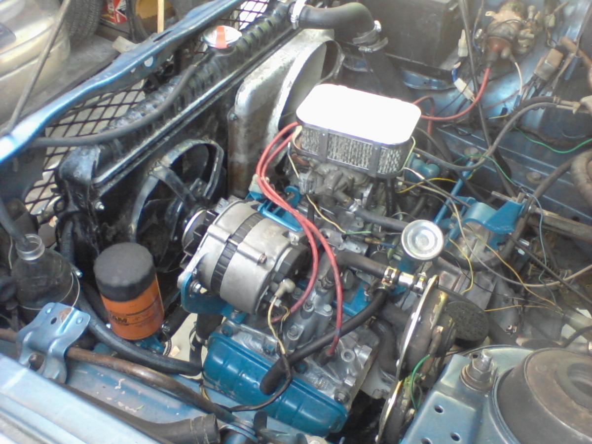

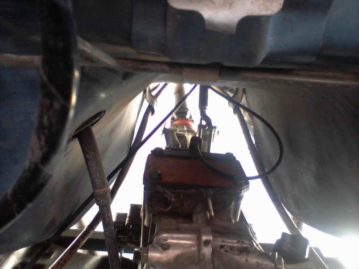

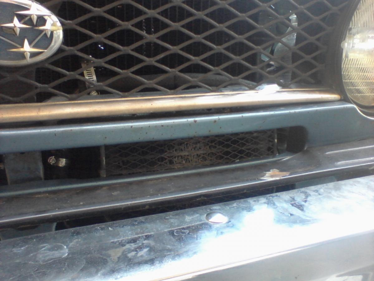

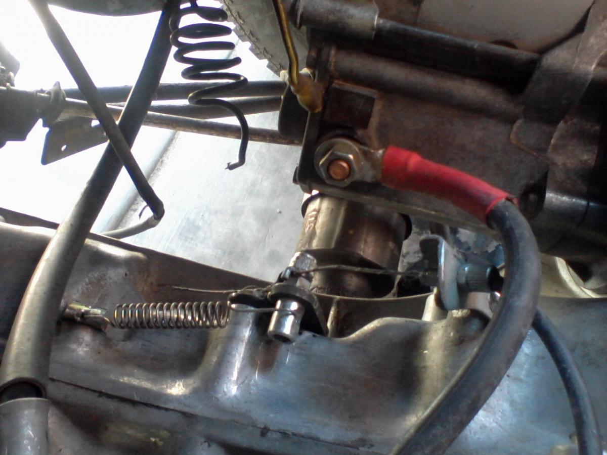

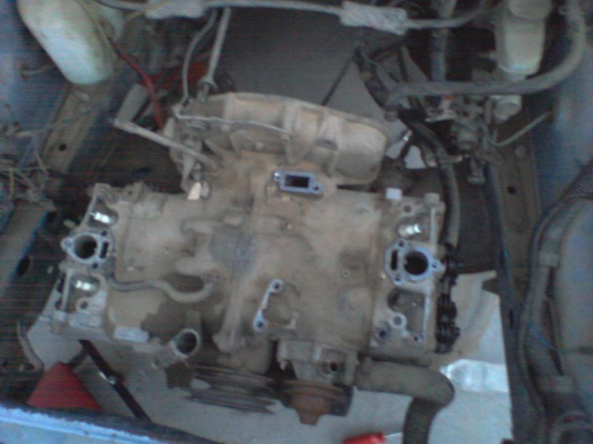

bertmann73 Posted August 24, 2013 Author Share Posted August 24, 2013 The engine this is my red neck wrist pin puller (Claw hammer and wood block sold seperately) had crank ground .025 block bored .025 for ea71 pistons I gound the cam journals 1mm on my bench grinder..........oh so slowly and carefully...... block cleaned and heads milled nissan truck radiator Oil Cooling system Cable operated 4wd and low (dint want to cut a shifter hole and now i can use low without 4wd engaged) 2 Quote Link to comment Share on other sites More sharing options...

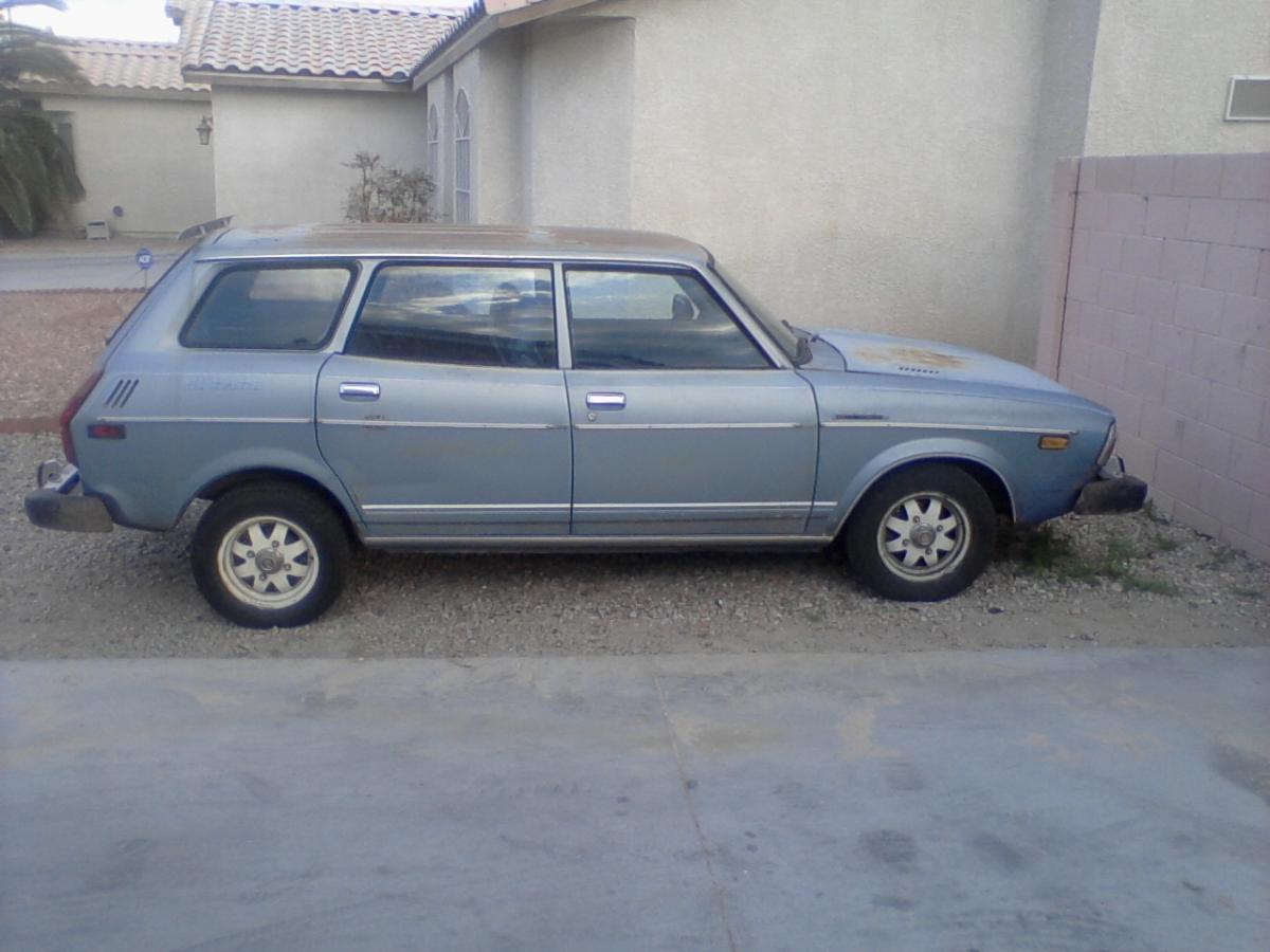

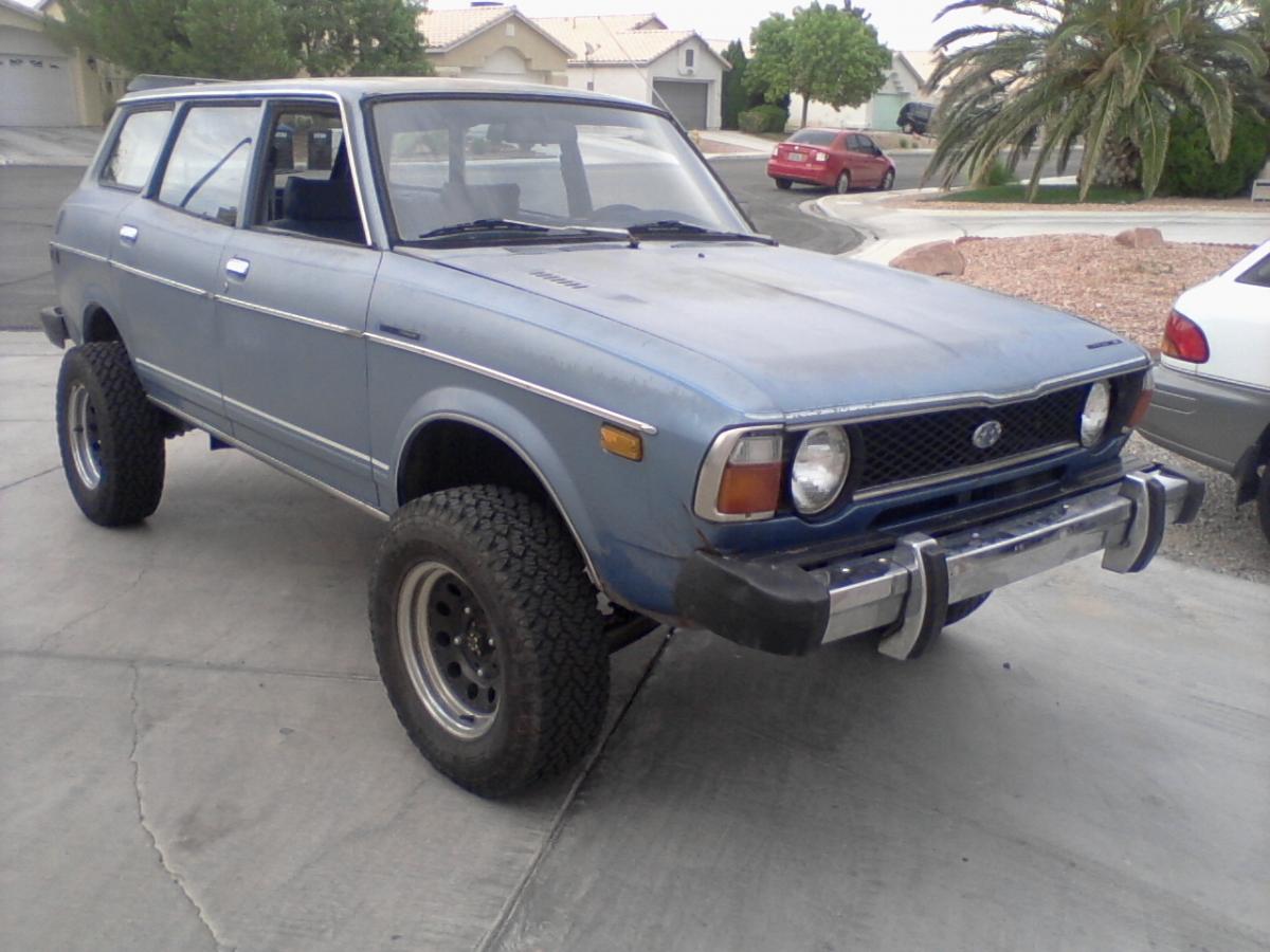

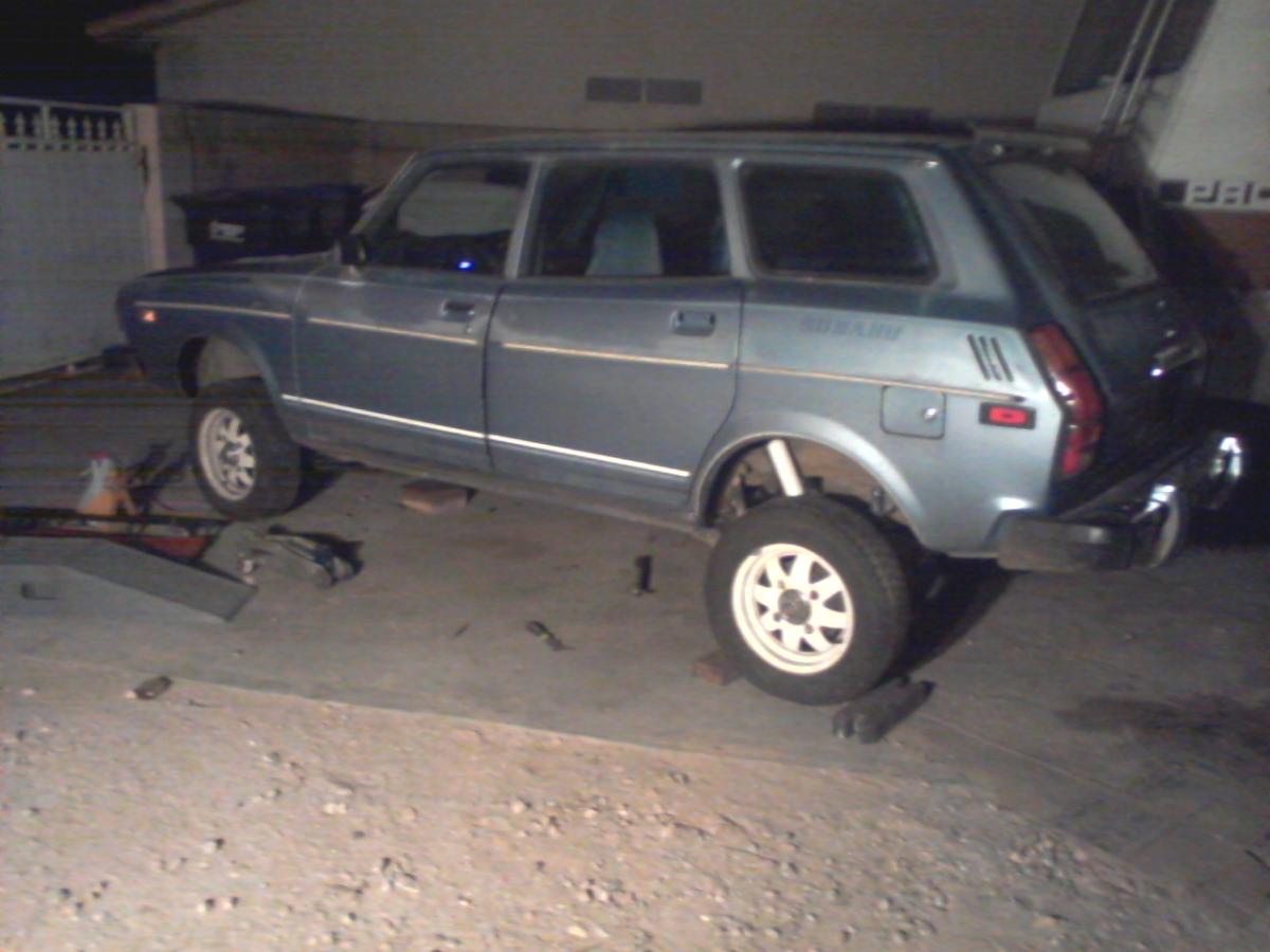

bertmann73 Posted August 24, 2013 Author Share Posted August 24, 2013 Before and after need paint...I am thinking of a matte blue similar to the original color....just dont want to worry about scratches as i am on an off road trek. looking into some tires for the original wheels as i do like the look so much better and stick out about an inch due to new undercarriage. I see alot of all seasons on e-bay that have a rugged tread pattern. 1 Quote Link to comment Share on other sites More sharing options...
snofool Posted August 25, 2013 Share Posted August 25, 2013 lookin' good! I like the stance with the general grabbers. Looks so much different (better) than stock. Quote Link to comment Share on other sites More sharing options...
bertmann73 Posted August 25, 2013 Author Share Posted August 25, 2013 the tires are actually off the brat and they belong to my son now. I am probably going to use the stocks or find some 15" white spokes to drill out. Quote Link to comment Share on other sites More sharing options...

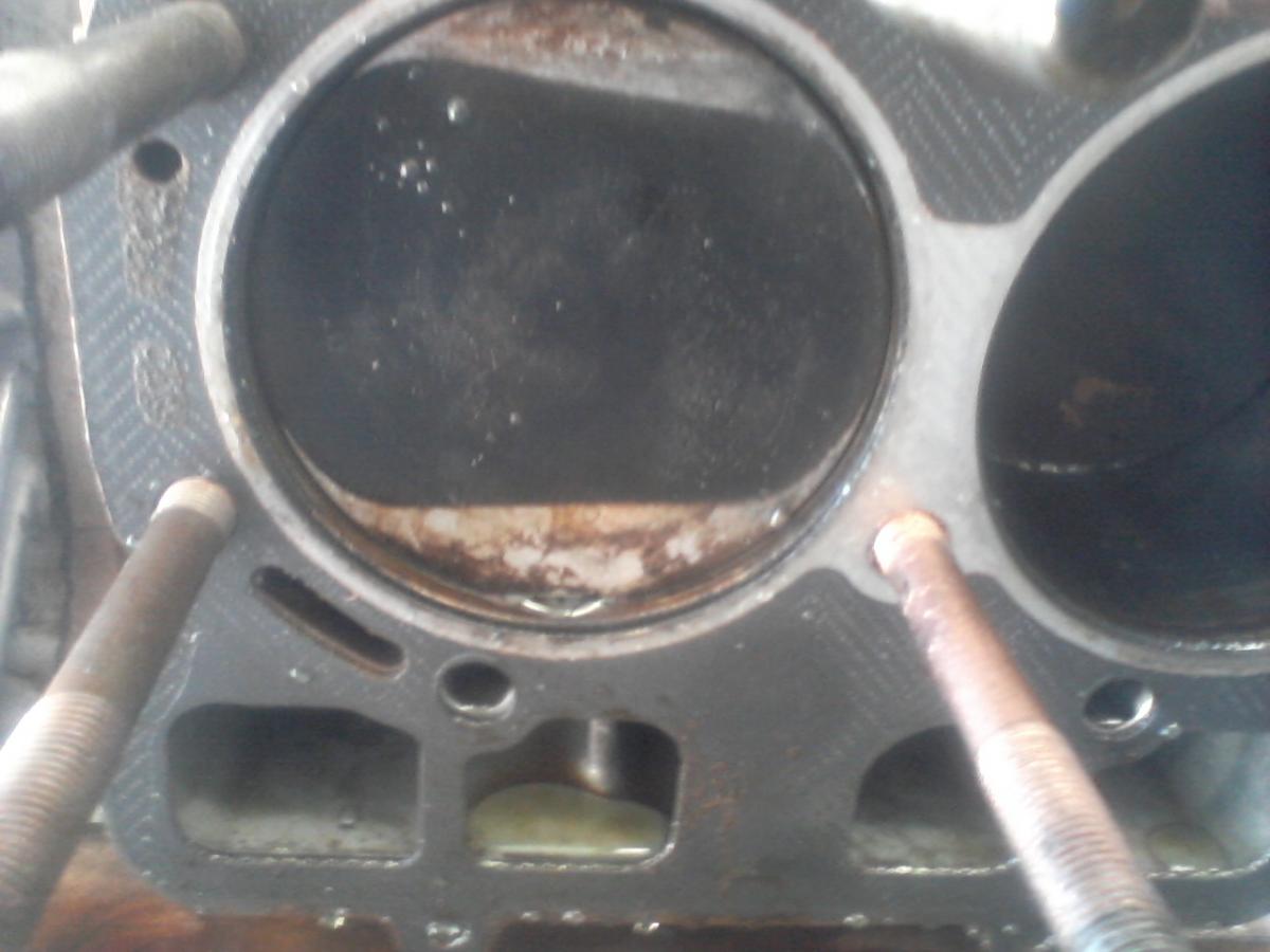

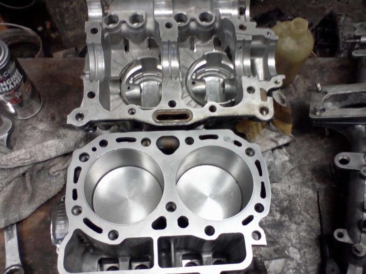

bertmann73 Posted September 20, 2013 Author Share Posted September 20, 2013 Where i grew up it was find a way to fix it without spenging any money or walk. just pulled the engine out, popped the heads and found number three piston like this.. popped out the piston and rod . bearing is simply gone rod is beat up and crank too. i have a spare crank that i will polish and i also have 2 sets of std rod bearings. just need main bearings. i saw a set on e-bay for $40 anyone know a better place to look for a better price? Quote Link to comment Share on other sites More sharing options...
bertmann73 Posted September 23, 2013 Author Share Posted September 23, 2013 in need of a crank for an ea81. my spare is beat up upon closer inspection. i may have to use the engine from the 78 and re-build another for it later..............not looking forward to taking anything off of a good runnin car.... Quote Link to comment Share on other sites More sharing options...

bertmann73 Posted February 28, 2014 Author Share Posted February 28, 2014 sorry gang.. been busy goin to school and workin. Ive been runnin the engine from the brat for a few months to get by but shes tired and ready for a re-build. I just found an engine for 100...guy had it for years and said it was smoking blue when he removed it. when i got it home i noticed it wreaked of old gas in the crank case. pulled plugs and found gas fouled plugs. i tore it down and found good rings and bearings with normal wear and cylinder walls lightly scratched.. my thoughts are carb was flooding out into crank case causing oil to thin and level to rise and get pass rings.........the usual misdiagnosis of bad rings. I could have run it a s is and got 5 years out of it but i already had my other case bored with ea71 .20 pistons, ported heads and intake and cam ground so i ripped out the crank and replaced the rod and main bearings for my custom built engine. i just got done torquing the heads and will adjust valves to transplant tomorrow. then i will start tearing down my sons engine to get his brat tickin again. i have an original equipment single bbll holley? i assume for grabs if anyone needs it....or if anyone still tolerates these. i can see the intake on this engine is different than the hitachi equipped intakes...havent dealt with these yet..anyone got any pros or cons to these carbs? Quote Link to comment Share on other sites More sharing options...
RustyBrat Posted February 28, 2014 Share Posted February 28, 2014 Im going to be widening my control arms in the same way, but i wanted to know first if you have had any problems with it? Quote Link to comment Share on other sites More sharing options...
bertmann73 Posted March 1, 2014 Author Share Posted March 1, 2014 you will need cv axles and tie rod ends from a gen 2. be shure the axles have the deep sleeves that go on your trans-axle as some are the shallow ones. this will give your axles more travel and prevent them from popping out. if you can find gen 2 hubs that are 1/2 inch wider also. you will get 3.5 - 4 inches total added width. make sure you measure 1.5'' for your extension on the control arms cuz the actual difference between gen1 and 2 is 3". you will also need to extend the struts or strut mounts in one way or another to compensate.. not sure what the measurement is cuz i did a lift and used gen2 struts with butted bottom cases for 5" total strut lift then used the adjusting nuts on the gen2 struts to get alignment camber. in a nut shell its an insane persons thing to do cuz you must commit yourself but it worked great and runs pretty straight. Quote Link to comment Share on other sites More sharing options...
RustyBrat Posted March 1, 2014 Share Posted March 1, 2014 oooohhhh... well... never mind then... thank you for the info, but i was hoping it wouldnt be that much work! i just want to correct my camber, cant seem to do it no matter what i try Quote Link to comment Share on other sites More sharing options...
bertmann73 Posted March 2, 2014 Author Share Posted March 2, 2014 its not that hard really..just a bit of madness to think of how to do it on my part without buying kits and costly stuff. the only thing to fabricate is the control arm extensions...all else is bolt on and you will just need to get 2 cv axles and tie rod ends whether at the junk yard or e-bay where i get all my parts now..i think you already have some sort of strut lift going on which is the cause of your camber issue..this will definitely fix it and i would be happy as a tornado in a trailer park to see someone else do it too. best wishes. Quote Link to comment Share on other sites More sharing options...

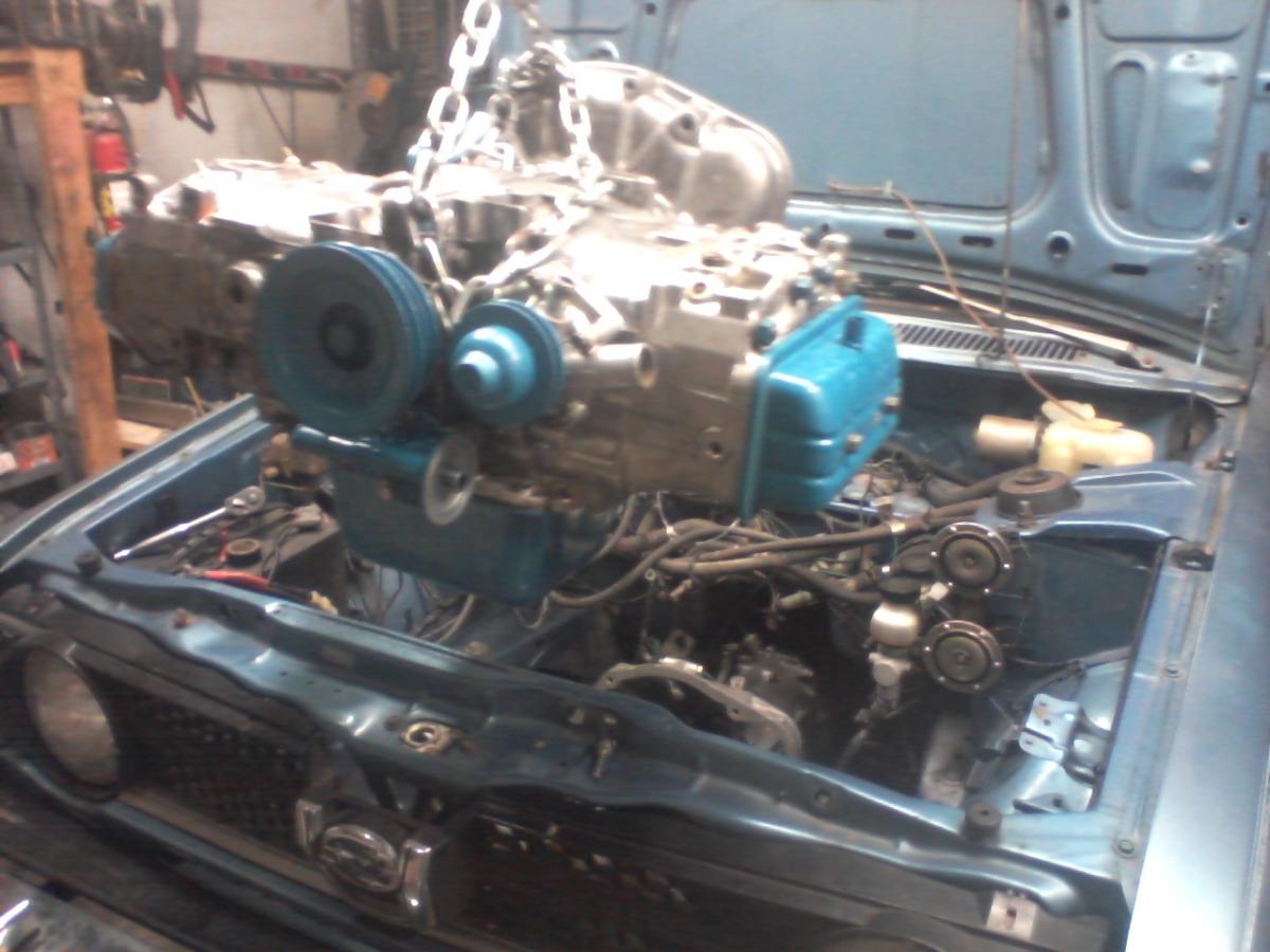

bertmann73 Posted March 2, 2014 Author Share Posted March 2, 2014 Anyhoo...my engine has been re-built and put back..it took me a couple of days to de-glaze and clean but the re-build went fast except for dropping the last wrist pin circlip inside the block..then having to pop the piston back out and shake a 200 pound piggybank for a half hour until it finally fell back out but i did the swap in all of 5 hours and had her fired up before dinner.....purrs like kitty 1 Quote Link to comment Share on other sites More sharing options...
