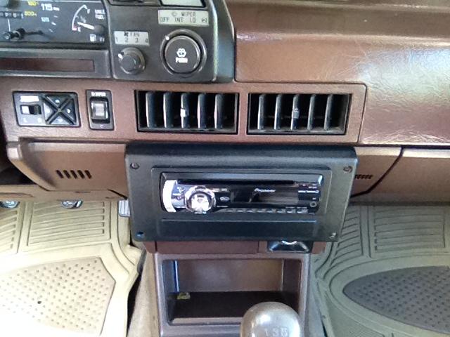

rrgrr Posted September 20, 2014 Author Share Posted September 20, 2014 (edited) Now for some fun stuff! Been messing with this radio dilemma for awhile...cassette adapters, transmitters, wires everywhere, noise... Check this out This cheapie 7" tablet fits perfectly between the dash and shifter box, seated against the cubby. It easily slides in/out from either side and needs no adhesive. Has micro sd to hold plenty of music, maps, and I can stop a wifi spots when I need online! After so much screwing around, I was going to do the Mighty Car Mods tablet install and call it a day, but it needed an amp, and sacrificed local radio, which is useful at times. But I came up with something that keeps the stock look and does it all. Searching around the forum, I found some ideas. First, I hacked the stock radio harness that connects the radio to the tape deck and wired in this switching plug to receive signal from an aux source: If I tune to 'quiet' frequency and turn the device voulme up, there is no significant noise. Worked well enough, but if I tried to charge it while the motor was running, it was crazy noisy... I finally found this little ground loop eliminator and it did the trick! Here you can see I've glued the switchplug to the side of the radio, and everything stuffs into the space beside the radio. I am going to put a usb charging plug in there, too. Both wires route neatly between the dash sections. Also,my door speaker were crapped out so I tapped into the b pillar connection and put in these ancient Pioneer triax car boxes I've had forever - sounds pretty awesome! Edited September 20, 2014 by rrgrr Link to comment Share on other sites More sharing options...

Dinky26 Posted September 20, 2014 Share Posted September 20, 2014 (edited) So what color is the backlight on the unit you have in your dash? That was not the unit that mine came with, it was more antiquated than that. I thought I might still have that unit, nope sure don't I'm thinking it was amber, long gone now though I sure do miss that layout of dash and ect. Makes me very :( Edited September 20, 2014 by Dinky26 Link to comment Share on other sites More sharing options...
rrgrr Posted September 20, 2014 Author Share Posted September 20, 2014 On 9/20/2014 at 8:30 PM, Dinky26 said: So what color is the backlight on the unit you have in your dash? That was not the unit that mine came with, it was more antiquated than that. I thought I might still have that unit, nope sure don't I'm thinking it was amber, long gone now though I sure do miss that layout of dash and ect. Makes me very :( This one is green -it really looks funny trying to be stock against the rest of my amber-lit dash. Please check out my parts wanted thread:http://www.ultimatesubaru.org/forum/topic/148940-amber-alert/ Link to comment Share on other sites More sharing options...
Mykeys Toy Posted September 20, 2014 Share Posted September 20, 2014 For your noise aside from the ground loop eliminator check the little resistor on your coil to see if it is good. Also upgrade the grounds or at least clean up the contacts from the battery to the block and body. That is the number one cause of ground loop/ alternator noise. Sorry I am still a stereo nut and old habits die hard. Link to comment Share on other sites More sharing options...
rrgrr Posted September 21, 2014 Author Share Posted September 21, 2014 MyKeys, thanks for the tip! I think the loop was occurring thru the radio amp somehow, -the switchplug made the radio slightly quieter left plugged in w/ no input. I tried adding a direct ground to the charger before, and some weird things were happening -and it was still noisy. The radio is good and quiet itself, so I guess the resistor is good, etc. Link to comment Share on other sites More sharing options...

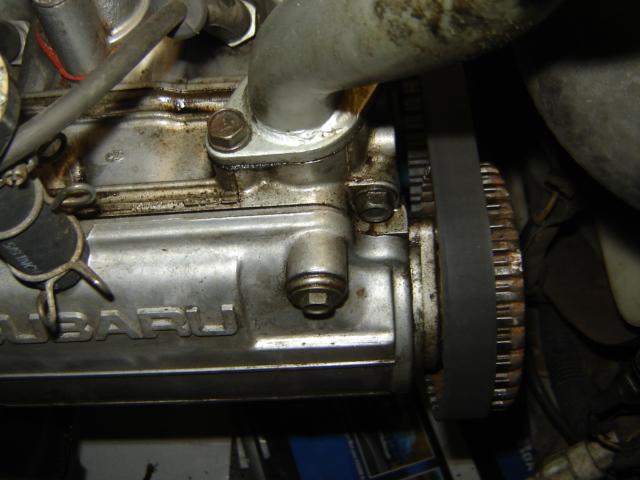

rrgrr Posted September 8, 2015 Author Share Posted September 8, 2015 Here's what I have done since last update-(besides a lot of miles) In January I replaced the rear shocks, seems much better now -had to chase threads on one hole that got crossed somehow Changed a rear axle that came apart -I could hardly tell. Still chasing a chirpy sound at exactly 59 mph -guess it's either a unbalanced tire or a bearing. Couple weeks ago I was swapping carbs and choke linkage, trying to get a working choke...the car started running really poorly -finally realized my fuel pump was not running. Went ahead and replaced it with one I had -still getting no power! Could not figure out the relay thingy and had to run a new keyed hot wire to it. Not a perfect solution. Choke is working well now and tune is good. Forgot to mention the time about a month ago, on the highway when I got up to 65 or so -the cruise control kicked in for no reason! It would not turn off by either pedal or switch! Luckily my exit was near and I could coast off. Stopped immediately and disconnected the vacuum ball. Still a mystery. Picture time -Finally got my cruddy old headliner out and recovered it with some tweedy fabric I found awhile back. It kind of matches the door panels/seats. Check out this nasty thing -it was in worse condition than any part of the car somehow I'v never done this before, and it was about 95 degrees out -but it came out pretty good Link to comment Share on other sites More sharing options...
rrgrr Posted November 4, 2015 Author Share Posted November 4, 2015 (edited) Haven't had to do much lately, just watching the latest cv boot split again and spin grease all over again, (sigh)...My oil leak was really getting messy, so I went at the oil pan Again, chased the threads while I had it off, used Right Stuff -no gasket (Thank you to whomever recommended that!) Lo and behold it is dry now!! Finally after thinking I had exhaust leaking -it was dripping on the pipe,burning... The downside is I noticed one of the bolts at the rear was not seated fully -and went ahead and broke that off trying to get it... ...Oh well it is not leaking and hopefully it will stay that way. Edited November 4, 2015 by rrgrr Link to comment Share on other sites More sharing options...
