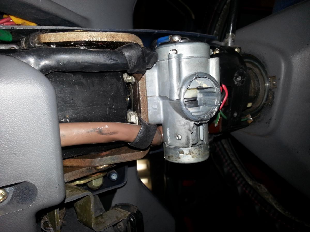

Dinky26 Posted September 19, 2013 Author Share Posted September 19, 2013 So I pulled the ignition apart tonight. Stuck a flat head in the switch part and turned it and it fired right off. Put it back together and it seems to be starting fairly consistently right so far. Looking at the bottom of the lock I'm thinking the lock part really needs changed, will try to include picture. Link to comment Share on other sites More sharing options...
Dinky26 Posted September 19, 2013 Author Share Posted September 19, 2013 I can only get this on pic to go, but you notice the cut out in the bottom of the lock and off to the side where the key is inserted. Link to comment Share on other sites More sharing options...
Cougar Posted September 20, 2013 Share Posted September 20, 2013 That looks like it needs to replaced alright. Link to comment Share on other sites More sharing options...
