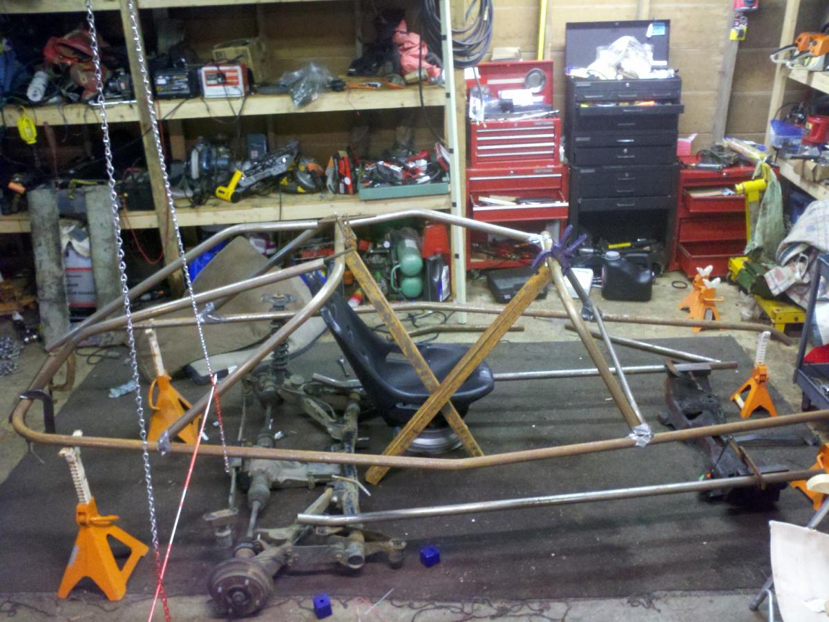

apintonut Posted September 19, 2013 Share Posted September 19, 2013 (edited) Im building one right now to my best guess is im going to be 900-1100 lb my frame is only about 150 lb. I could probly save wieght buy spending more money but im trying to keep the price under 500$ if you built your own suspension and i think legacy would be easyer than ea82 Edited September 19, 2013 by apintonut Quote Link to comment Share on other sites More sharing options...
