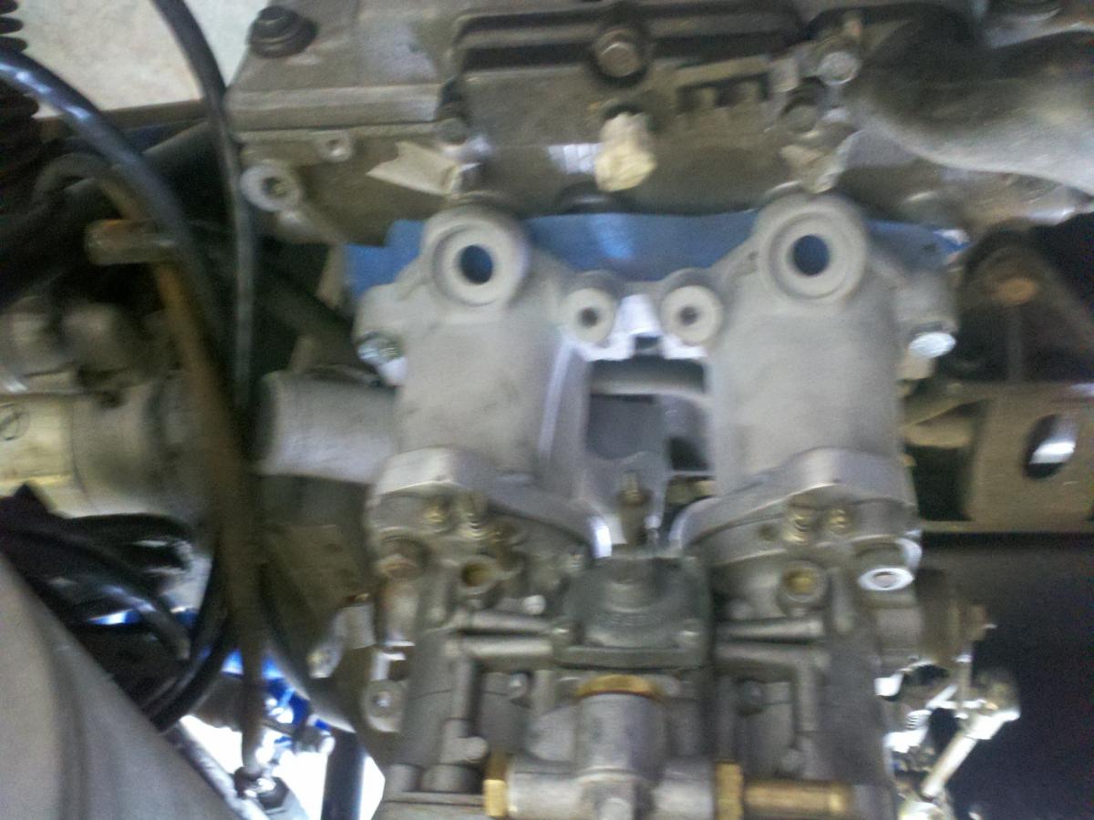

TOONGA Posted September 19, 2013 Share Posted September 19, 2013 Check my thread on AUsubaru http://www.ausubaru.com/forum/showthread.php?t=15851&page=24 I have an ADM34 (ford weber) on an EJ22 it is a progressive 34mm twin barrel rejetted with a 130 main and 135 secondary (I think) with 50 idle jets. I did use a 32/36 weber for quite a while but foud it lacked low down power when i went off road. The manifold is from an EJ16 motor http://www.ausubaru.com/forum/showpost.php?p=141108&postcount=18 the plenum was cut flat and an adaptor plate was welded in place, I originally had a 320 holley on the motor but it was way too rich and well a holley I use a lucas dizzy and matched coil (very important) from a ford escort as it is way shorter than the MK3 dizzy for ignition http://www.ausubaru.com/forum/showpost.php?p=169848&postcount=627 I get 8 litres to 100kms on the highway 10 to the 100 in town and lots and lots of power off road Good luck with it TOONGA Link to comment Share on other sites More sharing options...

TOONGA Posted September 21, 2013 Share Posted September 21, 2013 Phiz the holley was a 350 and even though I rebuilt it and re jetted it to suit the motor, it would flood off idle then when it finally ran it was all power and no controlability. I even had a whole array of cams for the acelerator pump but none made a difference. If you can find a SPFI or carby manifold like the one shown here http://www.ultimatesubaru.org/forum/topic/108209-ej-fsm-carb-info/?do=findComment&comment=912770 (get me one as well) it will go a long way to lowering the profile of the whole set up. your other alternative is a custom manifold. TOONGA Link to comment Share on other sites More sharing options...
