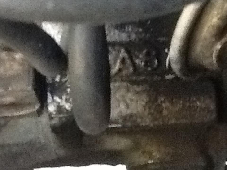

Loyale 2.7 Turbo Posted September 23, 2013 Share Posted September 23, 2013 Thanks for Sharing those Photos. The engine is Not an EA82, it could be an EA81 (1.8L) or an EA71 (1.6L) If you wanna be Sure, look at the engine Block, Below the Carb & intake, There should be the Engine's name Emblazoned. To gain more power To move those massive tires on that Subie, I Suggest to do the Famous "EJ Swap" Kind Regards. Link to comment Share on other sites More sharing options...

Uberoo Posted September 23, 2013 Share Posted September 23, 2013 I'm guessing you have a "fat case" EA71 engine paired with a single range 4x4 transmission.If the car came with a EA81 your car would already have the 4 speed dual range 4x4 transmission.On the block near the front of the engine on the passenger side should be a stamped tag that will tell you what the engine is, IE EA71,EA81.. So the first thing you can do is swap in a dual range 4 speed transmission,It has a low range gearset that will help turn those tires.It will just bolt right in. Another thing you can do is swap in an EA81 engine and 4 speed dual range transmission.If you indeed have an EA71 swapping in a EA81 will give you 10-20 HP,that with the low range gearing will make it almost a completely different vehicle. Just check that tag on the front of the engine before you get a new engine. Finally you can swap in a 5 speed DR from a EA82(OHC).It is stronger than the 4 speed and weighs less,It also has a lower low range (1.46 VS 1.59) and has an extra gear.It requires the EA82 flywheel and starter and clutch assembly.That flywheel is slightly larger than a EA81 flywheel so the engine side of the bellhousing needs to be trimmed slightly to give clearance,put the Ea82 flywheel up to the EA81 engine and you see where you need to grind. Other than that it bolts up to the engine,the transmission mount is different and will need to be modified. Link to comment Share on other sites More sharing options...

Gloyale Posted September 23, 2013 Share Posted September 23, 2013 We'll thanks. Uber. Turns out its a an ea81. So maybe it's on its 2nd transmission? The body style is considered "ea81" unofficially anyhow, since most of these era cars came with that engine when the body was introduced. BUT, the "DL" or base model hatches, While called an "EA81 Hatch" body type, used a EA71 engine, with a single range 4wd. This is the "fatcase" EA71....which other than stroke is about identical to the EA81 so you may need to order somethings like Oilpump/seals and belts and such as if it was an EA81. Tell you what, look at the top/front of the engine, just below the Distributor. There will be a stamping on the bolck that says either "EA71" or "EA81" This will tell you for sure. But to me it's doubtful someone would have swapped "in" a single range trans......ussually the opposite is the case. So it would make the most sense that the car started life as a 1600, single range "standard". Either way, you can upgrade to a dual range 4spd or 5spd. I believe (not entirely sure) though you're flywheel will be too small(200mm/ 7-7/8") for either dual range clutch setups'(225mm/ 8-7/8"), so you;ll need a flywheel and clutch too. Link to comment Share on other sites More sharing options...
Loyale 2.7 Turbo Posted September 23, 2013 Share Posted September 23, 2013 As some of us already asked you... ... look at the engine Block, Below the Carb & intake, There should be the Engine's name Emblazoned ... ... look at the top/front of the engine, just below the Distributor. There will be a stamping on the bolck that says either "EA71" or "EA81" This will tell you for sure. ... ...Why don't you post a Photo of said area of the engine's Block and let us be completely Sure about what kind of Engine your Subie has? Also, I'll Like to Know how did you installed such big Rims & Tires there, any Photos and Details? Kind Regards. Link to comment Share on other sites More sharing options...
PA Grown Posted September 24, 2013 Author Share Posted September 24, 2013 Lol alright it says ea81 Link to comment Share on other sites More sharing options...

PA Grown Posted September 24, 2013 Author Share Posted September 24, 2013 And just tell me if it's not clear enough. Engine was hot I didn't wanna wipe the grit off it Link to comment Share on other sites More sharing options...
