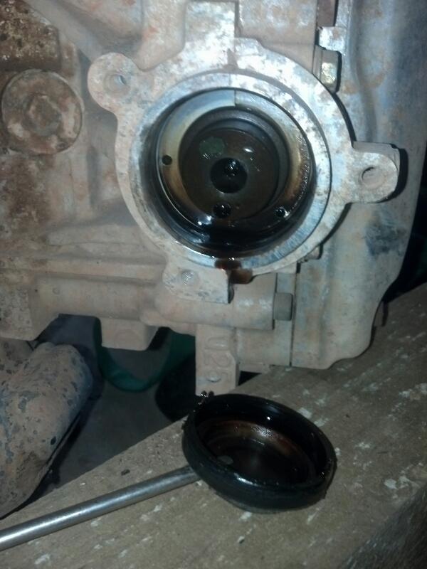

Phizinza Posted October 18, 2013 Author Share Posted October 18, 2013 Here's a photo. I just punched a screw driver through the cap and levered it out. Looks like a disty could be mounted if i slot the cam and make an adapter from those 3 bolts Link to comment Share on other sites More sharing options...
ivans imports Posted October 18, 2013 Share Posted October 18, 2013 just seperate the two halfs of head and pull it out is a good time to clean and inspect cam and rockers ect and reglue the head seam as they like to leak there Link to comment Share on other sites More sharing options...
