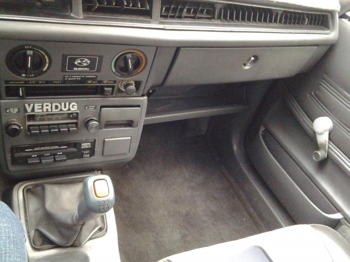

Mundog64 Posted January 4, 2014 Author Share Posted January 4, 2014 Dash and interior pic Quote Link to comment Share on other sites More sharing options...

turbosubarubrat Posted January 4, 2014 Share Posted January 4, 2014 Go under and see if it has a drive line if it does its 4wd. I'm guessing it is because it has a push button for it on the shifter off a 85 and up dl or loyale. 1 Quote Link to comment Share on other sites More sharing options...
Mundog64 Posted January 4, 2014 Author Share Posted January 4, 2014 Nothing fancy Quote Link to comment Share on other sites More sharing options...
Mundog64 Posted January 4, 2014 Author Share Posted January 4, 2014 Go under and see if it has a drive line if it does its 4wd. I'm guessing it is because it has a push button for it on the shifter off a 85 and up dl or loyale. The driveline is there but theres a cable with a diaphram looking part in the engine compartment just zip tied disconnected that may be why its not engaging in 4wd. Appreciate the comment Turbosubarubrat Quote Link to comment Share on other sites More sharing options...

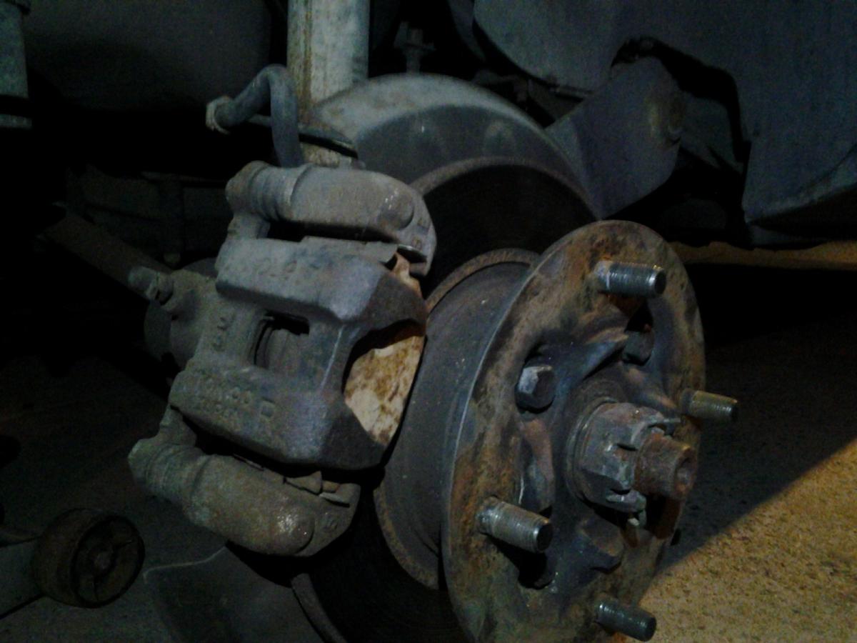

Mundog64 Posted January 22, 2014 Author Share Posted January 22, 2014 My temporary permit expires 1-31 so Ca emissions and my ecs light issues are pretty high on the priority list of repairs. Im hoping the ecs light resolves the ca emissions issue. I had the opportunity to verify the mpg while driving to and from Disneyland via all highway and came up with 24.4 mpg. I thought it was great considering its in default mode. Oh, can anyone identify my rear brake set up? Please. I priced brake pads and was told that my 1985 Brat should have drums not disc. Quote Link to comment Share on other sites More sharing options...

Mundog64 Posted January 24, 2014 Author Share Posted January 24, 2014 My temporary permit expires 1-31 so Ca emissions and my ecs light issues are pretty high on the priority list of repairs. Im hoping the ecs light resolves the ca emissions issue. I had the opportunity to verify the mpg while driving to and from Disneyland via all highway and came up with 24.4 mpg. I thought it was great considering its in default mode. Oh, can anyone identify my rear brake set up? Please. I priced brake pads and was told that my 1985 Brat should have drums not disc.20140120_223731.jpg sorry to press guys and gals. i'm trying to buy brake pads for the rear of my brat and need your help identifying the year make and model they are from. thanks in advance ray Quote Link to comment Share on other sites More sharing options...
suba258k Posted January 25, 2014 Share Posted January 25, 2014 I have 1986 Subaru BRAT. I swapped to rear discs brake from drums brake in few years ago. I know disc and pads brakes from 1988 Subaru GL-10. 1 Quote Link to comment Share on other sites More sharing options...
turbosubarubrat Posted January 25, 2014 Share Posted January 25, 2014 Glad i could help. You can see the speedometer cable on the transmission on the left in the pic above wrapped around in the middle. This is the same transmission you have too. The end of the cable has a bolt shape to it so you use a wrench or a pair of vise grips to unscrew it, but first you need to pull the rest out from under the dash through the fire wall. The rear disk pads could be off anything with a ea82t (ea82 turbo/1800 turbo) 85-94 so gl-10, rx, loyale and possibly some xt or xt-6(not positive on those) some non-turbos had them but its just easier to say 88 gl-10 like the other poster said since they will find it easier at the parts storehttp://www.napaonline.com/Catalog/Result.aspx?Ntt%3drear%2bpads%26Ntk%3dKeyword%26Nty%3d1%26N%3d599001%2b101987%2b50068%2b2068009. Quote Link to comment Share on other sites More sharing options...
