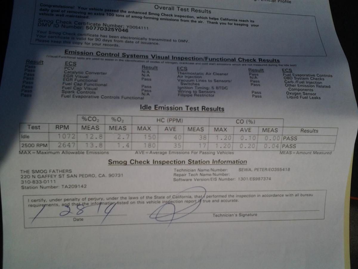

Mundog64 Posted January 28, 2014 Author Share Posted January 28, 2014 10-4 on the speedo cable details. Thanks fellows. Ill go with the gl model for rear disc brake pads. Its running even better since I cleared the ecs light. I also cleared another dash light. The 4wd low was constantly on. There were two wires linked that seemed to connect to the original transmssion. Turned the idle down a bit and my CO went fro 5.00 to 0 now. I can breath now and work on the speedo and brakes since I passed smog today. Thanks USMB folks Link to comment Share on other sites More sharing options...

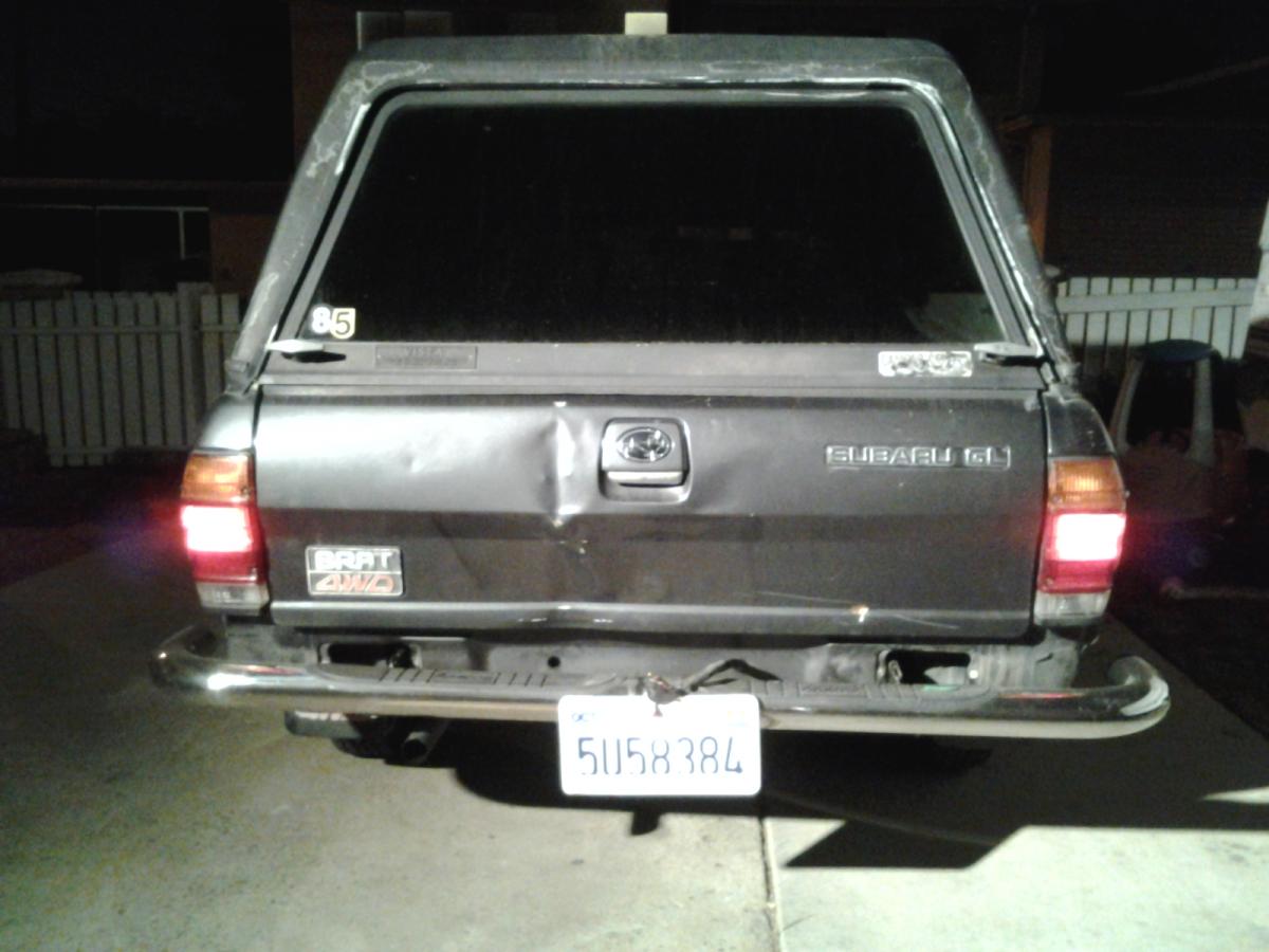

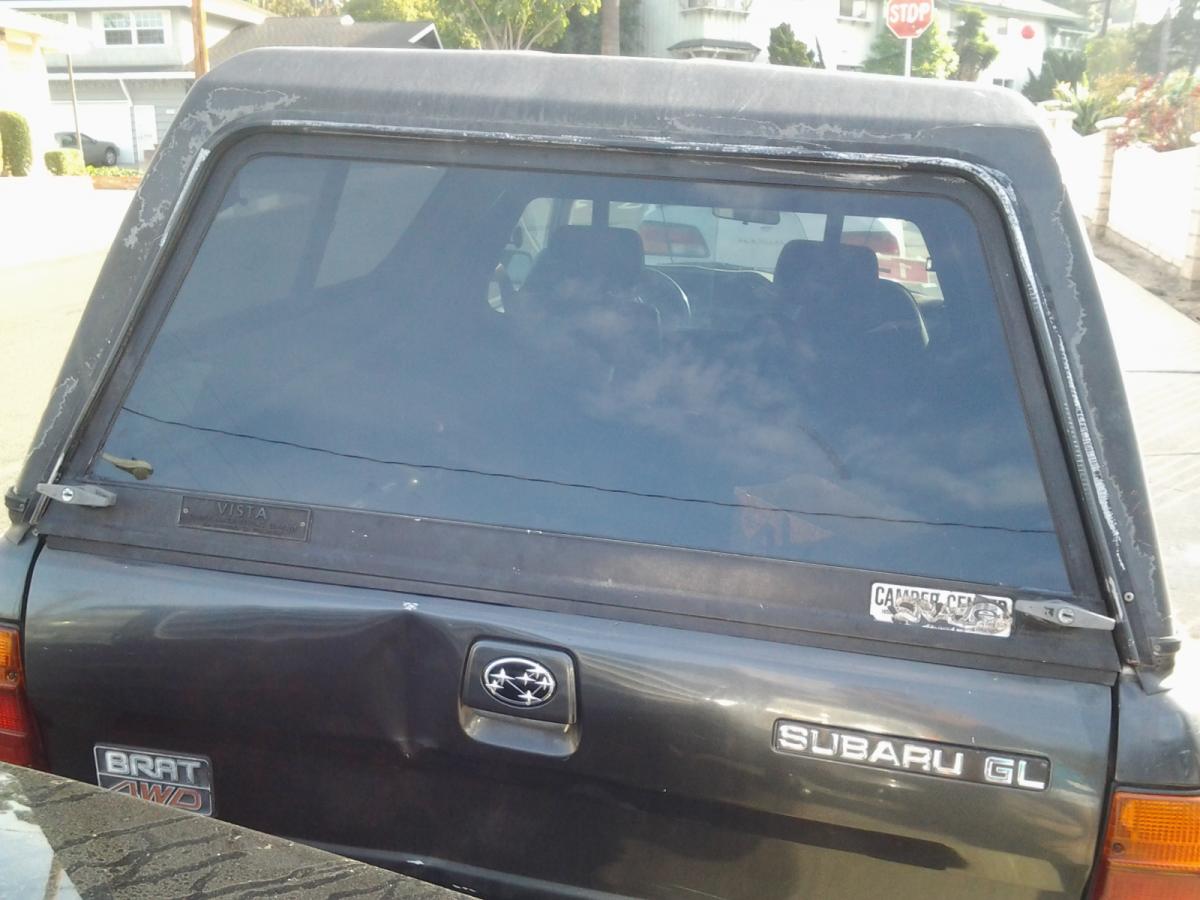

Mundog64 Posted January 28, 2014 Author Share Posted January 28, 2014 An I had a a topper glass installed. Link to comment Share on other sites More sharing options...

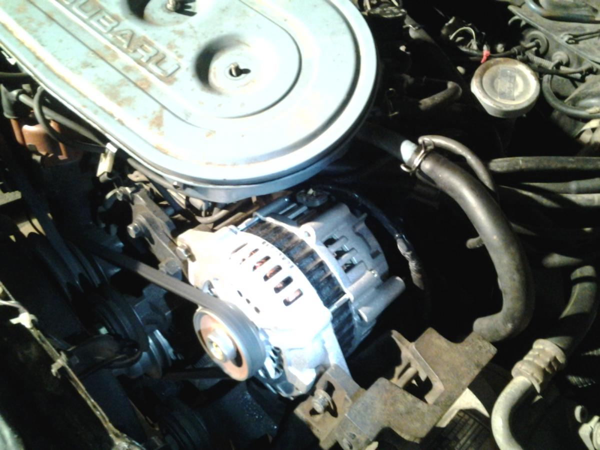

Mundog64 Posted February 21, 2014 Author Share Posted February 21, 2014 My alternator went out on me Monday before last and I limped home on an already weak battery. I was bummed but remembered the upgrade written here on USMB. Heres a picture of my 89 maxima alt. Also had my buddy chop up and weld me up a temporary rear bumper. Its awesome. Link to comment Share on other sites More sharing options...

subyrally Posted February 21, 2014 Share Posted February 21, 2014 nice work on the alternator. cant say the bumper is my style (i dont like chrome) , but i always appreciate good custom work. 1 Link to comment Share on other sites More sharing options...

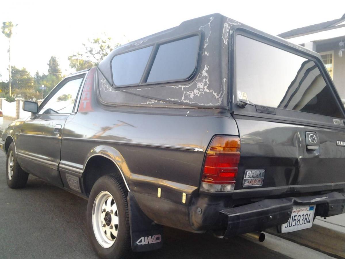

Mundog64 Posted April 4, 2014 Author Share Posted April 4, 2014 (edited) My awesome bumper had to go. Hey, I had a moment. I've been driving it pretty regulary. I had a scraping noise coming from the right rear and thought it might be bearings. It turned out to be worn washers and an easy fix. Edited April 4, 2014 by Mundog64 Link to comment Share on other sites More sharing options...

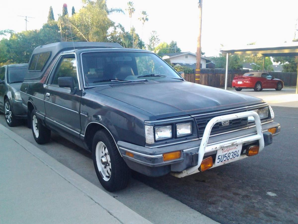

Mundog64 Posted May 21, 2014 Author Share Posted May 21, 2014 My brat needs another head gasket. I put off properly connecting my radiator fan and I paid for it. my fan was spliced in directly to a headlight and it fried a fusable link (red) causing it to shut off. There are bubbles in the radiator and coolent exiting the exaust. Im passed being pissed and just doing the needful by keeping the radiator full. Heres a pic of my favorite angle Link to comment Share on other sites More sharing options...
Mundog64 Posted May 21, 2014 Author Share Posted May 21, 2014 (edited) Heres the Brat Edited May 21, 2014 by Mundog64 Link to comment Share on other sites More sharing options...
