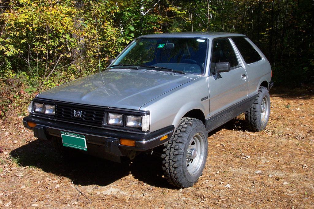

88HatchMonster Posted October 7, 2013 Share Posted October 7, 2013 (edited) Back after many years away... I'm totally nuts for subies again! Thought I'd say hi and show off my ride. 88 Hatchback 4" Lift EJ22 29" TSLs Rear LSD/Discs + Lots More Someday I'll do a build thread... it's been pretty epic. It's been my DD all Summer but is about to be put up for the winter. Chances are it's the last hatch in the state... I'm not taking any chances with the salt. Back in the day this was one of the first (if not the first) EJ hatches in the US. Some may remember I used to sell adapter plates. In more recent news, my girlfriend just bought me an 84 Brat! Planning a nice build/up restore... can't wait to dig into it. Edited October 15, 2013 by 88HatchMonster 1 Link to comment Share on other sites More sharing options...

bratman18 Posted October 7, 2013 Share Posted October 7, 2013 Very nice! I know all about that salt crap. My newest Loyale won't be driven in the winter for that reason. Link to comment Share on other sites More sharing options...
88HatchMonster Posted October 7, 2013 Author Share Posted October 7, 2013 Very nice! I know all about that salt crap. My newest Loyale won't be driven in the winter for that reason. Yeah. It's a shame too cause they really shine in the snow. Link to comment Share on other sites More sharing options...

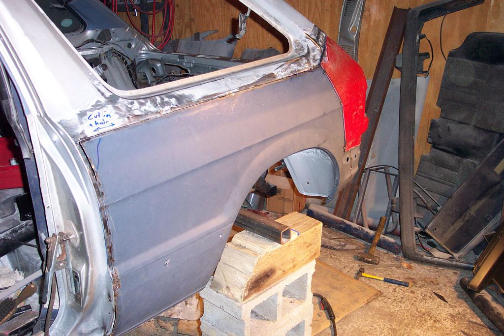

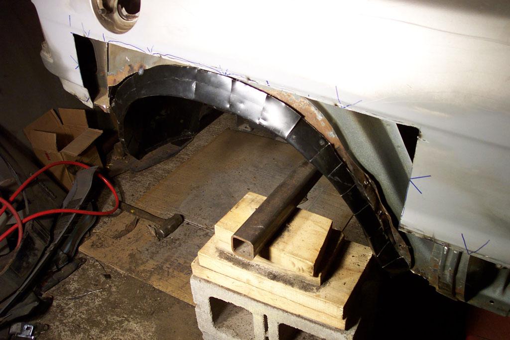

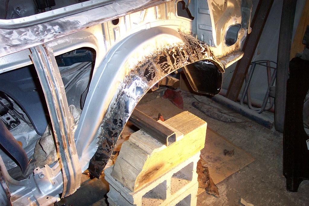

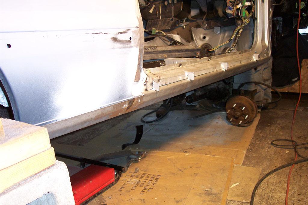

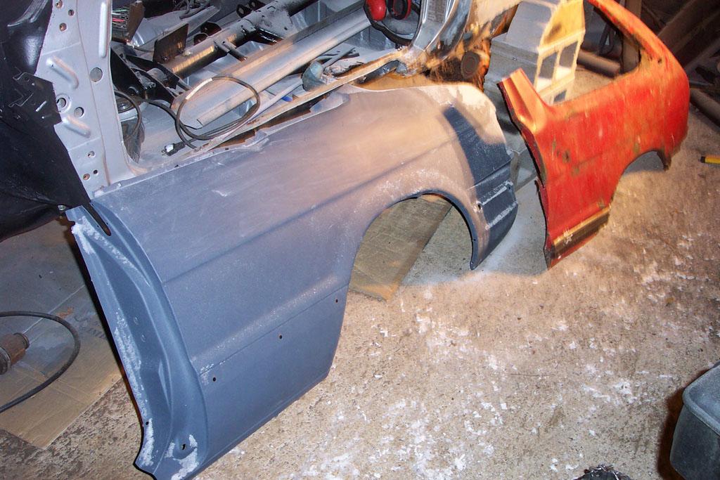

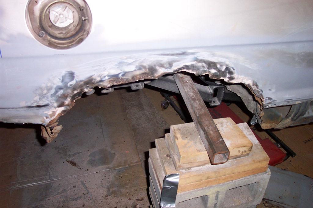

88HatchMonster Posted October 15, 2013 Author Share Posted October 15, 2013 now that is one mighty clean soob. i soo wish brat looked anywhere close to that clean Well it could someday! Your brat has lots of potential. My hatch was rusted, rotted and rolled over when I started... Here are some before and during shots of the build: 2 Link to comment Share on other sites More sharing options...

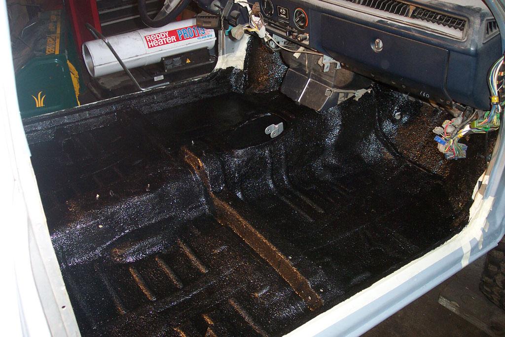

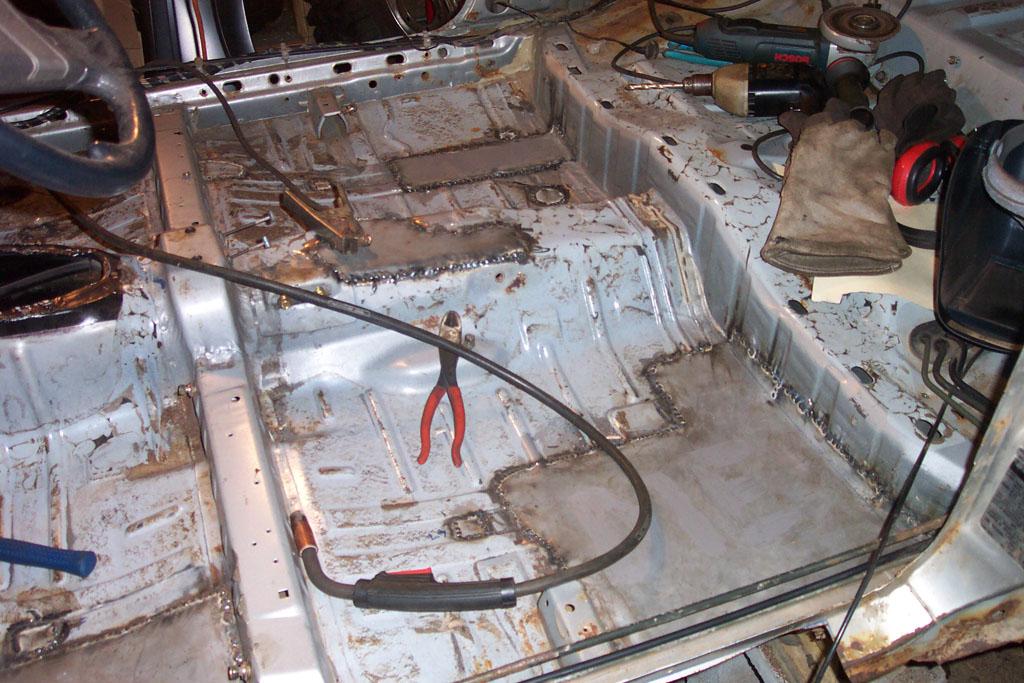

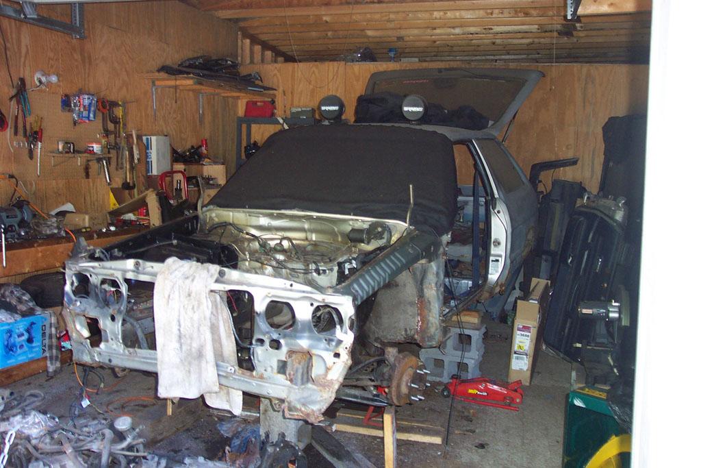

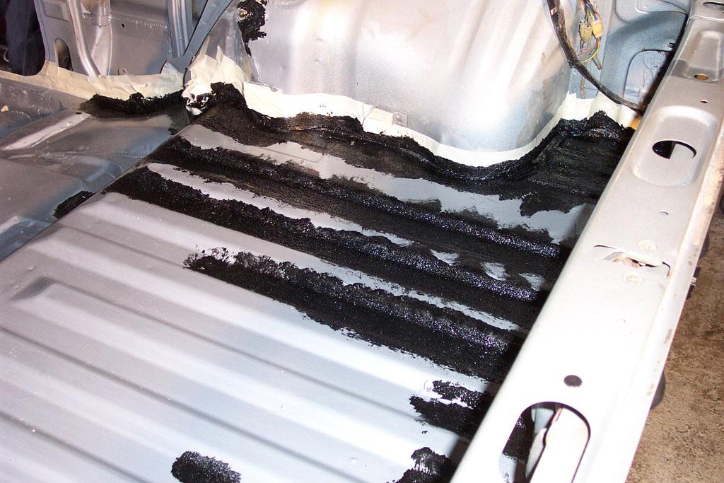

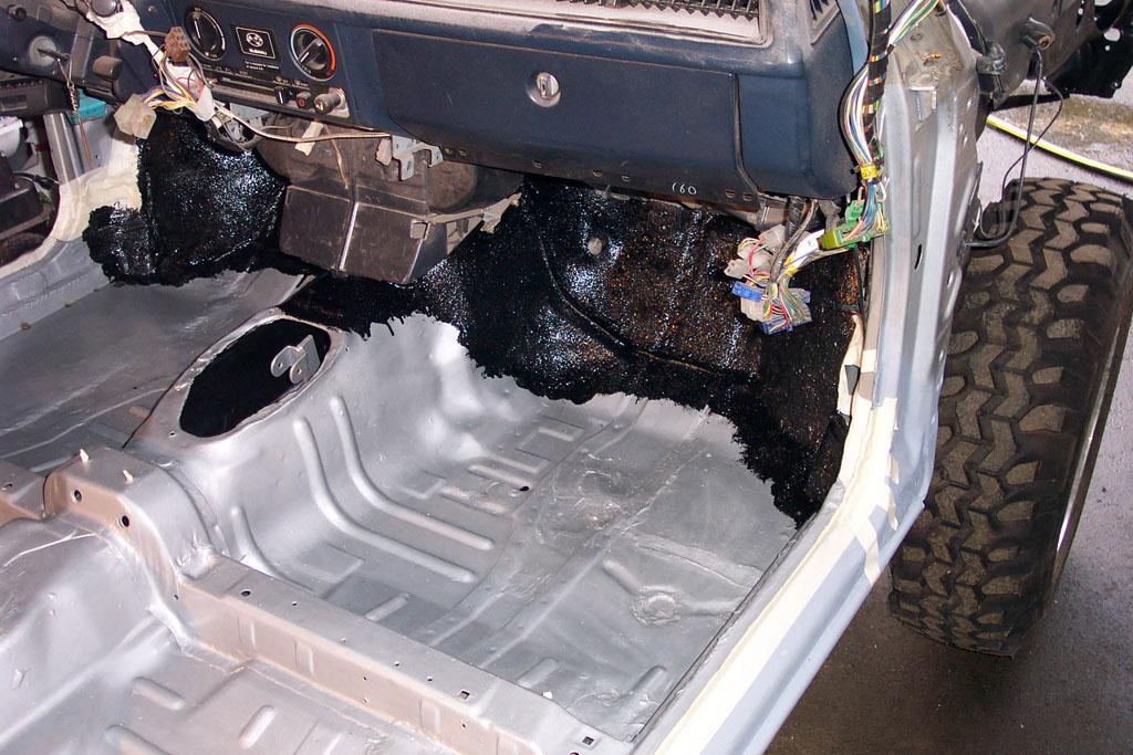

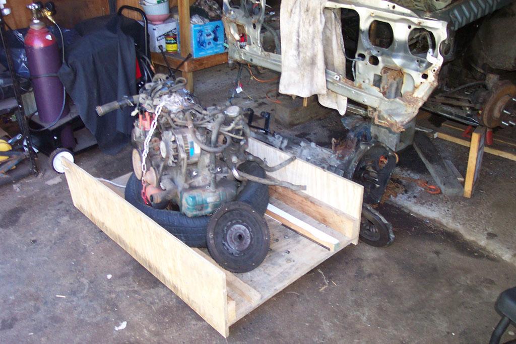

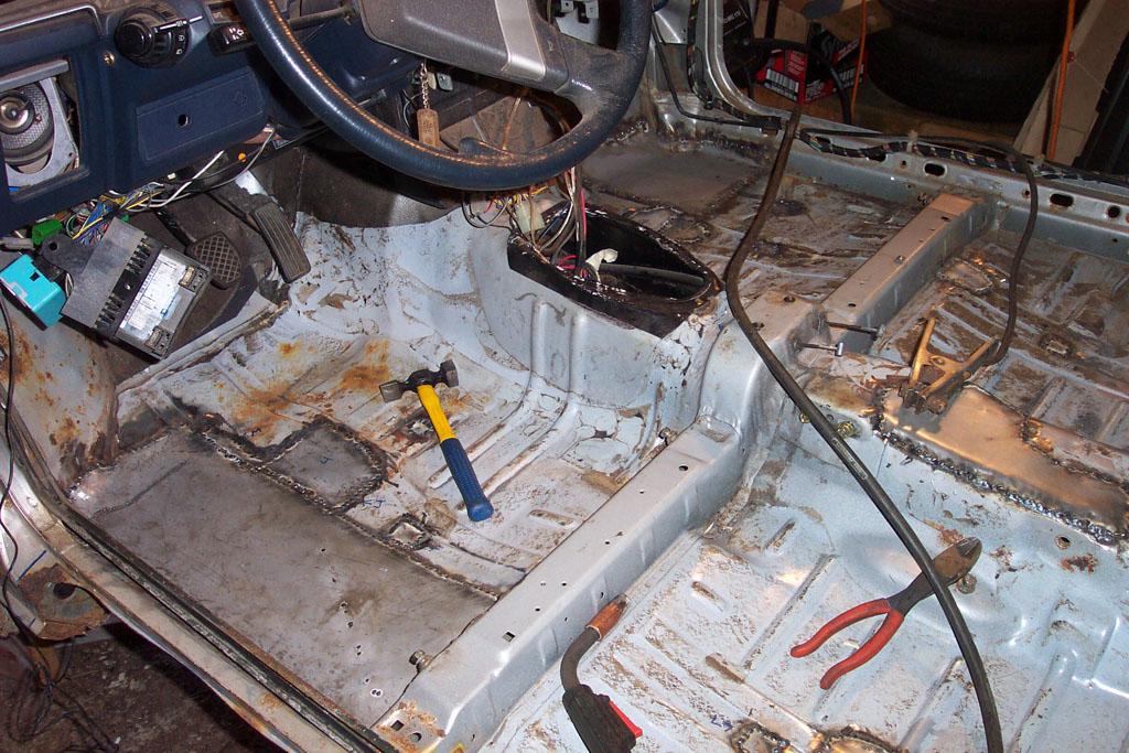

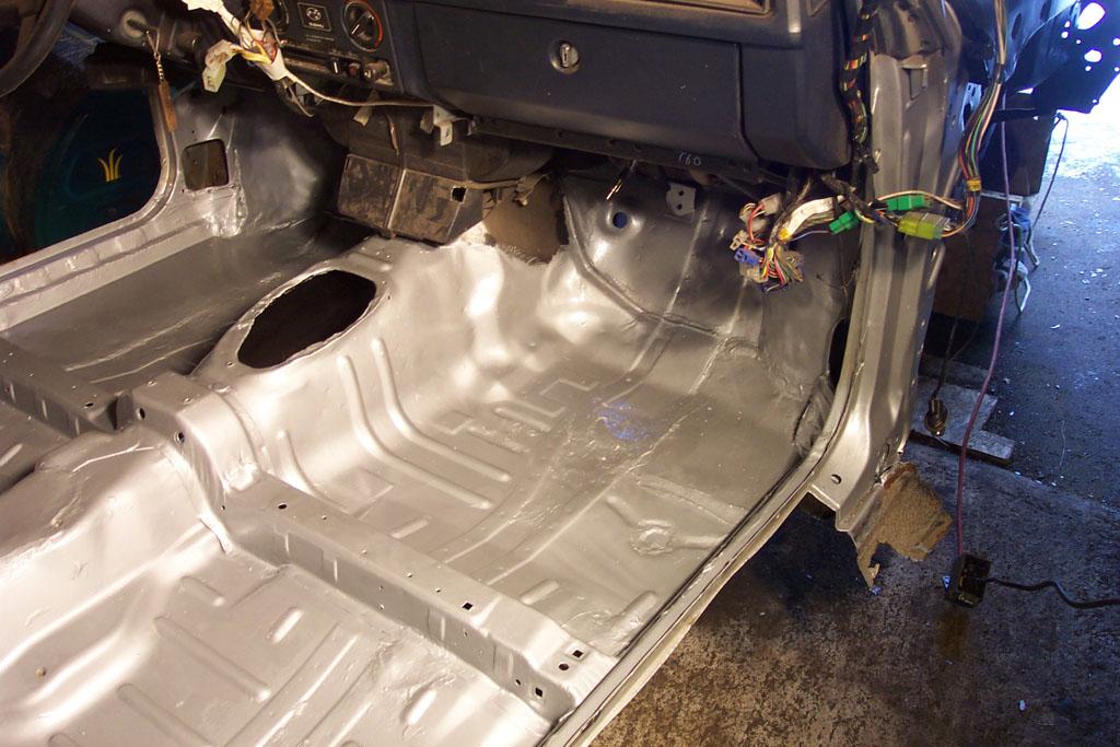

88HatchMonster Posted October 19, 2013 Author Share Posted October 19, 2013 Thanks again! Since everyone seems to be enjoying the pics, I think I'll make it my de facto build thread and roll out a a few pics at a time in semi-chronological order. Oldest digital pic I have: Always-trusty old EA81 pulled: It starts! Floor repair: Floor paint: Bed-liner goes down (this stuff was awesome): That's it for now! Stay-tuned! 1 Link to comment Share on other sites More sharing options...

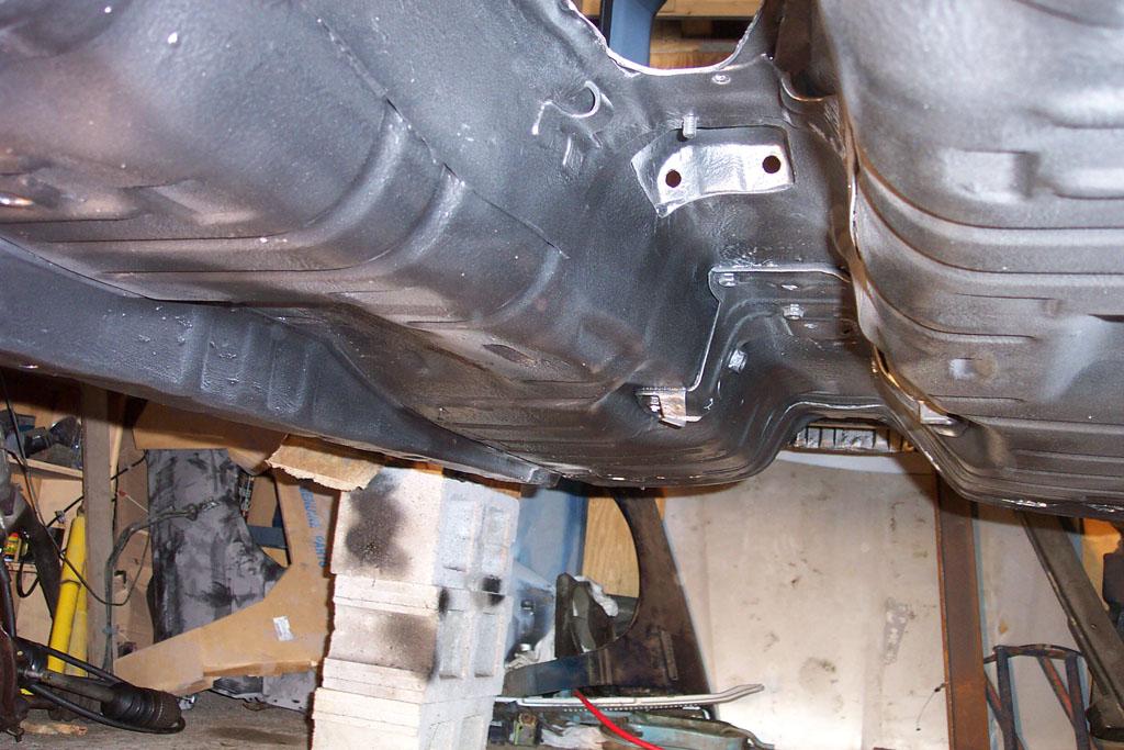

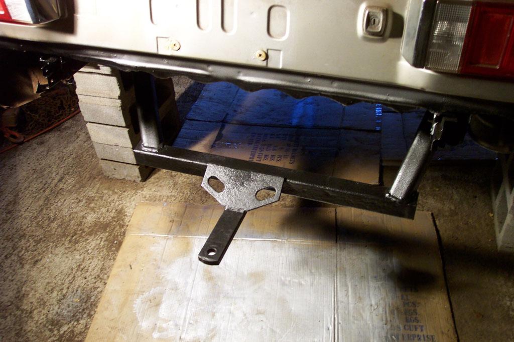

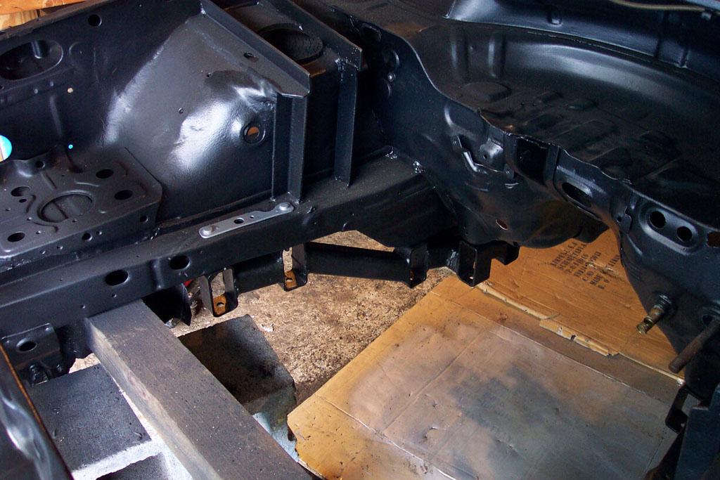

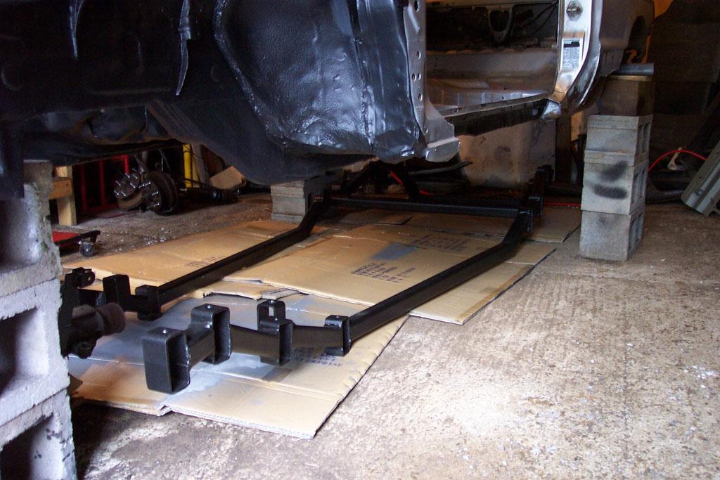

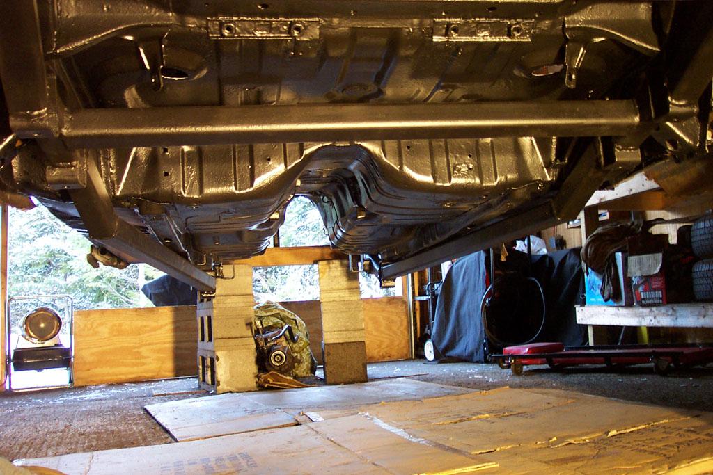

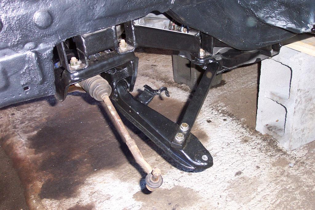

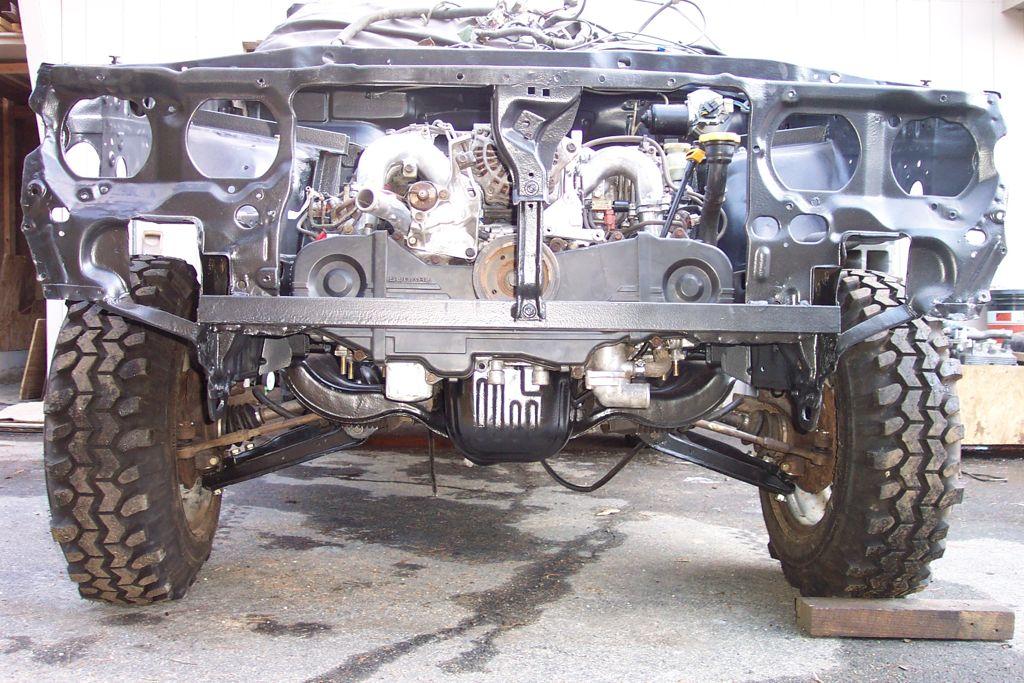

88HatchMonster Posted October 26, 2013 Author Share Posted October 26, 2013 Continuing on! After all rust was removed from the floor and underbody, and new metal welded in, I sealed the seams with Por-15 sealant and painted with Rust Bullet. Then the underbody was sprayed with rubberized undercoating. I built the basic lift kit around 1999 when I was still in high school. I tied the front and back together to make it a frame after I got out of college at least five or six years later. It got a few coats of Por-15 before it was bolted into place. You can see where my inner fenders were bashed in to clear the swampers. Probably goes without saying that this kit is sturdy. Towing capability is awesome with the frame and EJ22. Last shot for now: Link to comment Share on other sites More sharing options...
ferox Posted October 26, 2013 Share Posted October 26, 2013 Yeah more pics! I am planning on doing a frame like that too. I thought I would have to buy a tubing bender for some dom like VaporTrails brat build, but looking at your square tube frame I'm thinking that maybe that would be overkill for my puropses since it's already got a unibody "frame" and I'm not going with solid axles. Square tube would be easier. I think my build just got a lot less expensive and easier...in my mind. Link to comment Share on other sites More sharing options...
88HatchMonster Posted October 26, 2013 Author Share Posted October 26, 2013 (edited) Yeah, I wouldn't worry about building a DOM frame if you are using stock running gear. This frame is by far the strongest thing on the car. I did beef up my stock gear a bit, though. Radius rods were sleeved with 1.25x1.25 square and control arms were reinforced with square tube underneath from the pivot to ball joint then plated over the whole bottom. (wish I had pics of that process) Edited October 26, 2013 by 88HatchMonster 1 Link to comment Share on other sites More sharing options...
