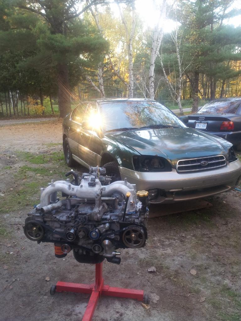

nakedandfam0us Posted October 12, 2013 Share Posted October 12, 2013 Putting a 2002 ej251 out of an impreza m/t into a 2000 outback a/t. Why, oh why, is the timing different between an auto and manual? I have a fsm for a 2000 legacy. FSM: Ignition timing [bTDC/rpm]: MT vehicle: 10°±8°/650 AT vehicle: 15°±8°/700 Also, I was planning to swap the injectors between the two. Looking at the FSM it shows just an o-ring seal for the a/t, an o-ring and insulator for the m/t. Anybody know what that's all about? Thanks! The build is coming along slowly but quite nice. Link to comment Share on other sites More sharing options...
