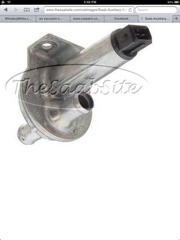

mr sarcastic Posted October 23, 2013 Author Share Posted October 23, 2013 I ended up grabbing an auxiliary air valve from a buddy that's meant for a CIS fuel injected vw rabbit. It's a Bosch unit and is used in many many European cars from the 80's. I linked a picture of what it looks like. Hooked it up in place of the unit on top of the thermostat housing, and it seems to work great. Cold it's open, and after it gets 12v the bimetal strip slowly shuts it and the idle drops. The wire plugs in, no need to rewire. I tested the lead and it gets 12v until the CTS tells it that the car is warmed up, then engine heat will control the opening. The engine definitely starts nicer and idles better, but its not perfect. I'm still on fuel that's over a year old and the I haven't gotten everything I need for a full tune up. I'll keep you guys posted on how it pans out. 1 Link to comment Share on other sites More sharing options...

Gloyale Posted October 27, 2013 Share Posted October 27, 2013 That is actually almost the same part as the AAV used on XT models with the Spider manifold. 1 Link to comment Share on other sites More sharing options...
