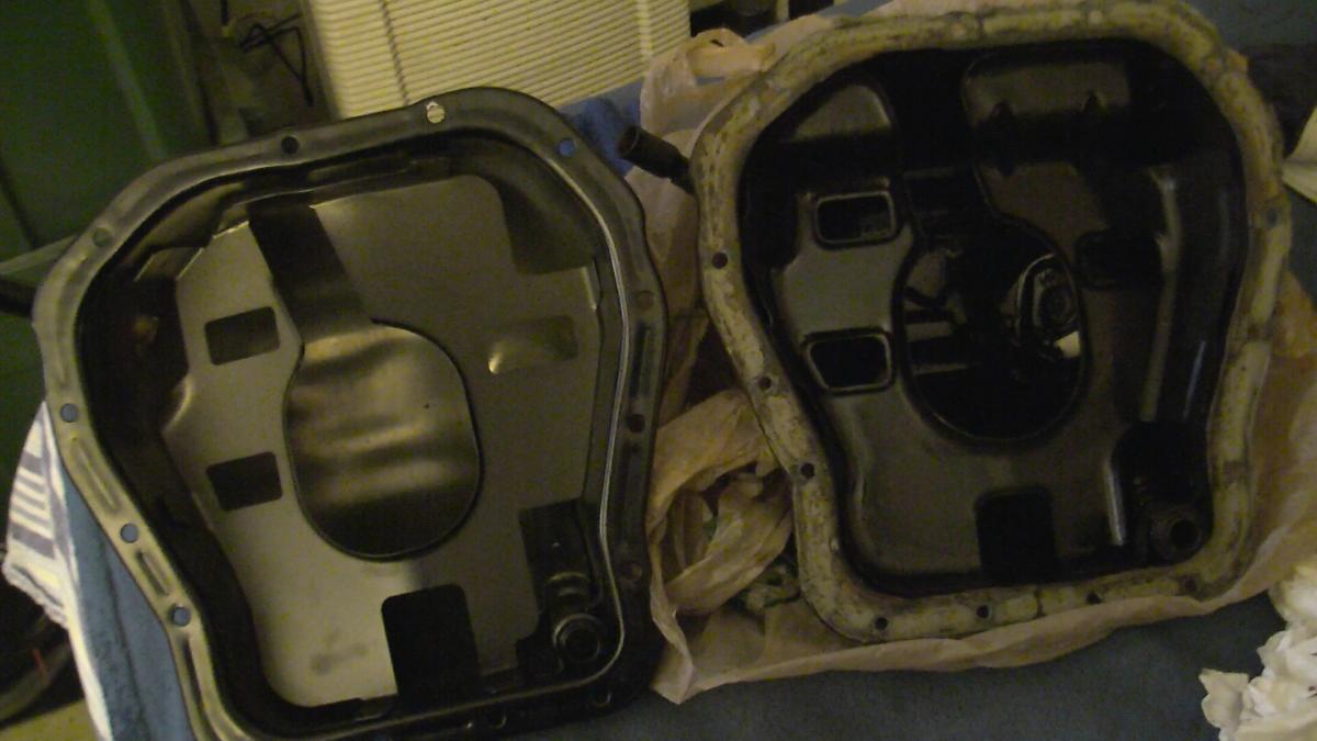

1-3-2-4 Posted November 28, 2013 Author Share Posted November 28, 2013 (edited) Got the pan off, the screws are fine, oil pickup had a lot of things stuck on it more so then I've seen in other peoples pictures.. In my replacement pan it comes with a gasket for the oil return but it comes with two smaller gaskets which I can't figure out where they go.. I thought they would of been where the oil pickup goes with those two screws. Does that gasket on the oil pickup tube need to be replaced? Edited November 28, 2013 by 1-3-2-4 Link to comment Share on other sites More sharing options...
idosubaru Posted November 29, 2013 Share Posted November 29, 2013 oil pick up tube gasket should definitely be replaced. Link to comment Share on other sites More sharing options...
