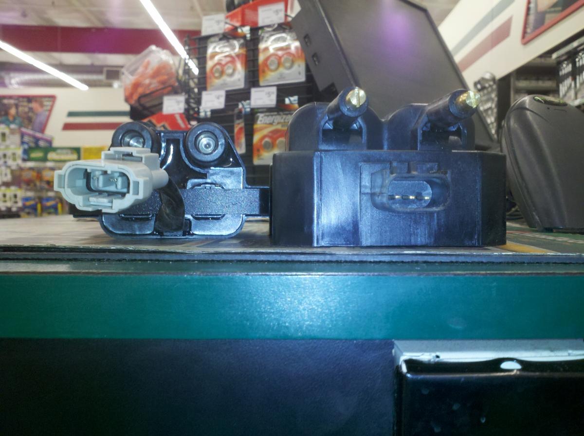

apintonut Posted January 26, 2014 Share Posted January 26, 2014 (edited) How about race fuel and a BIG coil and hot plugs (accel yellow coil 65$) i think he was just looking for more toque at idle or just above Sorry forgot he has 2.2 will need to get an ACCEL super coil for a ~98 dodge neon Some pics of stock coils side by side but you would want accel part # 140027 Edited January 26, 2014 by apintonut Link to comment Share on other sites More sharing options...
