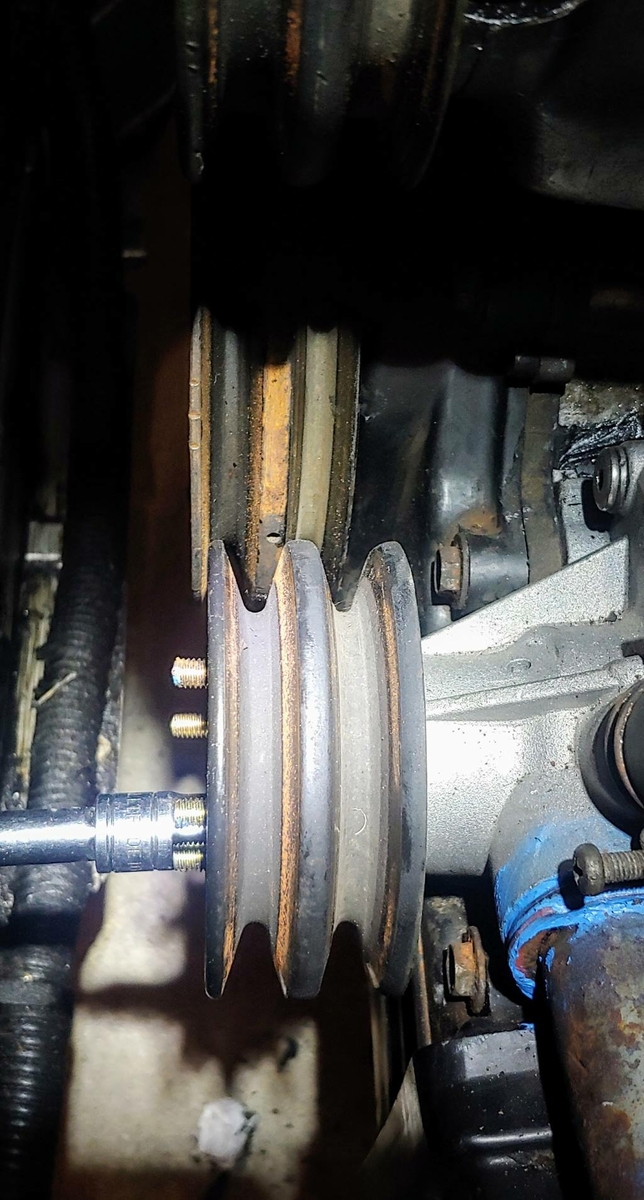

Craigar Posted August 18 Share Posted August 18 (edited) **** EDIT 8/16/2024 2am I measured this water pump and it is 110mm hub height, as stated @ Rock Auto. *** so it's not what my problem is, in fact a solution would be to pull/move this hub 5mm higher/forward for the it's pulley to align with the crank pulley .. So there might not be much value in the rest of this post except for the reference images showing the difference between the hub positions of the 110mm and the 105mm.. ========= Grrr, I bought what is supposed to be a "Dayco DP1081 Info Lobed Hub, Hub Height Approximately 4.320" +/- .020"; V-Belt Driven 110mm hub/deck height" from rockauto - and all 4 of their offerings are supposed to be 110mm ... Tomorrow all try to go over to where the car is and measure it.... like I should have the day it arrived.. BUT their pictures of the ones with 105MM hub height LOOKS LIKE THE HUB IS WAY FURTHER DOWN on the SHAFT.. So the one they sent me probably is a 110mm . https://www.rockauto.com/en/catalog/subaru,1994,loyale,1.8l+h4,1270178,cooling+system,water+pump,2208 and putting it all back together, installed radiator and put on my thin pulley (Hitachi inboard AC, non tubo) and it's sitting about 5 mm too close to the pump and doesn't line up with crankshaft pulley. Dayco DP1081 Info Lobed Hub, Hub Height Approximately 4.320" +/- .020"; V-Belt Driven below are a couple of images of Rock autos 105MM hub height (from 1988 GL) LOOKS LIKE THE HUB IS WAY FURTHER DOWN on the SHAFT?. https://www.rockauto.com/en/catalog/subaru,1988,gl,1.8l+h4,1268513,cooling+system,water+pump,2208 so maybe my crankshaft pulley is sitting too high or something weird - or maybe it's been this way ever since I bought the car in 2017 - OR I messed somthing up and flipped a crancksaft sprocket when I did the timing belts & water pump in 2019. My crankshaft pulley is pressing right up against the timing belt sprocket and is held on with one big bolt (no washer) torqued to 140 ft/lbs. BUT my timing belt sprocket on the crankshaft does seem to be sticking out bout his far from the end of the crankshaft. this is when I was doing the timing belts in 2019 so maybe I got crankshaft timing belt sprockets reversed or flipped - and it DOES look like they are sticking out about 5mm beyond the end of the crank? Backside of crankshaft pulley 20240809 Here's another great "zen art of Subaru maintenance" showing him pulling of these sprockets/gears.. both his "protection disks" are facing the crank https://youtu.be/QCnmC2gZahs?t=231 I'm pondering that I must have put the crankshaft timing belt sprockets in backwards when I did the timing belts & water pump in 2018 ... I noticed the gunked dried oil "teeth/notch marks" on the landing in the first pic below .. and in the 2nd pic the teeth are facing the crank's landing (it's probably wrong), in my pics above the "protection disk" that prevents the belt from coming off is facing the landing (on the crank) and that looks correct - but maybe each one is different and I stacked them backwards? this was probably the wrong way... and it was NOT reassembled (with teeth facing the engine) this way. otherwise I guess I need the THICK pulley, or maybe a short gear puller that can pull the hub forward and work just by pulling the radiator back out (to have enough room for woking the gear puller)? I've read about using washers and wish there was some kind of a single part spacer... I can't find this thick pulley here or digging around on the web.... I DON'T want to R & R this water pump. Thank you all Edited August 19 by Craigar more details .. and discovery Quote Link to comment Share on other sites More sharing options...
Steptoe's photos Posted August 19 Share Posted August 19 (edited) Do you remember what I wrote somewhere in one of the other water pump posts? Same poo happened to me, with my Rock order, an advertised imperial measurement listing, converts roughly to metric 110mm, came as an -s on the part number, turned out to be the 105mm variety. I got in before the return date and got a 99% refund from them. I got the same uhuh? moment when my pulleys "lined" up just the same as your photos. Down under, we have metal supply shops with round discs for sale, to be used for whatever - plugging ends of pipes, weld in, weld on style etc. 5mm thick flat steel, punched out at 57mm The 57mm fits perfectly inside the water pump pulley of the V belt style, pressed steel pulley. I set about marking out the centre hole and four holes for the mounting bolts/studs. Job done, a 5mm spacer makes a 105mm pump into a 110mm deck height pump. I bet you are outside your return date, due to your ill health before. The one thing that irked me more than having to fix someones muck-up was the diameter of the shaft of the new Dayco pump differed from that of the old brand unknown pump ( still about - I could go out and look) When I made my spacer, I measured the old pump shaft diameter assuming it would be the same as the new. It was not. New pump shaft dia was a bit less, and so a bit sloppy on the pulleys hole and the hole in my spacer. The set up I had, did not really have enough length on new pump shaft outside the flange to get 5mm spacer and 2mm of pulley to actually sit nice on the shaft ... Edited August 19 by Steptoe's photos Quote Link to comment Share on other sites More sharing options...

Craigar Posted August 21 Share Posted August 21 Steptoe's, since my problem is not the stock water pump height I'm staring a new topic hopefully to help others with this kind of a problem (and help my patience and sanity) and will paste in your good ideas.. I've painfully learned more - but luckily not *the hard way* so far https://www.ultimatesubaru.org/forum/topic/185922-shimming-water-pump-pulley-to-align-with-crankshaft-pulley-only-need-3-5-mm/ Thanks Craig 1 Quote Link to comment Share on other sites More sharing options...
