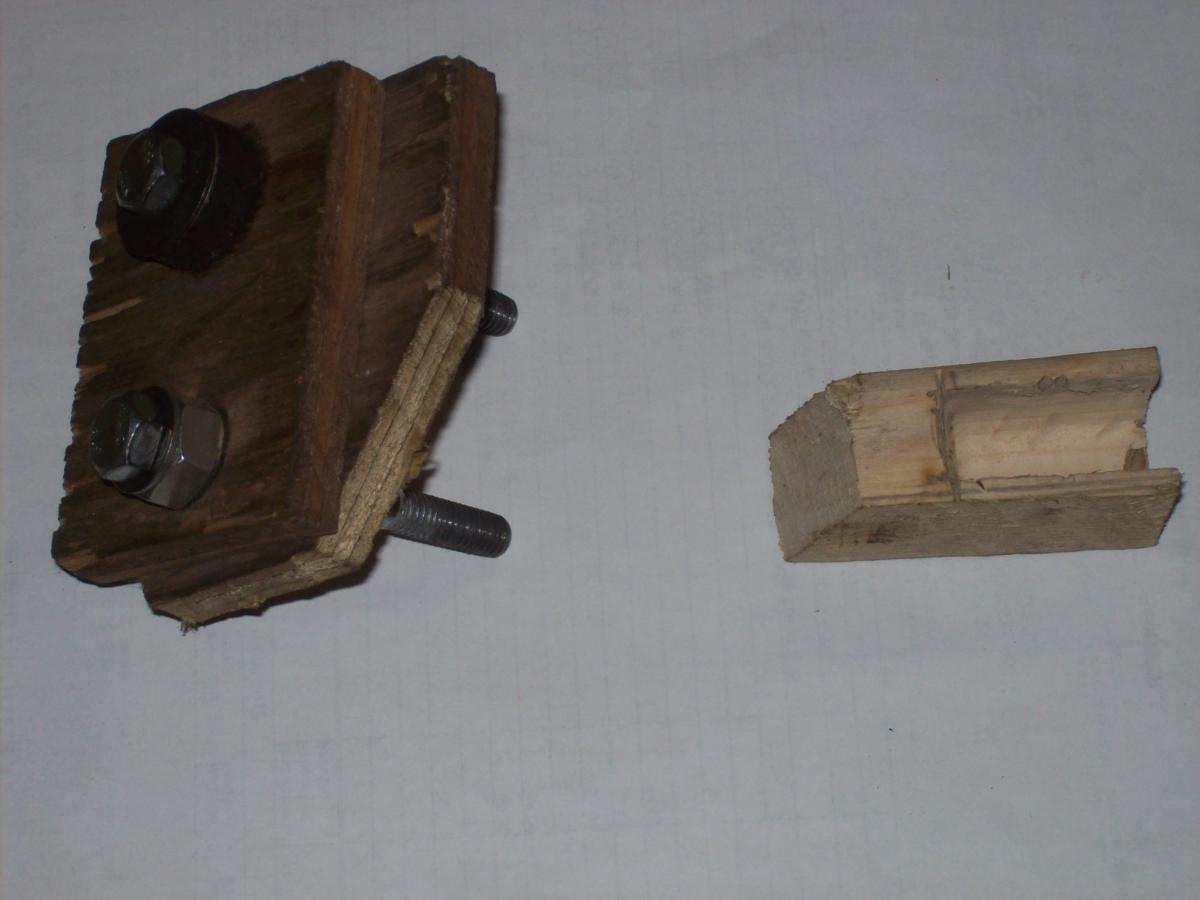

ocei77 Posted November 17, 2013 Share Posted November 17, 2013 (edited) Hemostats. Work extremely well. They have small tips and they lock. Keep your magnetic pickup tool handy. There are two I know of made especially for Subys. Here's link to one. The other is $85 http://www.euroexportinc.com/subaru-valve-spring-compressor-tool Since I don't have a shop or do them regularly. I "made" a tool for my uses. I use a c clamp to compress springs with this homemade item O. Edited November 17, 2013 by ocei77 Link to comment Share on other sites More sharing options...
