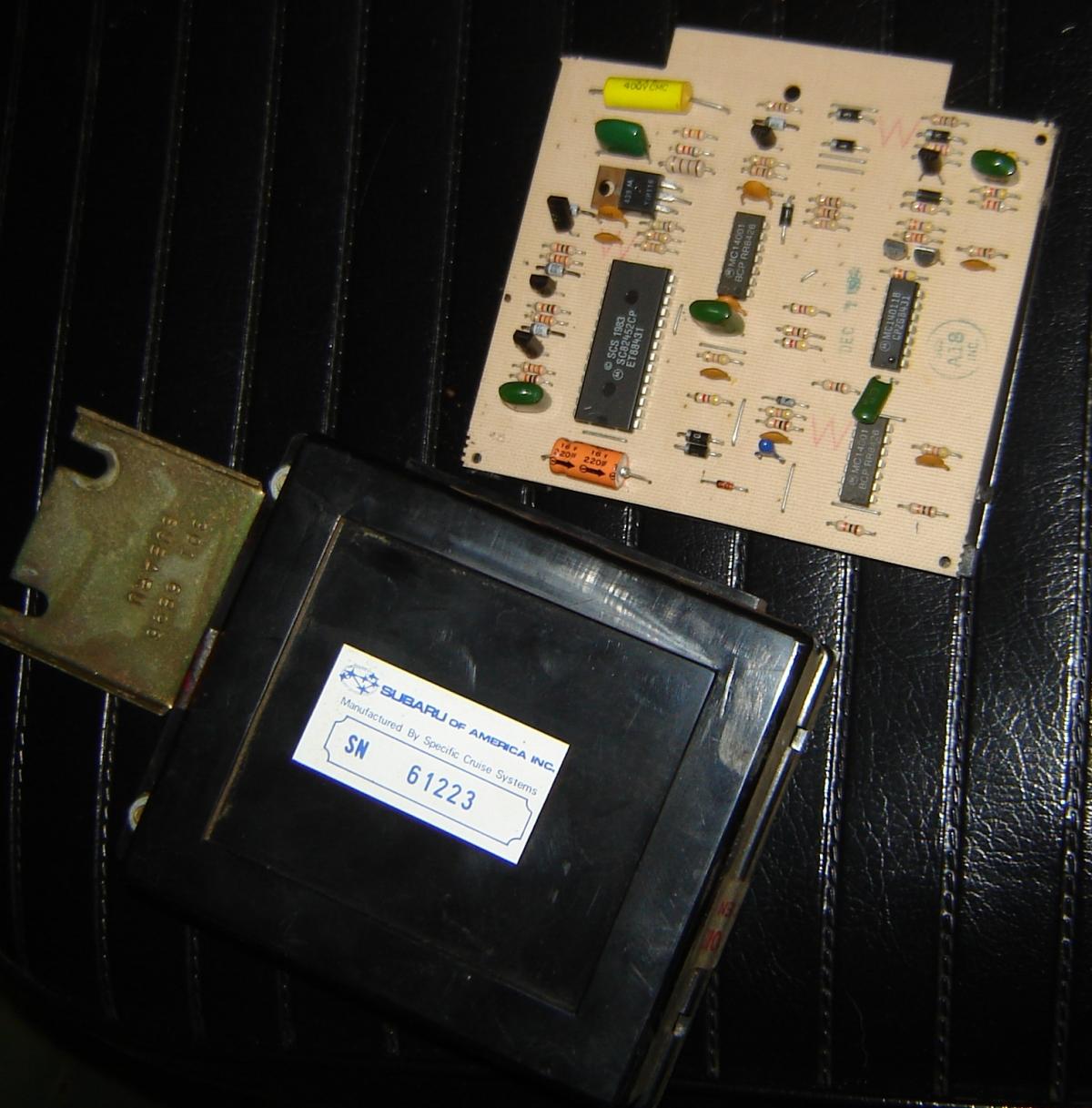

Gloyale Posted December 5, 2013 Share Posted December 5, 2013 I am looking at 4 relays all have 4 wires -none of these? Does it look different? (borrowed pic) I can't seem to find ant other relays up in there -I am upside down with the guts out of this thing None of those. Those are the 2 headlight relays, The blower relay, and the Defrost relay. The Fuel pump controller is not like a regular "relay" it's bigger about the size of deck of cards. And it is mounted Directly above the hood latch pull. It's actually bolted in underneath the hood latch pull. Loosen the bolt, and it slips out from under for better access. Link to comment Share on other sites More sharing options...
rrgrr Posted December 5, 2013 Author Share Posted December 5, 2013 This circuit board turd? Okay, Sorry -I guess nothing about that says 'relay' to me. Takes like 14 wire harness...I guess my warranty is void now. Thanks for clarifying that! Link to comment Share on other sites More sharing options...
