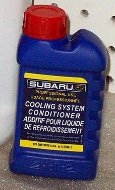

suprjohn Posted December 3, 2013 Share Posted December 3, 2013 (edited) Hey All, i just purchased this on ebay for my '89 DL wagon: http://www.ebay.com/itm/271331659501?ru=http%3A%2F%2Fwww.ebay.com%2Fsch%2Fi.html%3F_sacat%3D0%26_from%3DR40%26_nkw%3D271331659501%26_rdc%3D1 does anyone have any experience regarding this product? i thought it couldn't hurt...i really don't want to pull my engine to fix a head gasket... john Edited December 3, 2013 by suprjohn 1 Link to comment Share on other sites More sharing options...
idosubaru Posted December 3, 2013 Share Posted December 3, 2013 (edited) What is your EA82T doing?That Conditioner was made for one specific application - Phase II EJ25 external coolant leaks (2000+ EJ25's and 99 Forester and Impreza RS). It doesn't work on Phase I EJ25's at all. Unlikely to help an EA engine. If your EA82T has an external coolant leak similar to EJ25's then maybe it's worth a shot. But they usually blow much worse than that and I've only ever seen one externally leaking older generation headgasket. May be risky considering the cooling systems differ. If "repairs in a bottle" work, it's usually a limited time frame - which often means more overheating episodes which do bad things to the lower end block which won't be repairable..well not without massive expense. Blue Devil gets touted a lot for folks wanting quick fixes, but I don't recommend it. Edited December 3, 2013 by grossgary Link to comment Share on other sites More sharing options...
81EA81 Posted December 3, 2013 Share Posted December 3, 2013 A quick google search should provide you with adequate information about the product. You would think it would help to know what you are buying before you order it. I personally have never used the Subaru cooling system conditioner, I do know however it is simply a rebranded Holts product. It is added to improve cooling efficiency,lower PH levels and stop/clog minor coolant leaks. If you feel you need head gaskets this product will likely not help. What are your Subaru's symptoms? Link to comment Share on other sites More sharing options...

suprjohn Posted December 4, 2013 Author Share Posted December 4, 2013 well, i don't really have any issues with the head gaskets that i know of; no white smoke, no overheating, no milky oil etc. really, i was just looking at it as a preventative maintenance thing...it won't hurt to use it will it? i just replaced basically the entire cooling system (new rad, new hoses, new water pump, new thermostat). not to get off topic, but grossgary's comment reminded me of something i've been curious about; how do i identify which engine my DL has? forgive me, i'm new to subarus... thanks for the replies! john Link to comment Share on other sites More sharing options...
idosubaru Posted December 4, 2013 Share Posted December 4, 2013 an 89 wagon is an EA82 engine. they don't have headgasket issues. don't let it run hot and the gaskets will last as long as you keep the vehicle probably. EA82's are great motors if you like cheap, reliable, and easy to work on. new coolant (which new hoses and such require) is excellent preventative maintenance. good job! 1 Link to comment Share on other sites More sharing options...
ivans imports Posted December 4, 2013 Share Posted December 4, 2013 Throw it right in the trash rad pluger seal eater heater pluger have seen no good from this product. Was A dealer attempt to get the cars off warranty before head gaskets failed. 1 Link to comment Share on other sites More sharing options...
nipper Posted December 4, 2013 Share Posted December 4, 2013 Since you rebuilt your cooling system (you skipped a new cap) you don't need it, especially for this car. The biggest issue with these cars today is the radiators falling apart from old age, and you solved that. Link to comment Share on other sites More sharing options...
suprjohn Posted December 4, 2013 Author Share Posted December 4, 2013 thanks guys! should have checked here first. oh, well. didnt cost too much. oh, i did replace the cap. i figured as long as i had it torn apart, i might as well do it all. john Link to comment Share on other sites More sharing options...

maozebong Posted December 5, 2013 Share Posted December 5, 2013 we sell that crap in my shop.... i usually add it, but strain out the little white pills inside of sealer with a pocketknife. 1 Link to comment Share on other sites More sharing options...
