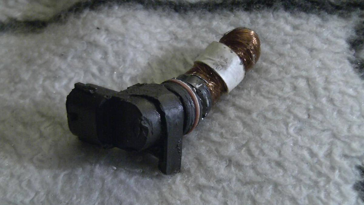

This is odd.. Not sure to me it seems like the crank sensor is broken, but I tried to remove my crank sensor out of a Ej22 oil pump and it's like I can rotate the sensor but the part that near the crank sprocket it does not move, I'm almost positive that this whole area should be a hole for the sensor?
Wow it's not moving.. guess I'm going to have to drill it out or hammer now that I got the top part off..
Jesus.. heat, kroil and hammering it was in pretty good!
Man that corrosion was the worst I've ever seen, finally got it out at least.
