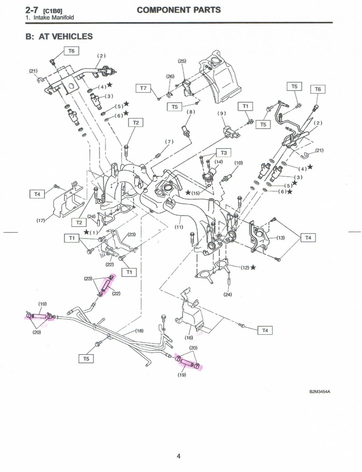

1197sts Posted December 12, 2013 Author Share Posted December 12, 2013 Caboobaroo, Just wanted to make sure, I found 3 fuel hoses with clamps in the intake manifold area, are those the ones? I am assuming this is ordinary fuel line hose, not a dealer part? I also saw 2 larger diameter hoses that don't have clamps, I am thinking these are evap or return lines? Do these have leak issues also? Thanks. Link to comment Share on other sites More sharing options...
Caboobaroo Posted December 14, 2013 Share Posted December 14, 2013 You are correct on both. The three hoses are the fuel lines and the others are for the Evap system. No need to mess with the Evap lines, just check the fuel line clamps for tightness. Every car I do a new fuel filter on, I usually try and hit as many of those clamps as I can to help prevent it from happening. Link to comment Share on other sites More sharing options...

1197sts Posted December 17, 2013 Author Share Posted December 17, 2013 I have attached a page from the maintenance manual, items 19 and 22 are the fuel hoses (Auto Trans version). The illustration does not show it realistically, the lines are burried between the manifold and the block. I got a screwdriver on 4 of 6 clamps and it did seem to fix the problem. I really wont know for sure until it get really cold again, as that is when it was the most noticeable. Sorry for the delayed response. Link to comment Share on other sites More sharing options...
