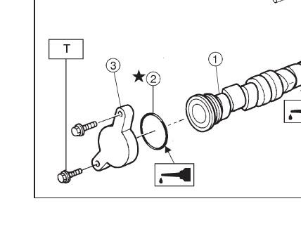

turboguzzi Posted December 11, 2013 Share Posted December 11, 2013 mmm.... cant find this area in opposed forces online microfiches.... this shot is taken form the worskshop manual anyone knows the part number for o-ring number 2? + any links to more complete microfiches would be welcome Grazie mille TG 95 2.0 leg SW Quote Link to comment Share on other sites More sharing options...
idosubaru Posted December 11, 2013 Share Posted December 11, 2013 call Subaru, that's a very common oring to replace. i'm thinking it's the same oring as the two front cam cap orings as well for US 2.2 engines. Quote Link to comment Share on other sites More sharing options...
Fairtax4me Posted December 11, 2013 Share Posted December 11, 2013 http://opposedforces.com/parts/legacy/us_b11/type_5/engine/camshaft_and_timing_belt/illustration_1/ Under engine/ camshaft and timing belt 806946030 Same part as the one behind the cam support on the RH side. Get 2 and you'll have it on hand when/if you do the Timing belt. Quote Link to comment Share on other sites More sharing options...
