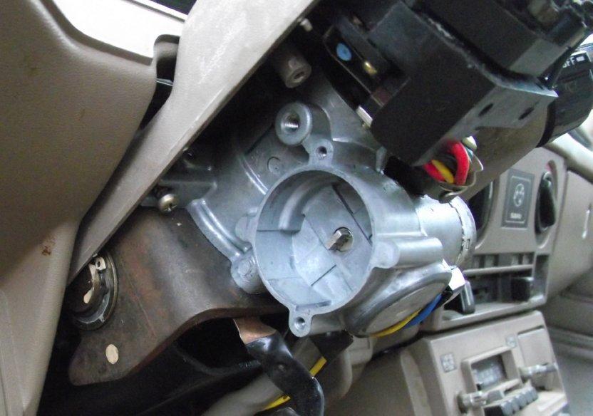

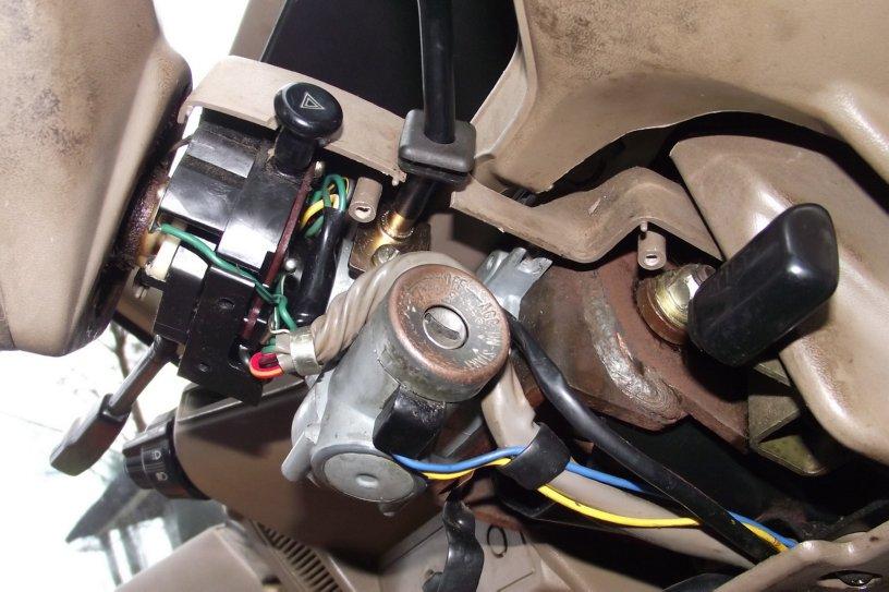

chuckl10101 Posted December 21, 2013 Share Posted December 21, 2013 Hi Folks: I am in need of an igntion key switch for my 1983 Subaru GL wagon. I have been starting the car by putting a flathead screwdiver, and cranking it that way. I'm attaching a cpl pics so you know the exact part I need. It MUST have a key (for obvious reasons). I think what has happened is that the notches on the key itself are just so worn down that the key will NOT turn to crank the car unless I jiggle the key, and that's no fun. Besides that, where I live here in Alabama, the cops have roadblocks all the time, and if the cops see that one part of the switch, where the three wires are soldered on in the pic, they might think I stole the car even though I have the tag reciept, title, and insurance in my name. Thanks a LOT if you have a key, or maybe know how I can fix the problem. And since I am VERY new to the site, and haven't yet figured out how to "follow" all the thread etc, you can email me at chuckalexander@centurylink.net If that (posting my email addy) is against the rules, I apologize in advance. Chuck Alexander Link to comment Share on other sites More sharing options...
jonas Posted December 22, 2013 Share Posted December 22, 2013 Good luck. Good working early ignition switches are hard to come by. You could remove the barrel from the housing and pull the little horseshoe shaped tumblers from the barrel, but then any key will start the car. Not much different than any screwdriver being able to start it. Link to comment Share on other sites More sharing options...

jonas Posted December 23, 2013 Share Posted December 23, 2013 Nice one on the duster hehe! Ok, disconnect the battery.pull the cover off the barrel, the piece with the on/off/acc stamped on it. It's crimped on so it's not hard to get off. slide out that black plastic piece on the bottom of the barrel. not sure if you can get it off at this point or you have to wait till the barrel is out, it's been awhile since i've done this. now, looking at the switch head on, at about the 5 o'clock position there will be a tiny screw (maybe not, i've heard some don't have it.) holding the barrel in. it may be covered up by a piece of solder or something like that. it is pretty easy to get out with some digging at it, at least mine was. once you remove the screw you should be able to insert your key and pull the barrel out. there might be a black plastic half circle(?) piece in front of the barrel you will need to remove. once you get the barrel out you will see the little spring loaded horse shoe shaped tumblers you need to pull out. once you have the thing apart it will make sense as to what i'm talking about. they are really simple. Link to comment Share on other sites More sharing options...

ruparts Posted December 23, 2013 Share Posted December 23, 2013 (edited) hi, good description on doing this jonas ! however i have done this many times , never had a screw to work with.. all of them i've seen had a tiny pin , pressed in and required that you drill a notch and use some pick tool to remove it. i'll bet the one you had was worked on before and another person put that screw in it to make life easy next time, when you did it. anyway the overall description of the process is very good and is something most of us can handle,, 2 thumbs up ! by the way, that one for sale is waaay different form the one in question and " WILL NOT" fit this application. Edited December 23, 2013 by ruparts Link to comment Share on other sites More sharing options...
