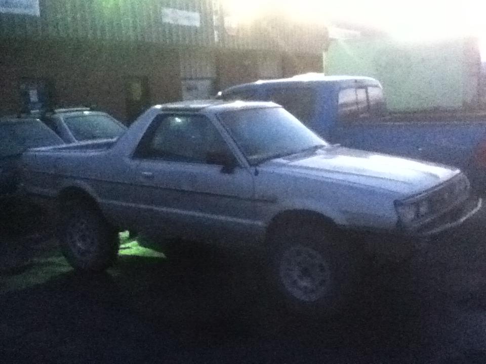

SubieBrat Posted January 1, 2014 Share Posted January 1, 2014 Bought this Brat on Sunday in Worland, Wyoming. 4/5 lift, 15 inch pugs, jump seats have been added. A little hail damage, and a bit of surface rust. My plan: Ej Frankenmotor swap 5 speed d/r rear disks possibly add power steering Fix surface rust paint white with black bottom White one currently has the frankenmotor and tranny but is extremely rusty Link to comment Share on other sites More sharing options...
BratRod Posted January 1, 2014 Share Posted January 1, 2014 Nice! I think I remember seeing this on CL. It was a great deal, from what I remember. The camber issue should be nothing more than the strut blocks in backwards, as suggested by others who saw it. Nice looking bumper. Looking forward to updates. Link to comment Share on other sites More sharing options...
SubieBrat Posted January 1, 2014 Author Share Posted January 1, 2014 Yeah it was the one in worland. I rotated the blocks 180 degree and it fixed it. Virtually rust free. I was very supprised with body. Link to comment Share on other sites More sharing options...
